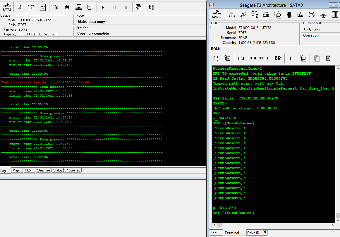

Hi! :mrgreen:
No unlock terminal. No support pc3k! :shock:
after a few seconds it gets busy and i can't copy the data. Any solution ?
Please look print screen! Log terminal.

It is a SSHD and not currently supported by ACE. With the remote assistance of another, I was able to recover one with NAND/MC issues yesterday.

Here is a link to the website of the guy who is able to assist with these remotely.
https://www.hardmaster.info/eng/

Thanks help !
recovered data! :mrgreen:
