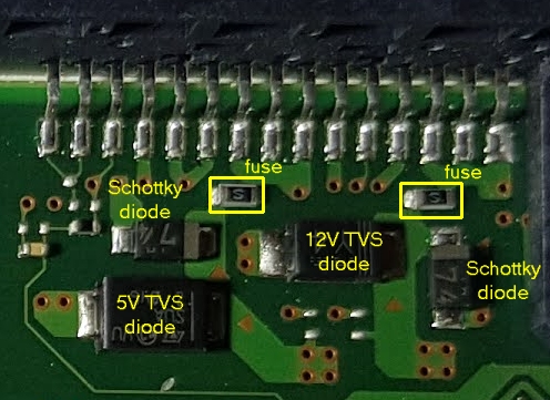

Images of the boards here:
Seagate: https://i.imgur.com/PLG9der.jpg
WD: https://i.imgur.com/s7OHL6o.jpg

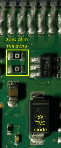

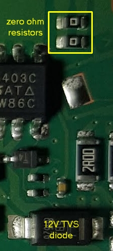

Check these components.

The resistance readings from my multimeter - with the black wire to the cathode end (otherwise "1")
WD. 5v/12v/Schottky 180ohm
Seagate 12v 660ohm
5v 575ohm
I'm afraid I don't know how to test the fuses / 0ohm resistors - can't pick up anything with the multimeter. It doesnt beep when set to continuity over the fuses, not sure if this means they're both blown

A good zero ohm resistor or fuse should measure close to 0.0 ohms on the 200 ohm range. A "1" would indicate that the component was open circuit.

OK. Well it would seem in that case that every single 0ohm resistor on the Seagate board (4 of them), and both fuses on the WD board have gone...
As a control I've put the multimeter across two other 0ohm resistors on the WD board and they both read close to 0.
So.. bits of wire soldered in to replace the 0ohm resistors / fuses?

You can flow a blob of solder over each fuse and resistor, but that would be at your risk. That said, the overvoltage didn't damage any diode, so it would have been at the low end of the Richter scale.
These drives have two levels of protection. The first is the TVS diode and fuse, the second is a load switch. All the load switches appear to have survived.
The safest approach would be to use a donor PCB and transfer the "ROM" chip from patient to donor. However, if you damage the ROM, the cost of data recovery will become extremely high.
I would use picofuses to test each PCB, but I realise that this is not practical for most users. That said, other people have bridged the fuses and resistors with 100% positive results.
