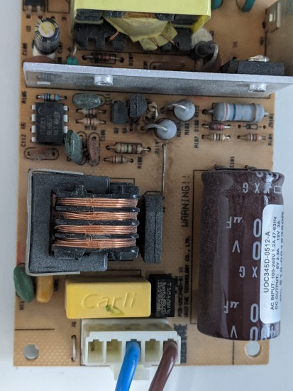

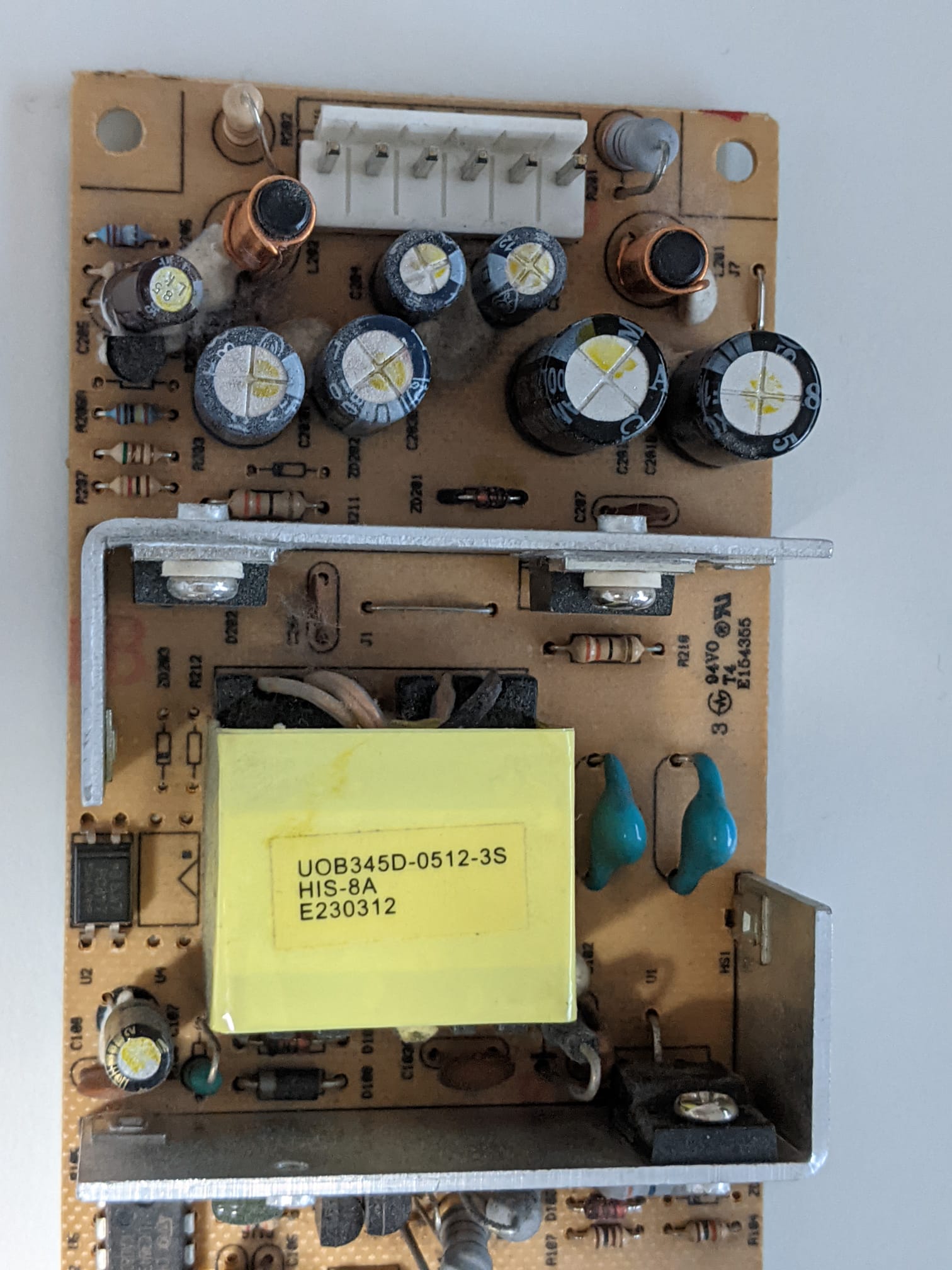

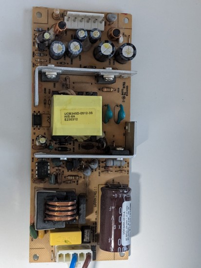

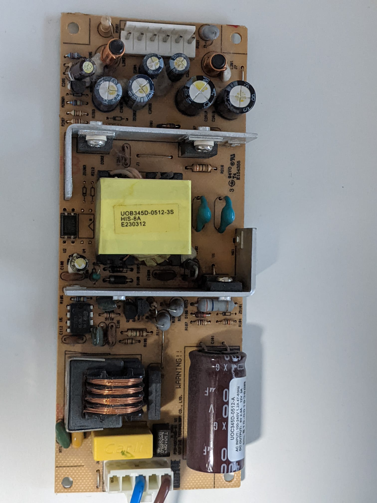

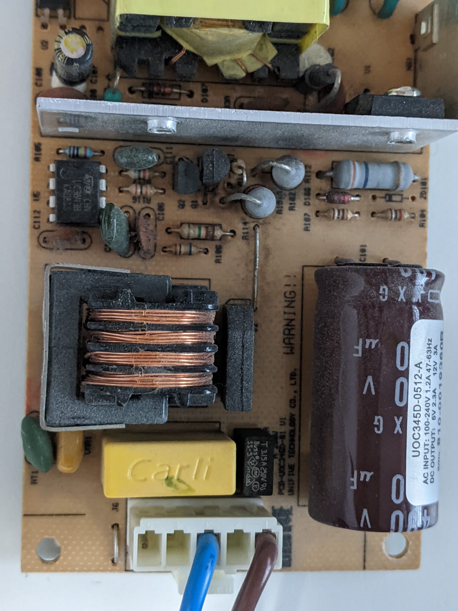

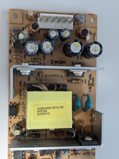

Hi
Buffalo NAS not powering up. Was working for past 10 years, on and off and today, it doesn't show a sign of life.
Before removing drives and trying to rebuild the RAID I would like to see if I can fix power supply and then save all data and buy a second NAS.

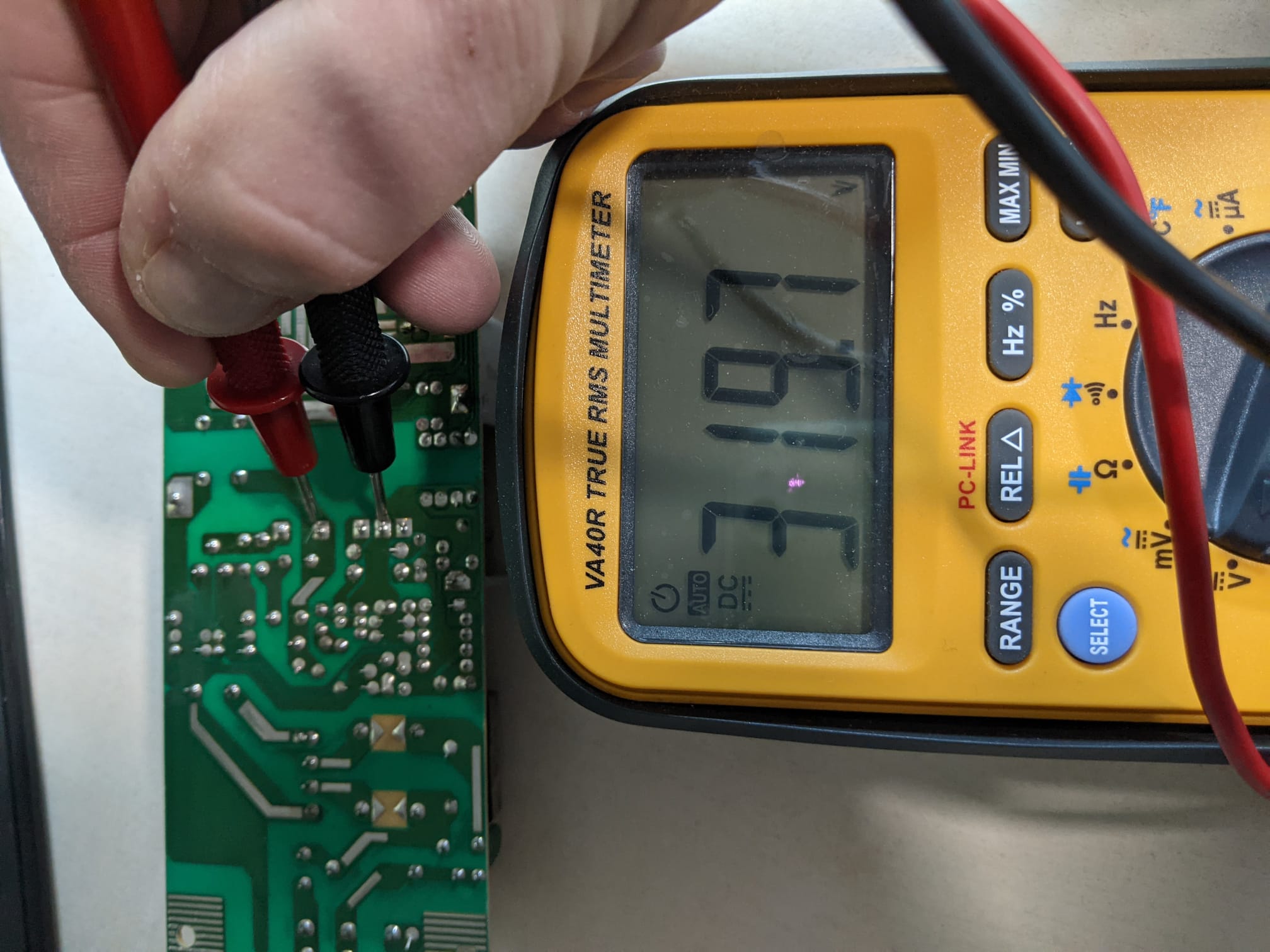

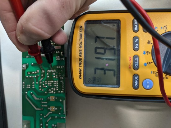

I think the AC part is ok. After the big yellow square"filter" nothing... Could be that component, not sure how to measure it. I don't know why I get 320 DC V...

320V DC is the peak-to-peak value of 210V sine. This is where the line filter cap is charged. Be careful, it can keep that charge for a long time after you remove the power from it. And it is a hell of an experience to touch it in that state. Not to mention if you short it to somewhere, where you shouldn't :)
the yellow 'filter' is a transformer, it should get a switched voltage, swithed by the MOSFET (big black brick mounted on the right side of the heatsink).
UC3843 is the controller IC.
there can be plenty of reasons why it is dead, and you won't be able to determine it using a multimeter alone.
So I would rather go with some other PSU to power up the NAS. check the output voltage and current ratings, i guess it will be 5V and 12V, so you can feed it from a PC supply (probably).

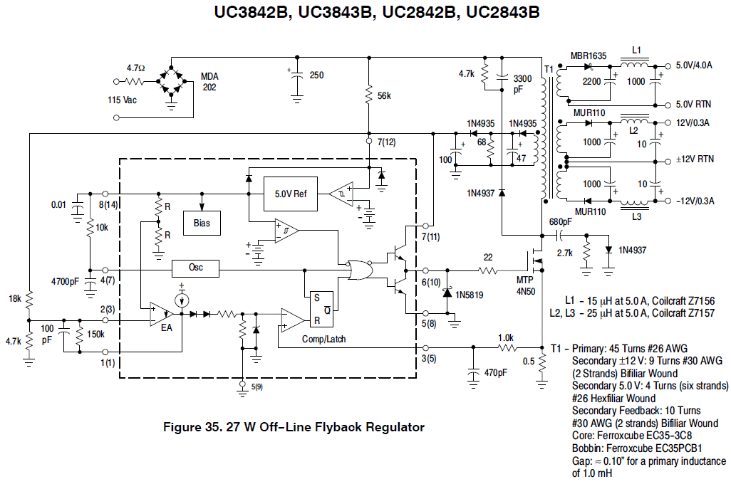

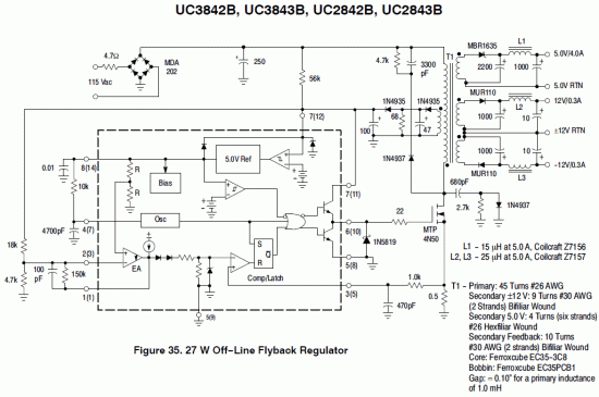

That "filter" is a transformer. I think you probably should stop before your lack of understanding kills you.
The 320VDC comes from the large bulk capacitor (C101). When working on the PCB, you should first discharge it with a 100W incandescent lamp load.
The typical failures with these circuits are the capacitor and startup resistor on pin #7 of the IC.
The startup resistor often goes open circuit. The symptom is that the bulk capacitor retains the rectified mains voltage (340VDC or 170VDC) even after the mains power is switched off (BE CAREFUL), and the IC never gets a Vcc to kickstart it. I suspect that R101 and R102 may be the corresponding startup resistors in your circuit.
A leaky capacitor prevents the IC from getting an auxiliary supply from the transformer. The symptom is that the IC wants to start (by pulsing the MOSFET), but cannot keep going because the Vcc fades away. This happens many times in succession, sometimes resulting in an audible "hiccup". This capacitor is the 100uF cap in the application circuit, just after the 1N4935 diode. C100 in your circuit is probably the same cap.
Datasheet for UC3843B PWM controller:
https://www.st.com/resource/en/datasheet/uc3842b.pdf
This datasheet has an application circuit which probably matches your own:
https://www.onsemi.com/pub/Collateral/UC3842B-D.PDF

If the OP is measuring 320VDC after switching off the power, then I would examine those two startup resistors. They should cost less than 1 Euro.
BTW ...
    230VAC x sqrt(2) = 325VDC
That's what you get when you rectify the mains voltage.

I got this sorted. I connected external power supply 5V and 12V and it's working.
I will have a look at the power supply with a friend of mine. Thank you for all your help and recommendation.
