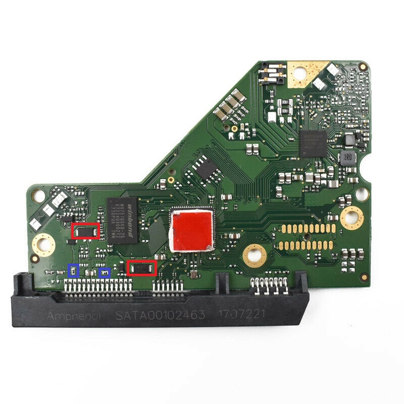

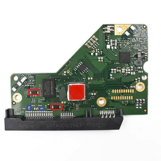

I am needing some confirmation on the TVS diodes and 0 ohm resistor locations. I have attached 2 pics, one marked.
Are red squares the TVS diodes here? If so, both read at 86 ohms.
Are the blue squares the 0 ohm resistors? If so, they both read open.
If need be, I know I can remove the diodes and bridge the resistor location, but what part numbers do I need to replace all these to safely use the drive again?

The transils are SMA6F5.0A and SMA6F13A (available at farnell.com)
The fuses are 0603 4A

Measure the diodes in both directions. When you place the red probe on ground, you are forward biasing the Schottky rectifier that is in parallel with the TVS diode. This is responsible for the low reading.

They do not read at all in the reverse direction(200 ohm setting) reading 123 on both, one direction with setting on diode. Are the blue squares the 0 ohm resistors? Are the part numbers OK that Mikippp referenced?

The blue squares are either fuses or zero-ohm resistors ("0" marking).
As for the TVS diodes, most HDD PCBs would use an SMA6F12A rather than the SMA6F13A. The difference is in the standoff voltage and breakdown voltage. Your Schottky and TVS diodes are testing OK.

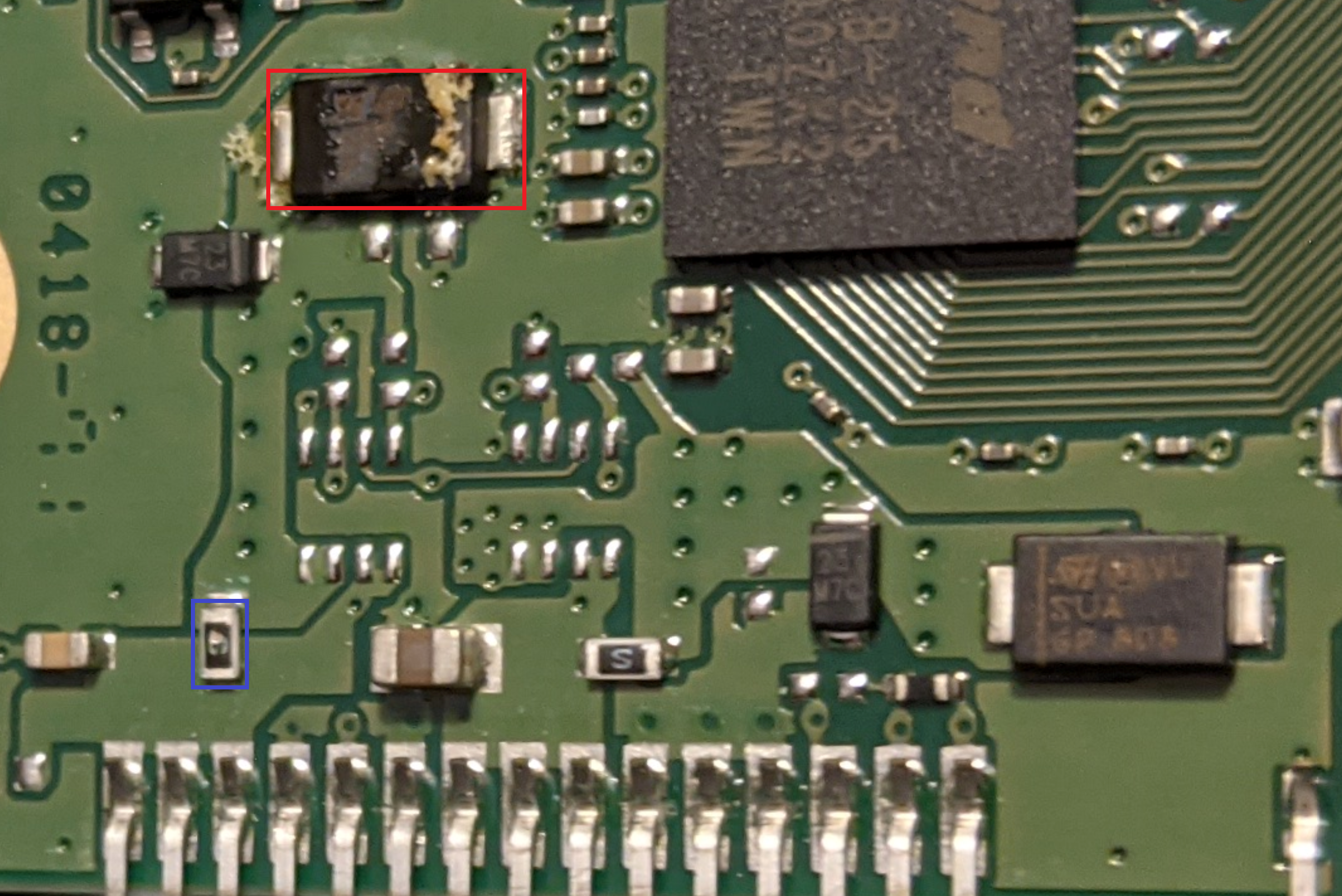

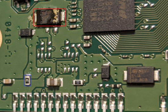

Working on the same board. Drive is from an external that had a 19V laptop power cord plugged in.
12V diode (red) is shorted. [diode check is 0.1 in both directions. resistance is 0.6 ohms in both directions.
12V fuse (blue) measuring 10k ohms = bad. This is an 0603.
I have not used fuses in smd designs. From what I can see the 5V fuse is marked S. The 12V fuse is marked with something like a C with a chip in the top surface? Are manufacturers consistent on markings for fuses? From the comments above I should expect the 12V rail to have a 4A fuse labeled S, but I have a C (0.2A)? Also from above, I should expect the 5V rail to have a 2A fuse which would be labeled N -- but I have an S (4A).
For reference, presumed good values on the 5V rail: the 5V fuse (marked S) is 0.6 ohms. The 5V diode is 1.445k, and 600 ohms initially in the inverse polarity. Diode check is 2V and 0.2V.

The fuse on the 12V rail should carry around 2A at startup. The 12V rail powers the spindle motor and voice coil. I believe the 5V supply typically delivers around 1A.
The two smaller diodes (in parallel with the TVS diodes) are Schottky rectifiers. I believe they are intended for reverse polarity protection. They would be responsible for the 0.2V reading.
