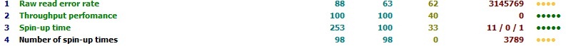

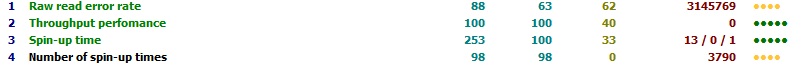

If you have a backup of "HDD SMART REPORT", it can be managed. HDD records Number of spin-up times, I have attached a sample picture.
