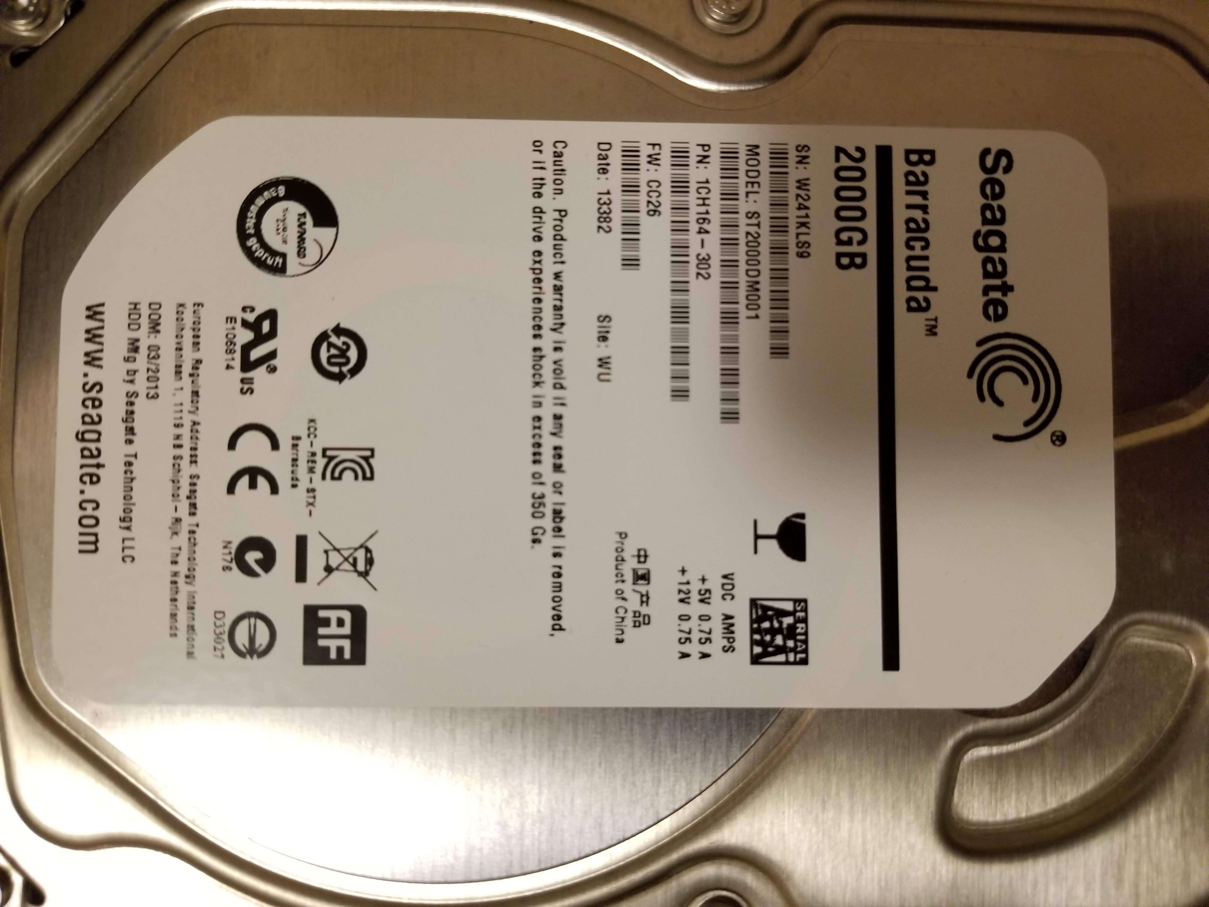

Hello everyone!
I have a Seagate Barracuda internal hard drive (ST2000DM001) that I was using as an extra data drive, and just recently it stopped being recognized by Windows & the BIOS. I should mention early on that the data on here is not at all valuable and not worth professional recovery efforts, I have already considered it lost. That being said, I wanted to try messing around with it to see what could be done and maybe see if some data could be pulled off, just to learn more!
When plugged in, the drive spins up like normal, but I cannot hear any sound of head activity. I did some reading & purchased a CP2104 USB TTL adapter, and then hooked it up to the COM port (TX & RX pins) to pull the logs. This is what I get:
Boot 0x40M
Spin Up
Trans.
Spin Up
SpinOK
TCC:0016
(P) SATA Reset
I would really appreciate any guidance on what steps I should take to see if I can get this drive recognized again & maybe even see if any kind of data recovery is viable!
Many thanks!
File comment: ST2000DM001

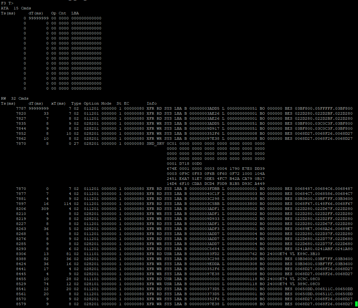

Hey Everyone!
Found some time to get back at this. Got the right tool, took the board off, and must have done something to mess up the HSA pads or another part of the board, because putting the board back on the drive caused it to click and stop spinning. Ordered a new PCB, did a ROM chip swap, and now the drive is back to spinning properly. Not only that, with the old PCB I wasn't able to access terminal commands, but with the new PCB, repeatedly pressing CTRL + Z during the boot process gives me command line access, no need to short pins. Not sure what is different or how that is possible, maybe TX/RX pins on old board were not functioning properly.
The boot log is the same as before, with the exception of the command line:
Boot 0x40M
Spin Up
Trans.
Spin Up
SpinOK
TCC:001D
(P) SATA Reset
ASCII Diag mode
F3 T>
I've gone ahead and run the informational commands, and I've attached their results. In summary:
X -> Not too sure how to interpret, heads 0 and 4 might be weak?
V1 -> Long list, around 7610 entries
V2 -> Short list, 10 entries
V4 -> Long list, 11285 entries, 385 alts
V10 -> Long list, 9040 entries
V40 -> No Entries
N5 -> Not sure how to interpret
I tried clearing S.M.A.R.T with N1 and power cycling, unfortunately the drive was still not visible in BIOS afterwards.
I feel like getting it visible is very close, similar threads report clearing G-list & SMART, then power cycling, but others try rebuilding translator. However, my translator appears to be loading correctly, so I wanted to consult with you folks before trying anything too drastic.
Any help would really be greatly appreciated!

 Post subject: Re: ST2000DM001 Suddenly Not Recognized By BIOS
PostPosted: April 16th, 2021, 7:16
Posts: 4816
I vote for H1 being weak.
It should still get ready though, at least visible during BIOS detection.
FYI, the sata interface is not accessible in ASCII diag mode (ie after pressing ctrl-z).
press ctrl-r to return online mode and press ctrl-V to activate echo interface commands.
It would also be useful to check it with some low-level prog like mhdd.

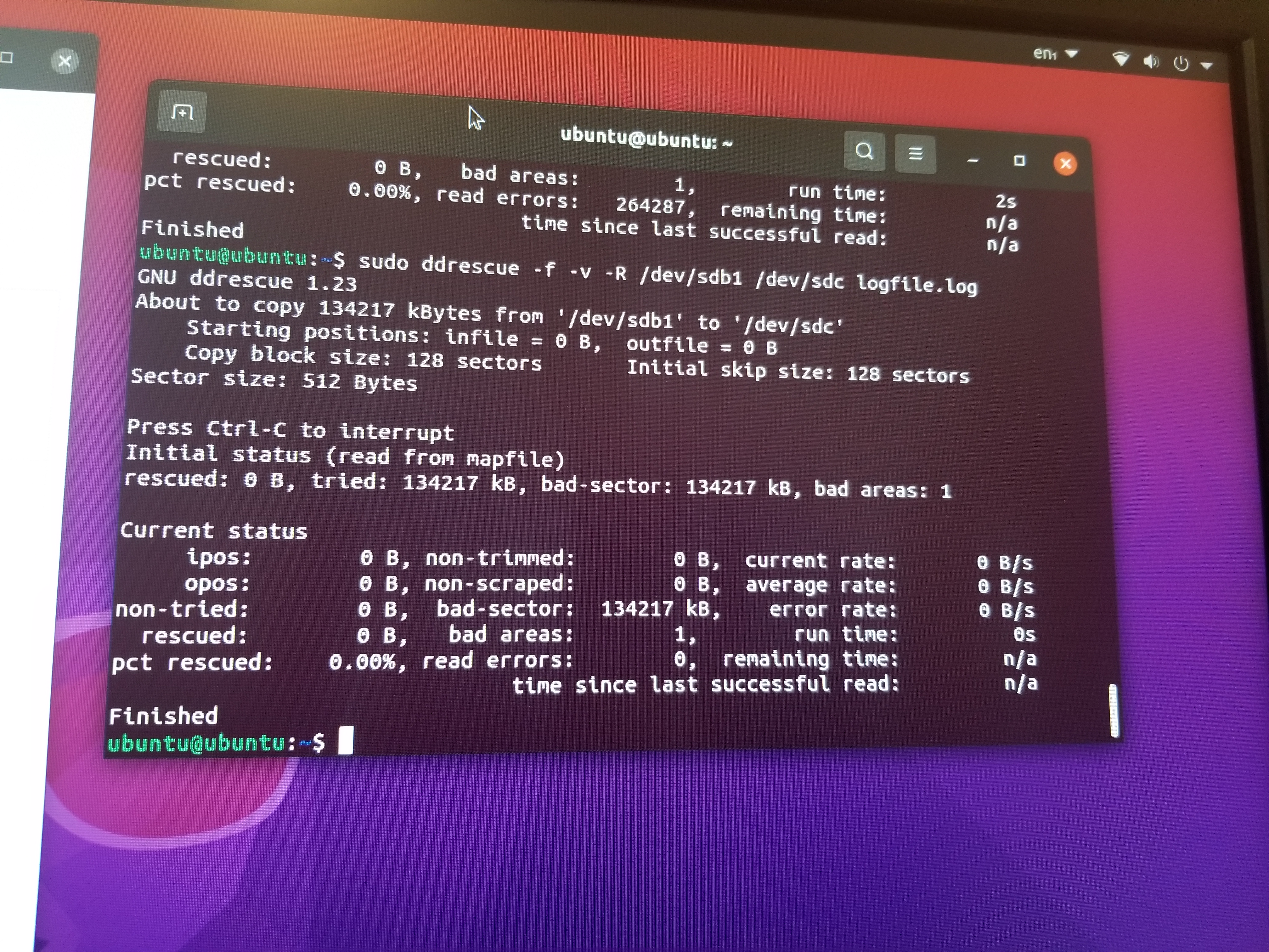

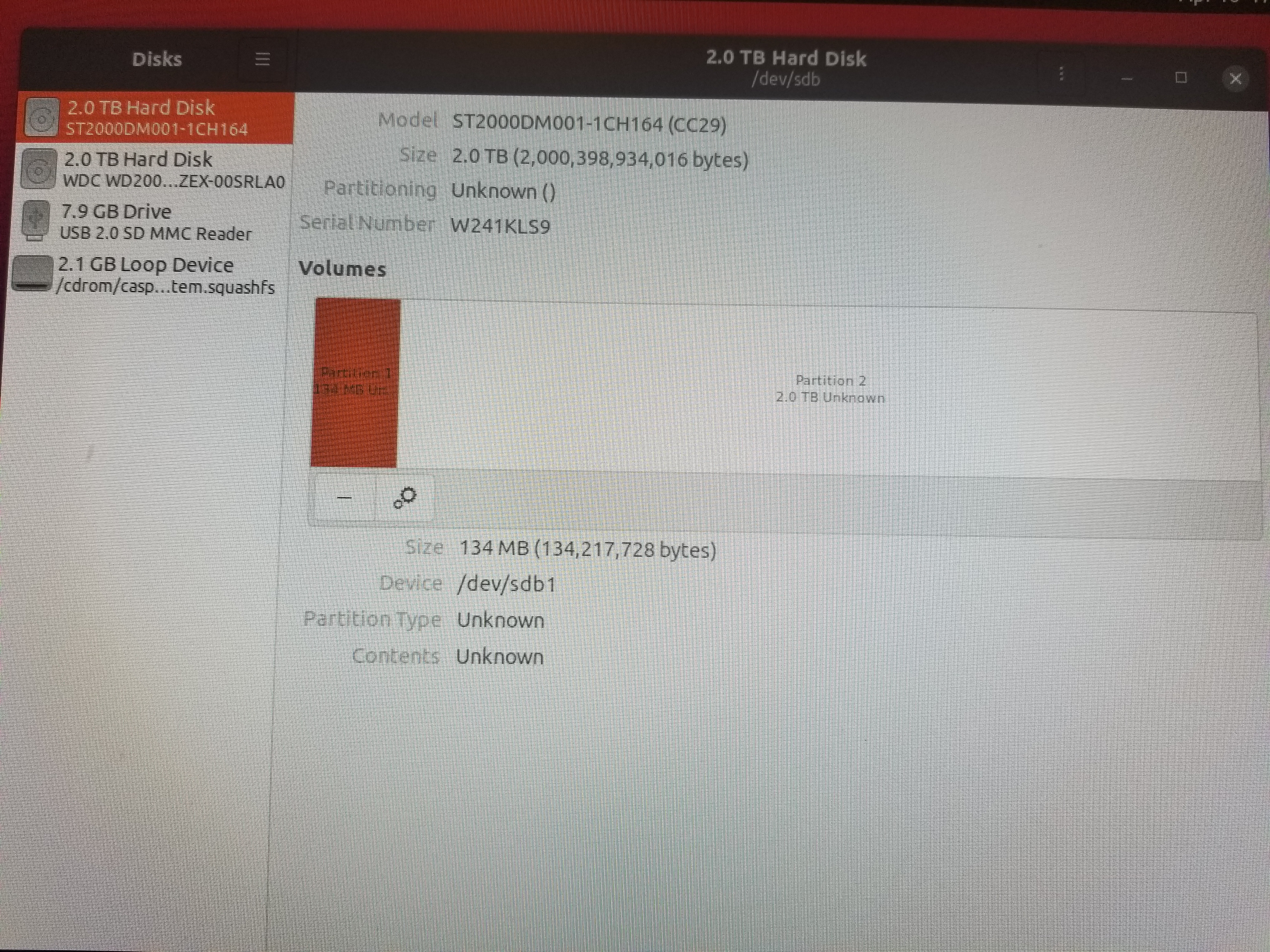

pepe, thank you so much for your reply.
I will have to work the heads until they die unfortunately, no replacement for me (no clean room or experience). There were some interesting developments after following your suggestions. Pressing CTRL-R after CTRL-Z caused the command line to hang. It seemed that the drive was not able to go ready. I tried to 'force' it to ready by repeatedly restarting the computer into the BIOS, with only the problem drive connected, and after several tries, the drive properly ID'd. I immediately connected my spare target drive and booted into linux to attempt ddrescue, but when trying to run ddrescue (forward and reverse), nothing could be read properly. It seems there is extensive firmware damage. I've attached photos of what I saw.
I restarted the machine and attempted to read the terminal boot log again to see if anything was different, and I saw some new errors appear that I hadn't seen before, before the terminal again hung. I power cycled, pressed CTRL+Z and was able to get a prompt again. I've attached a picture of those errors as well.
Some research led me to believe that some of those errors are with sysfile 17a and possibly 133, but an AceLab document says that if these files were damaged I would get 'DiagError 0000000E' when trying to read them, but instead, the files appear to read normally. I don't really know if these sysfiles are damaged or not. I've attached the read attempt.
I also saw what appeared to be Media Cache errors (LED000000EE), so I think Media Cache needs to be disabled as well. I believe these are the commands to do so, after looking at some other threads.
F"READ_SPARING_ENABLED",0,22
F"WRITE_SPARING_ENABLED",0,22
F"OFFLINE_SPARING_ENABLED",0,22
F"DAR_ENABLED",0,22
F"DISABLE_IDLE_ACTIVITY",1,22
F"BGMS_DISABLE_DATA_REFRESH",1,22
F"ABORT_PREFETCH",1,22
F"READ_LOOKAHEAD_DISABLED_ON_POWER_UP",1,22
F"READ_CACHING_DISABLED_ON_POWER_UP",1,22
F"RWRecoveryFlags",00,22
F"BGMSFlags",00,22
F"PerformanceFlags",043C,22
F"MediaCacheControl",00,22
Should I go ahead and disable the Media Cache? How do I determine if sysfiles 17a and 133 are really damaged? I've attached CTRL+X as well, I've read it can possibly display damaged modules, but unfortunately I'm struggling to understand it. I feel like I'm close to getting this drive to reliably ID!
Thank you so much for your help!

An update to this, the drive is now able to ID properly, and data is being copied through ddrescue (sector copy to another 2TB drive).
I did my best to fix the errors that were popping up. For the media cache errors, I backed up sysfile 346 before writing a zeroed out copy of the same size, I then re-initialized the MCMT using the U1, U2, and U3 commands. I finally then disabled it entirely using the Cogen command found in this sysfile93 patching thread (after backing up sysfile 93):
http://www.hddoracle.com/viewtopic.php?f=59&t=1842
After dealing with Media Cache, I was still unable to ID the drive in BIOS. I went on to try and fix the SIM 1009 error. Following this link,
https://web.archive.org/web/20170914073351/http://ts.acelaboratory.com/index.php?/Knowledgebase/Article/View/23/0/sim-error-1009-rw-error-00000080-17a-sys-file
I backed up copies of the 17a (SMART config?) and 133 (also SMART config?) sysfiles. I then downloaded and wrote the files provided in the above link, since they were the exact same size. It should be noted, however, that even after doing this I saw the SIM 1009 error once more, and the link then suggested a translator regeneration.
Before attempting that, I backed up sysfile 93 again and applied the remaining commands from the above sysfile 93 patching thread, to completely disable reallocation. After a power cycle, drive was still not able to ID.
I then went on to clear g-list. I checked non-resident g-list to ensure there were no entries, and made backups of sysfile 28 (translator), and 35 (non-resident g-list). I then used this command:
T>i4,1,22
to clear g-list. I followed this with clearing SMART:
T>/1
1>N1
Finally, I regenerated the translator using this command (includes ALT list):
m0,6,3,,,,,22
Interesting to note that, after regenerating translator, 3 entries appeared in the non-resident g-list. I then made backups of these new 28 and 35 sysfiles as well, just in case. I followed this with a power cycle of the drive, then headed into my Ubuntu environment, where I plugged it in and it ID'd after a little bit of waiting, with access to the user space. The sector copy then began in ddrescue.
It is expected to take 40 days, I don't believe the heads will last that long, but I intend to let it run until it is no longer able to. There is extensive media damage with bad sectors, and the heads aren't in the best shape (drive is around 8 years old). I am also aware the firmware is in bad shape, despite my best efforts. I know some of those bad sectors are in the Service Area.
All in all, not too bad! I learned how to do a successful PCB / ROM swap, followed by learning so much about Seagate's F3 architecture and terminal commands. I may not get the data in the end, but the knowledge itself was well worth it. Now it is time to play the waiting game. Who knows, maybe it will complete, I've been surprised before!

Hey everyone, just had an update to this.
As it turns out, Pepe's earlier assertion was completely correct.
ddrescue completed a first copying pass, rescuing 57% of the total drive. Viewing the rescue log in ddrescueview, there were some clear zig-zag patterns with non-tried areas across the drive surface, which from my reading was indicative of weak head(s).
I thought that there was nothing else left for me to do, but after some more reading I found an experimental, risky technique employed by some of the more senior members on Seagate drives with weak heads, a technique which involves manipulating the flying height of the read/write heads. For any that may come across this, here are some great resources and information on this technique:
https://www.google.ca/url?sa=t&rct=j&q=&esrc=s&source=web&cd=&cad=rja&uact=8&ved=2ahUKEwiTkeH_kevwAhXbAZ0JHbLHAuUQFjABegQIAxAD&url=http%3A%2F%2Fmaeresearch.ucsd.edu%2Fcallafon%2Fpublications%2F2011%2FUweIEEETonM.pdf&usg=AOvVaw1DSRpO_KfX5aJzdhM-wS9V
http://www.hddoracle.com/viewtopic.php?f=175&t=2682
https://forum.acelaboratory.com/viewtopic.php?f=154&t=9993
Essentially, it involves manipulating the current flow to the resistive heating element at the tip of the read/write head to raise/lower the flying height. This is achieved by adjusting the Read Adaptive Parameters, specifically, the RHtClr parameter. In this case, the goal was increasing current flow to the element to cause the tip to expand, dropping the weak head(s) closer to the platter surface to get a better read.
I followed the above instructions, applying the above technique to head 1 first since Pepe was confident in it being the troublesome head. A boost of 20 led to some lower LBA's becoming readable, but the higher ones still throwing errors. A boost of 30 across all zones led to the higher ones becoming readable, but not the lower ones. Eventually I settled on a boost of 2E across all the zones for head 1, giving stable reads on lower and higher LBA's that were previously entirely unreadable. Changes were tested with a quick run through sections of the drive with MHDD.
I am now continuing the previous ddrescue image, it is going through and picking up all the previously unreadable areas at a solid rate of about 5 MB/s - 7MB/s, compared to the 500 kB/s it was reading through the other heads. Whether the head(s) will survive to complete the image or not, only time will tell...
