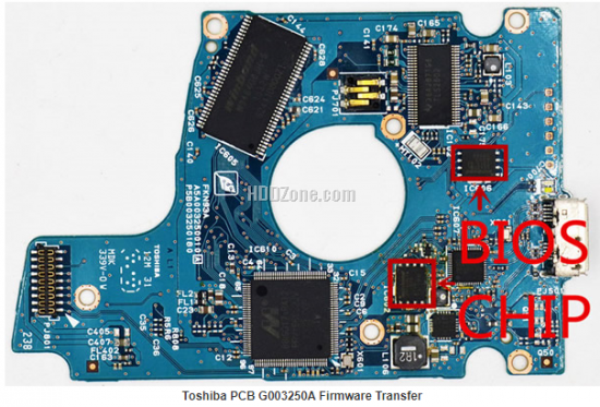

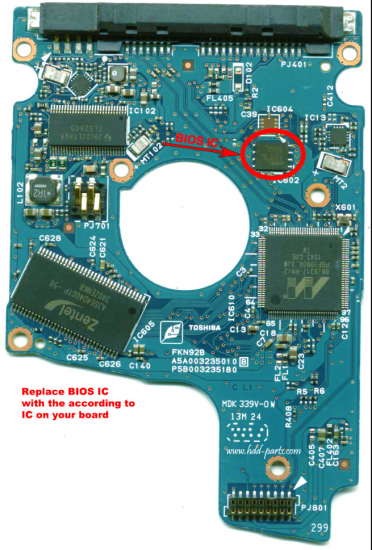

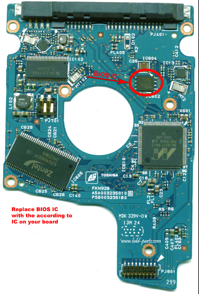

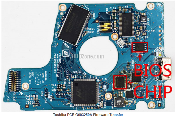

I have a Toshiba USB drive, PCB number G003250A
Looking for compatibilities, I found out that the PCB G003235C is compatible.
The problem is how do I know where is the BIOS chip I need to swap.
I have attached 2 pictures for ilustration purposes.
Your help is greatly appreciated.
File comment: This is the compatible SATA PCB
File comment: This is the USB failing PCB
 Post subject: Re: Toshiba PCB swap question
PostPosted: February 2nd, 2021, 22:06
IC602 is the one, as it is the only one on the SATA PCB.
