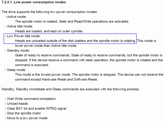

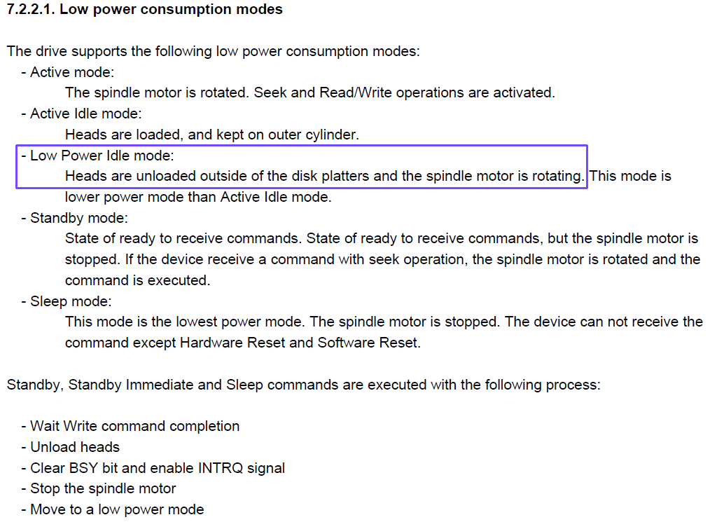

So how can a head designed to fly at 7200 RPM work in a 5400 RPM application? Wouldn't it fly lower?
Hitachi once advertised CoolSpin for 7200 RPM drives, maybe the 7K1000.c or 7K3000, that could reduce the speed to something like 4500 RPM during idle periods, but it had to be enabled through Drive Fitness Test.
 Post subject: Re: 5k1000 - 7k1000
PostPosted: February 24th, 2021, 15:10
Posts: 17232
You will probably find that the the heads are retracted onto the loading ramp during this time, not flying over the platters.
PostPosted: February 24th, 2021, 15:27
Posts: 17232
It's called "low power idle mode".
