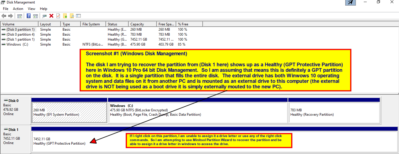

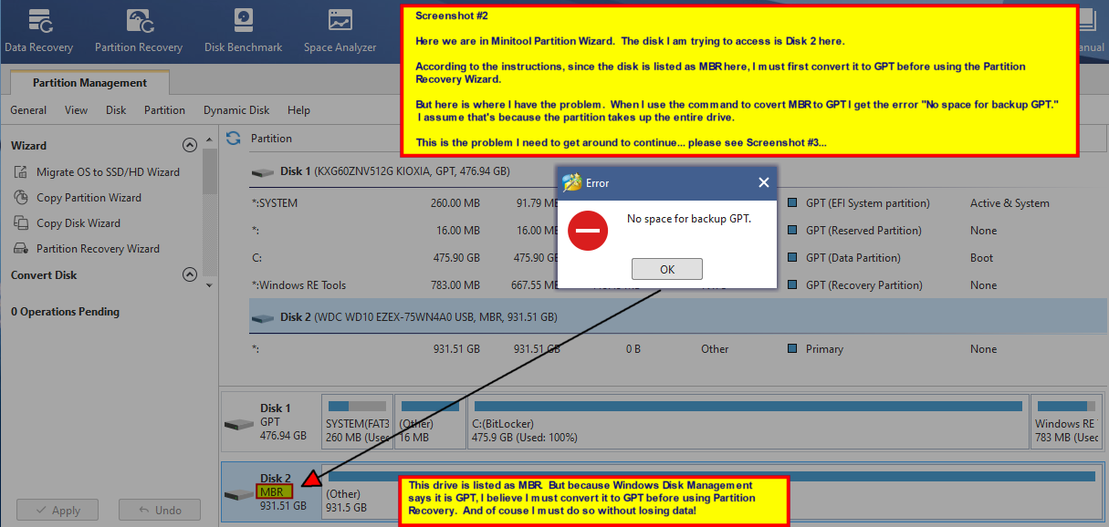

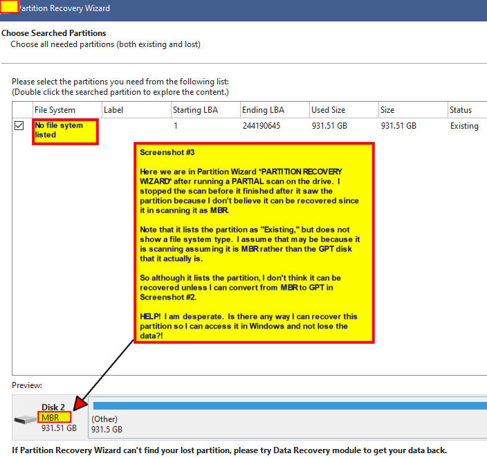

I am desperately attempting to recover my hard drive from my old failed PC so I can mount it as an external drive to my new PC and access the data on it in the Windows 10 Pro 64 bit OS on the new PC.
I am attempting to use Minitool Partition Wizard's Partition Recover Wizard to accomplish this.
I have prepared 3 screenshots which explain what I am doing and where I am stuck. They are attached.
The problem seems to be that in order for Partition Wizard's Partition Recovery Wizard to recover the partition it has to first be "converted" from MBR to GPT. That is the note they have in their instructions for using the Partition Recovery Wizard. I don't really understand that since isn't it already a GPT partition? I don't get why Partition Wizard shows it as an MBR partition and needs to "convert" it first. But that is what I interpret the instructions to mean. Anyway, I am unable to convert it to GPT because when I try to do so it generates and error (please see screenshots).
Please take a look at my screenshots and if possible please tell me if there is any way I can recover this partition so I can assign it a drive letter in Windows. It seems so close yet so far!
Thank you!

Please don't convert anything.
The problem appears to be that your external enclosure is configured with a sector size of 4096 bytes. This makes your protective MBR partition look 8 times larger.
You can see this if you examine your drive with the free version of DMDE:
https://dmde.com/
You need to find a 512B enclosure. Alternatively, you can recover your data with the standard version of DMDE (US$20).

I did in fact notice that Windows Disk Manager shows the drive as 7452.11 GB in size even though it is a "1.0TB" drive. So Disk Manager does appear to be showing the wrong size and much larger than it actually is.
Are you saying that with a different enclosure you think I won't need any recovery software and will be able to assign it a drive letter directly in Windows Disk Manager? That would be awesome.
I am not using an actual enclosure but and old SATA cable and power supply adaptor I have to connect it to the USB port on my new PC. Where can I get an enclosure or cable that will do this? I am unfamiliar with this issue. Isn't the sector size determined by the drive and not the enclosure?

However, Partition Wizard appears to show it as the correct size 931.51 GB. So does the sector size of the enclosure have anything to do with the error on attempting to convert from MBR to GPT in Partition Wizard?
My understanding is, and I have received multiple confirmations of this from different sources, is that when Partition Wizard is used to convert the partition from MBR to GPT it does not destroy data on the disk, it only converts the partition from MBS to GPT. So I am not clear on why I should not convert it since that would be necessary to recover the partition.
Partition Wizard can "recover the data." It has a module to do that and I tried it and it works. But what I want to do is to recover the partition, not the raw data files. I need to have the folder structure and file names preserved. If I simply recover the data I get generically named files with no folder structure. And some files of types not recognized won't be recovered at all.
So I want to make the important distinction that what I am hoping to end up with is a recovered partition with all folder and path structure intact that I can mount as an external drive in Windows and access... not just recovered files.

DMDE will show you the sector size of your USB-SATA bridge.
You cannot fix anything by converting between GPT and MBR. You will only make things worse.

The capacity seen by Disk Management is based on the number of sectors reported in the MBR, and the sector size reported by the USB-SATA bridge firmware. That would be 1953525168 sectors and 4096 bytes per sector, respectively.
The capacity seen by Partition Wizard appears to reflect the number of sectors reported by the drive, and the sector size reported by the drive, ie 1953525168 sectors and 512 bytes per sector, respectively.
Therefore, you need to connect the drive directly to a SATA port inside your computer, in which case Disk Management will then see a sector size of 512 bytes. Alternatively, get an enclosure that is configured with a sector size of 512 bytes.

SUCCESS! Just a quick post to tell both of you guys YOU WERE BOTH RIGHT!
OUTSTANDING ADVICE!!!
Sure enough, plugged it directly into the SATA port and voila. Perfect access to the drive.
You would have thought this is an obvious solution but without fzabkar advising me that the external adaptor might be the issue and that I should not try to convert the disk and Lardman suggesting I connect it directly to the SATA port, I would have assumed that the disk had a problem and probably messed it up. I would have assumed that since I couldn't access it with the adaptor there was a problem with the disk that had to be fixed! But that is wrong. The disk is 100%.
