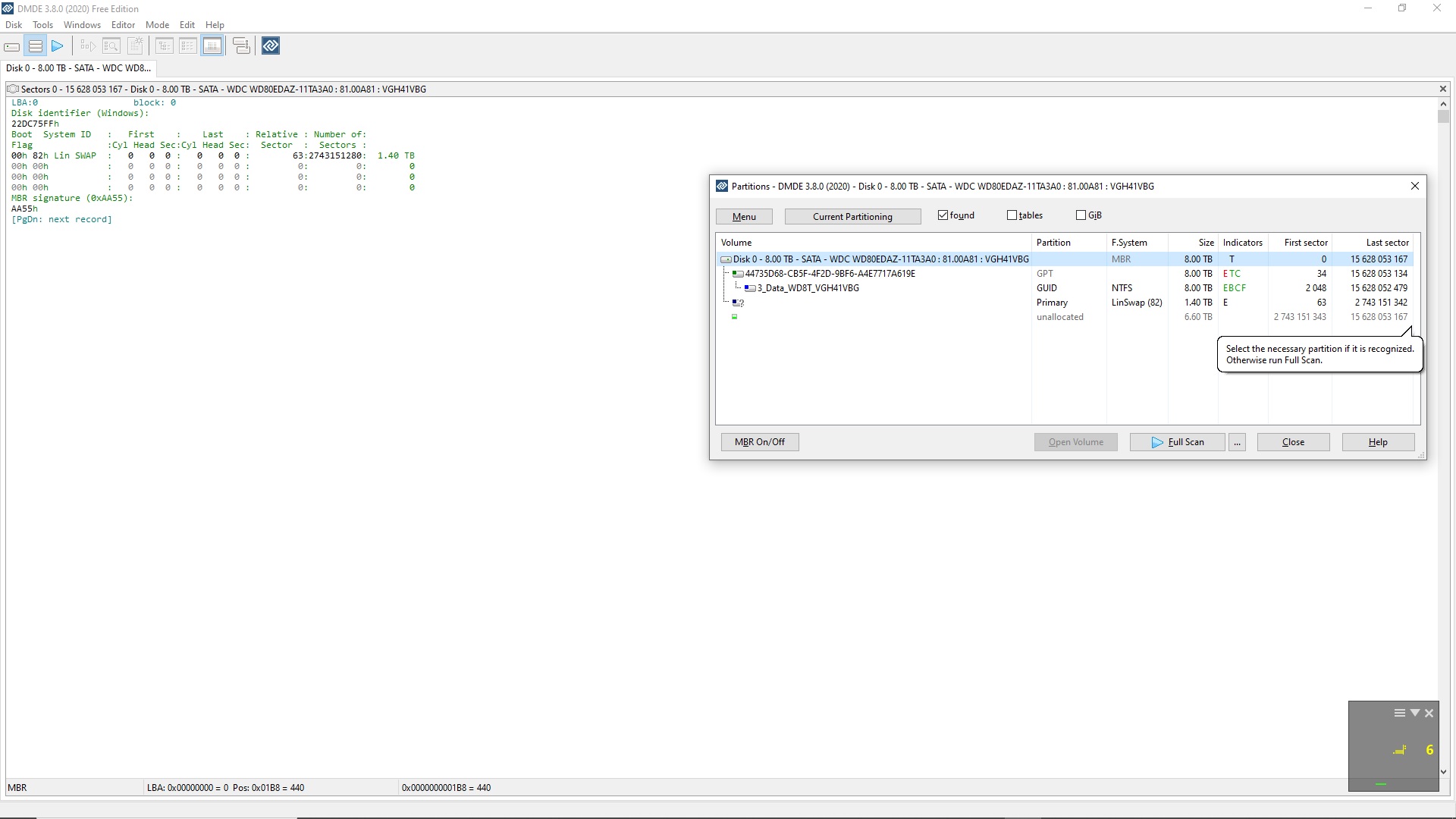

Good day,

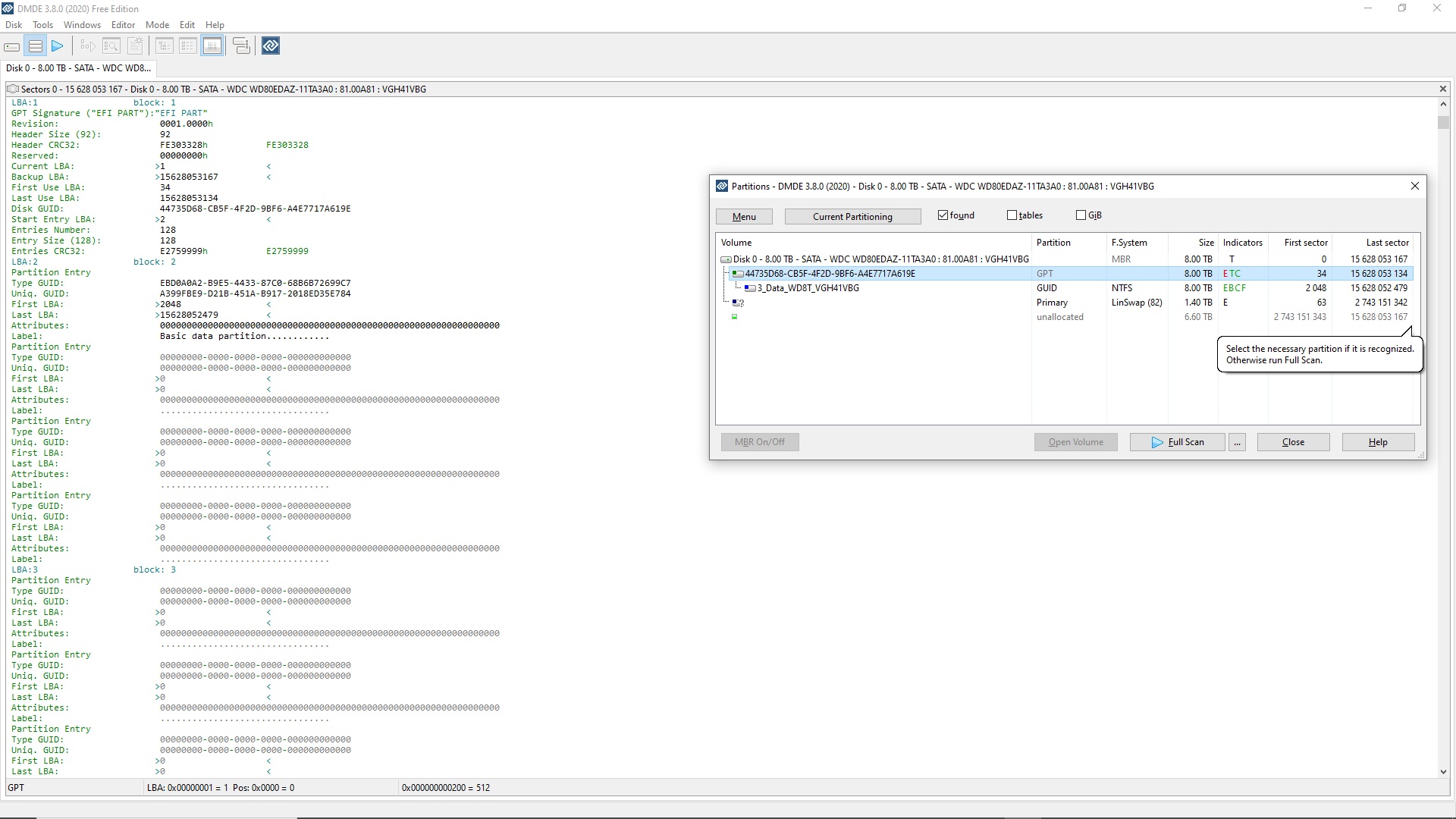

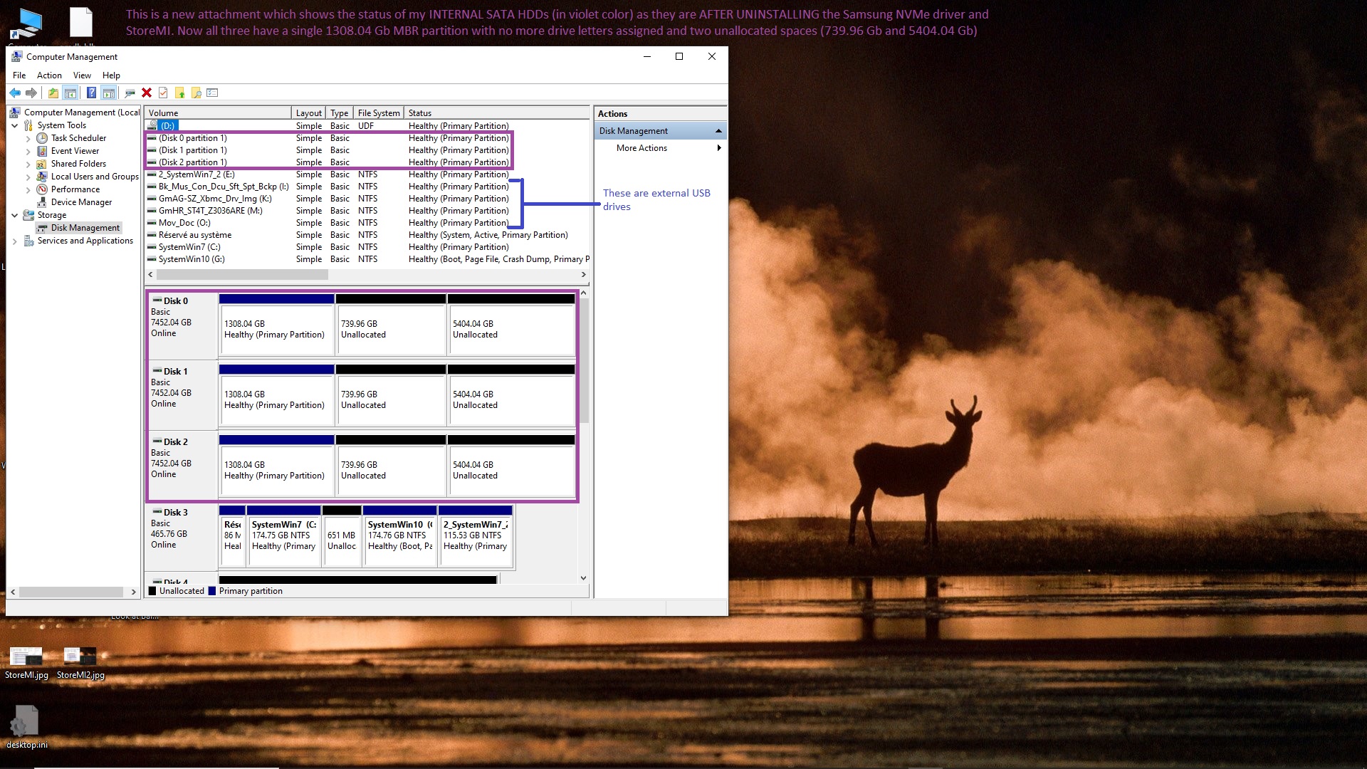

TL;DR All my internal GPT SATA HDDs suddenly became MBR, with unallocated spaces (see attachment) probalby following drivers changes. What method/tool give me the best chance to recover the data?
I have 3 internal SATA HDDs (games, programs, data), 1 NVMe PCIE 3.0 4x drive (bootable system drive dual booting Windows 7 and 10), 1 NVMe PCIE 2.0 4x drive unallocated.
Under Windows 10 I installed StoreMI (an AMD caching software) to use the NVMe PCIE 2.0 4x drive as a cache for one of my HDDs.
The NVMe cache drive (a Samsung 970 Evo) was not selectable as a cache under StoreMI so I contacted the AMD support who advised me to uninstall the proprietary Samsung driver, which I did through the device manager (after creating a restore point). Then I rebooted...
And then all of my 3 internal SATA HDDs (which were GPT, 8Tb single partition drives) had become MBR, with one partition (with no more drive letter) and two unallocated spaces of the exact same sizes for each drive ! (cf. attachment).
Most likely the StoreMI drivers did not play well with the removing of the Samsung EVO drivers.
Anyway, my data is safe (I make backups), my NVMe system disk is intact (and backed up). I am very confident that apart from whatever happened that changed the partitioning of my 3 internal SATA HDDs nothing else was written on them since they are only sollicited when I launch specific applications / access specific data. So I want to attempt a recovery of those HDDs (otherwise I would have a large number of games, many of them painstakingly modded which make them hard to recreate and of programs to reinstall).
I have a spare 8Tb HDD so my plan is to (one internal SATA HDD at a time): Make a low level backup of an entire internal SATA HDD to the spare HDD (I don't want to risk making recovery more difficult due to writes to the internal HDDs) , then using recovery tools on that 'cloned' HDD.

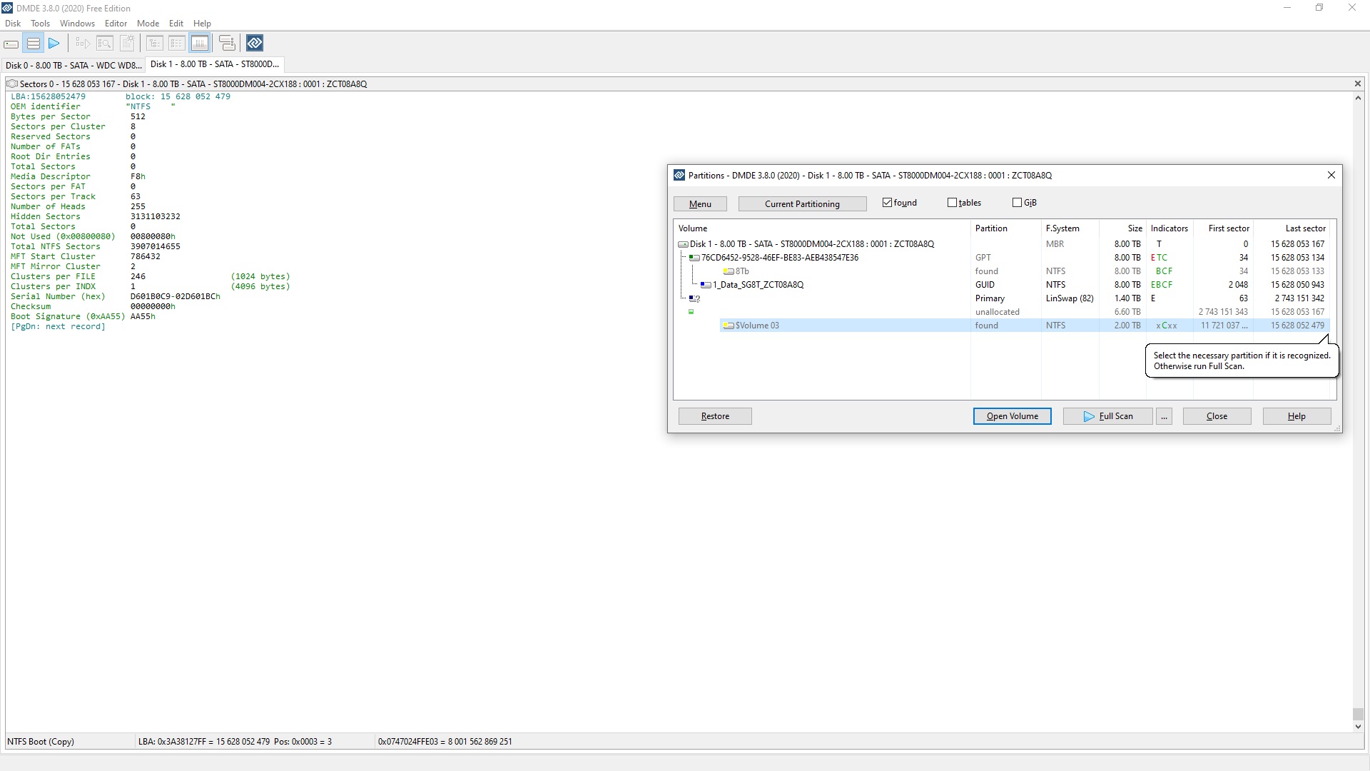

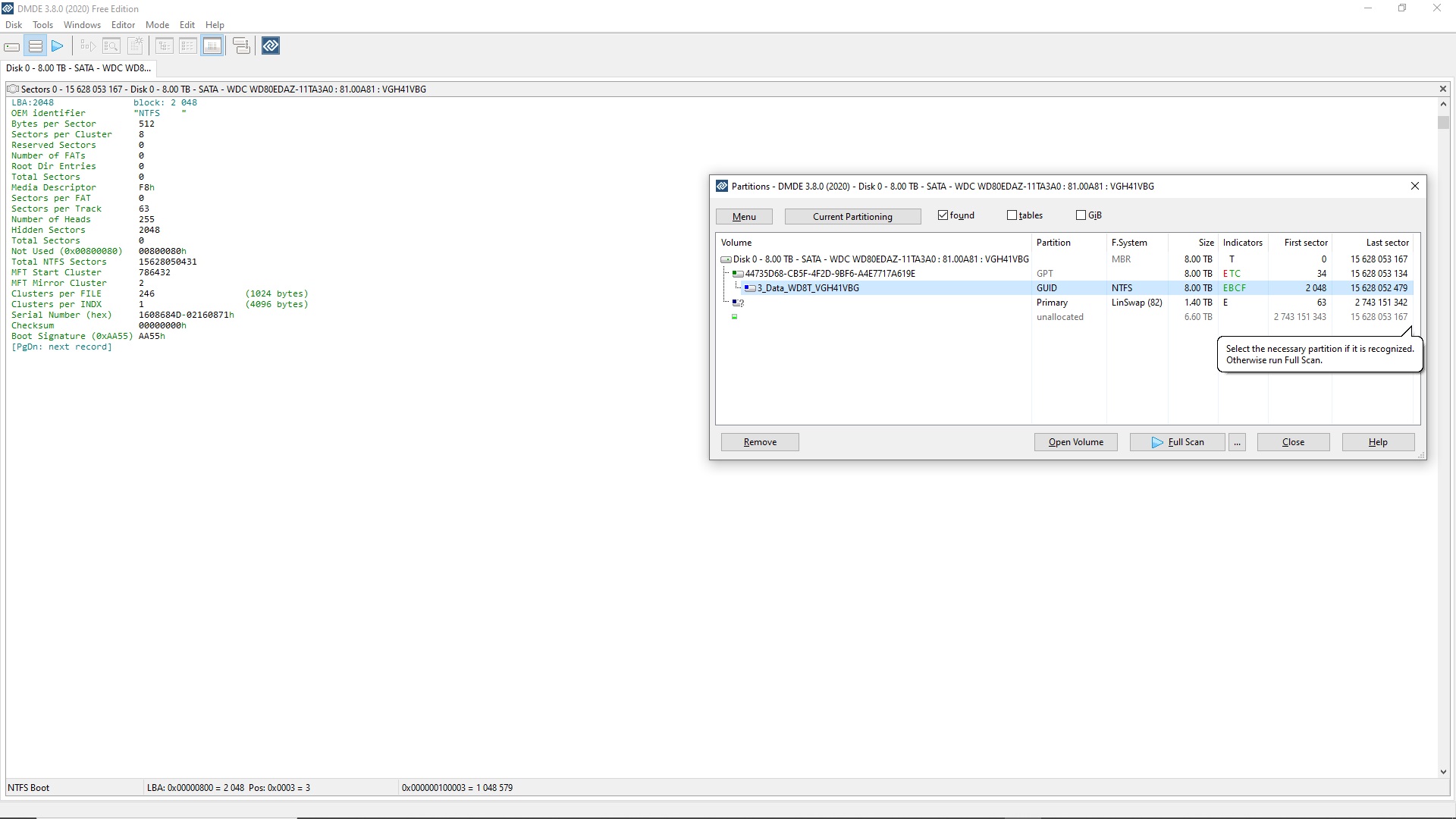

It may be possible to recover your data with a few clicks using DMDE:
https://dmde.com/
Can you show us DMDE's Partitions window? No need for a full scan, we just need to see something like this:
http://www.users.on.net/~fzabkar/DMDE/DMDE_Elements-8TB_Partitions.jpg

Good day,
And thank you very much for your time and efforts in helping me with this.

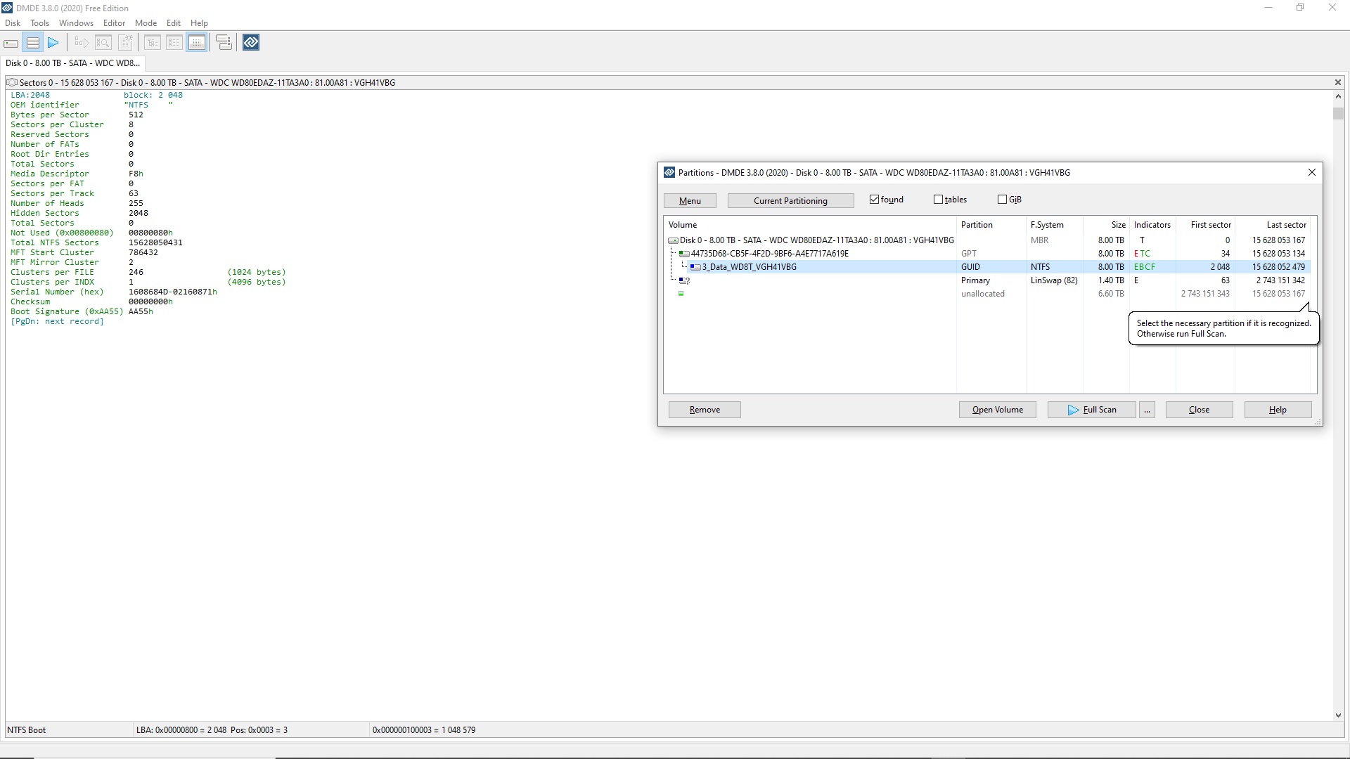

I took screenshots as requested, possibly more than necessary as I am not sure which information is relevant to you. I am posting 3 replies with screenshots (1 for each disk). For each disk I did not take screenshots of the layers that showed the hexadecimal contents on the drive, only the layers that seemed to show synthetic information.
Attached are the screenshots for Disk 0.
File comment: Layer 3
File comment: Layer 2

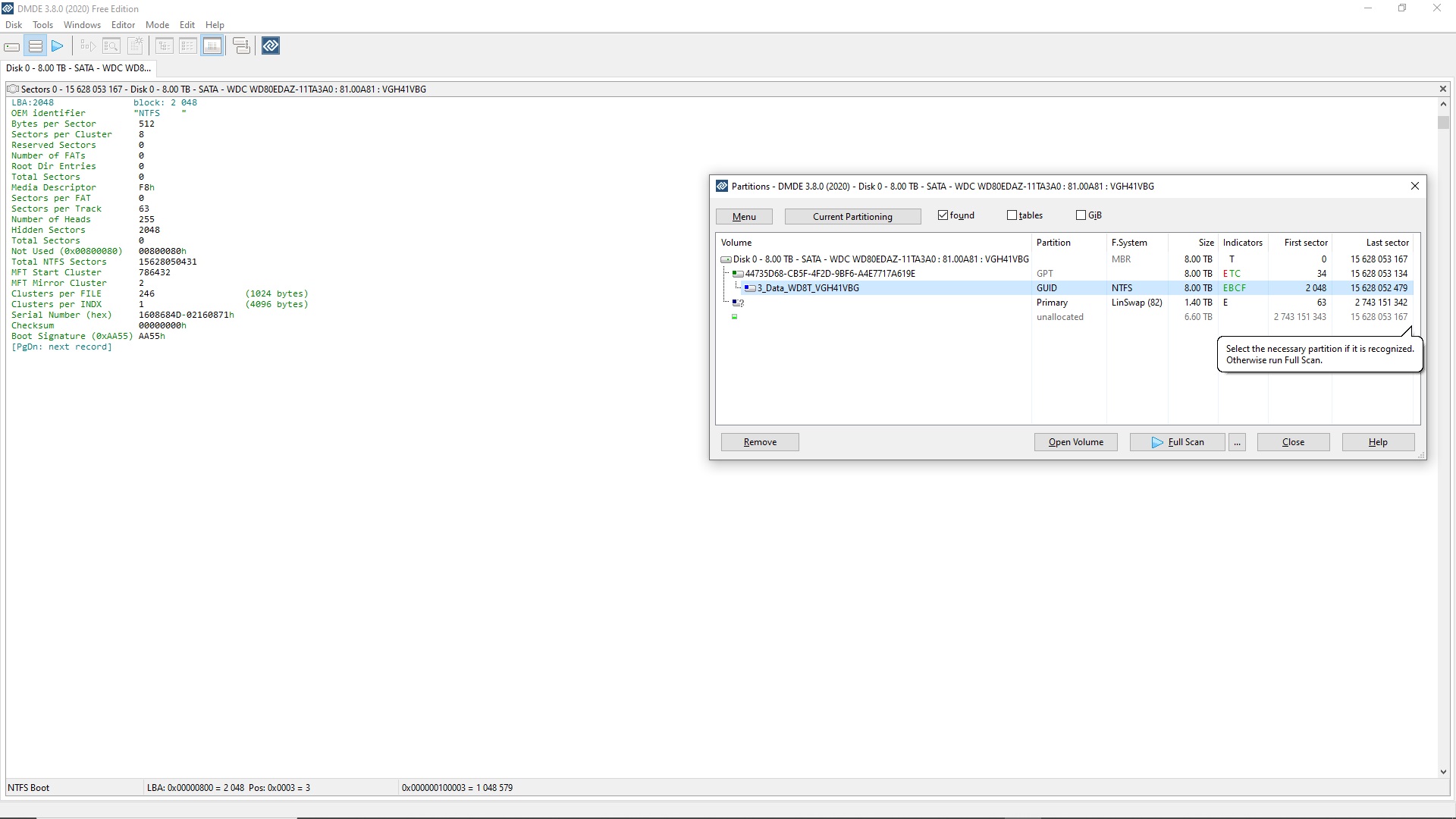

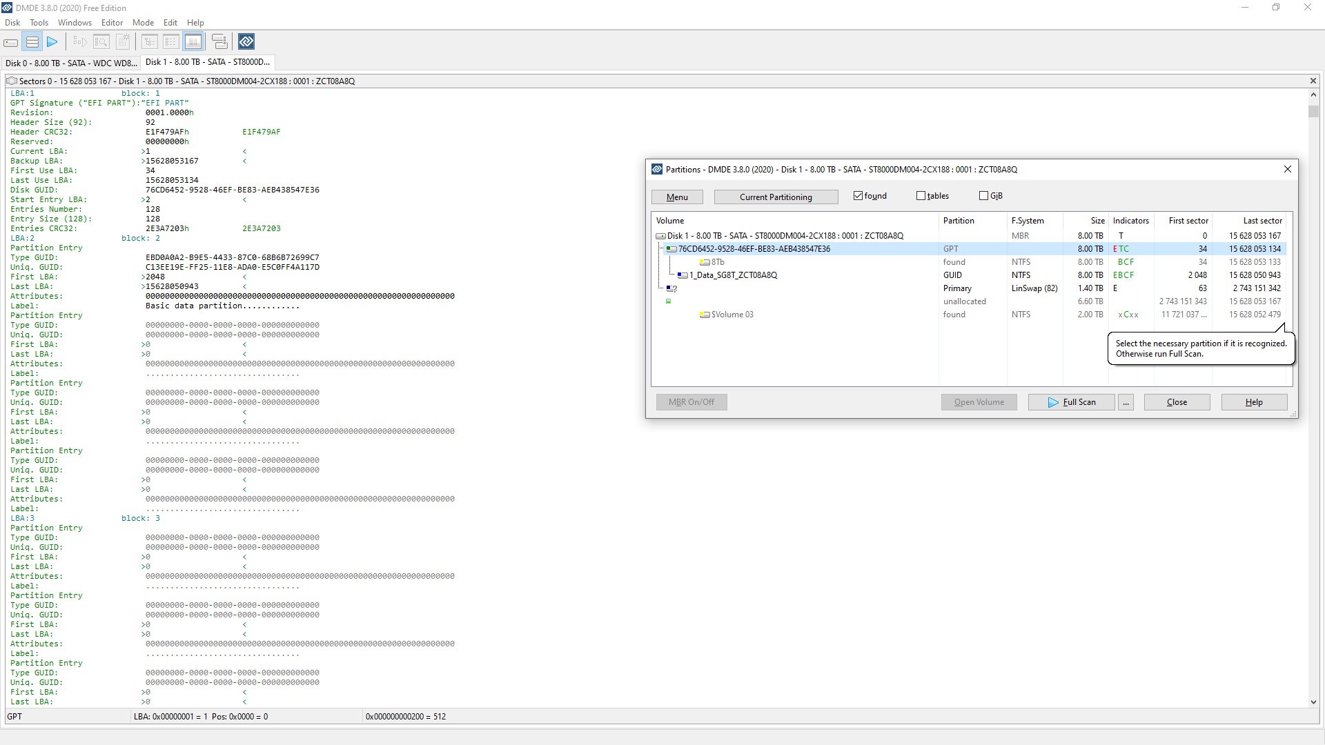

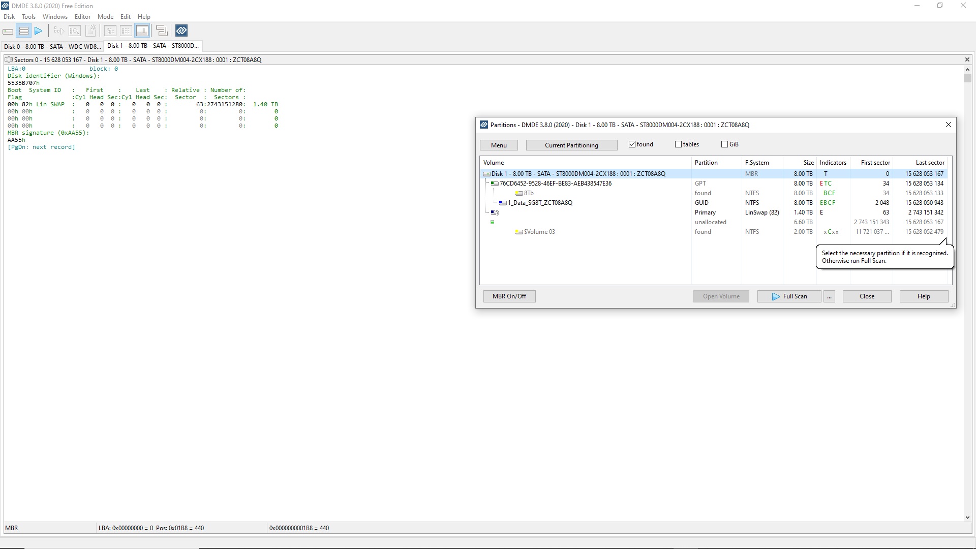

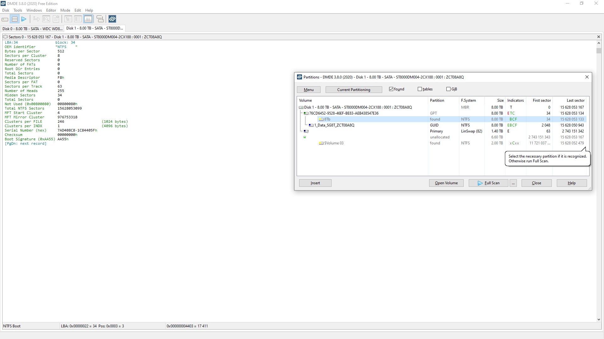

Attached are the screenshots for Disk 1.
File comment: Layer 7
File comment: Layer 4
File comment: Layer 1

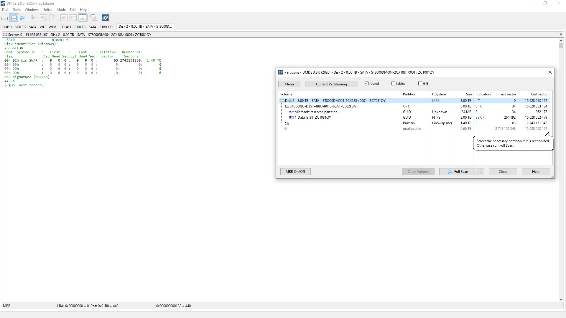

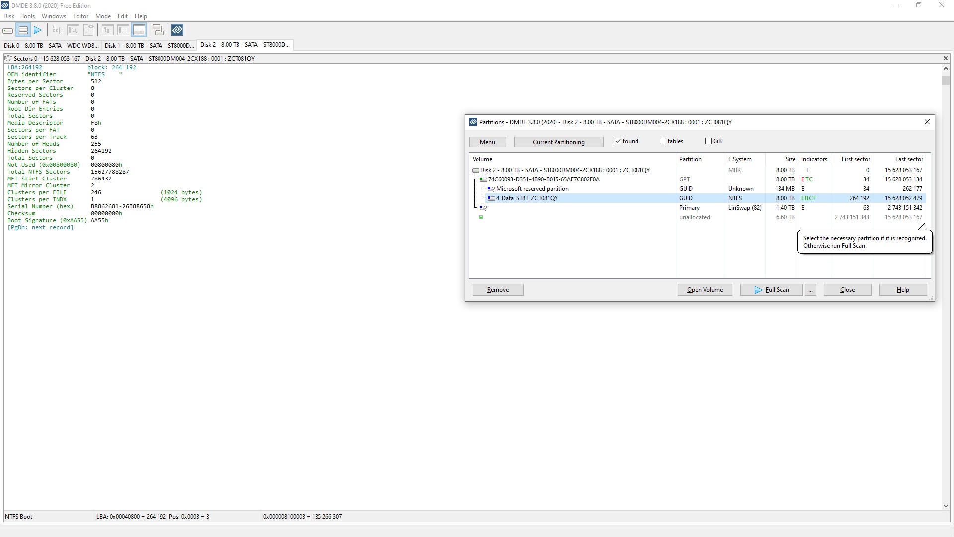

Attached are the screenshots for Disk 2.

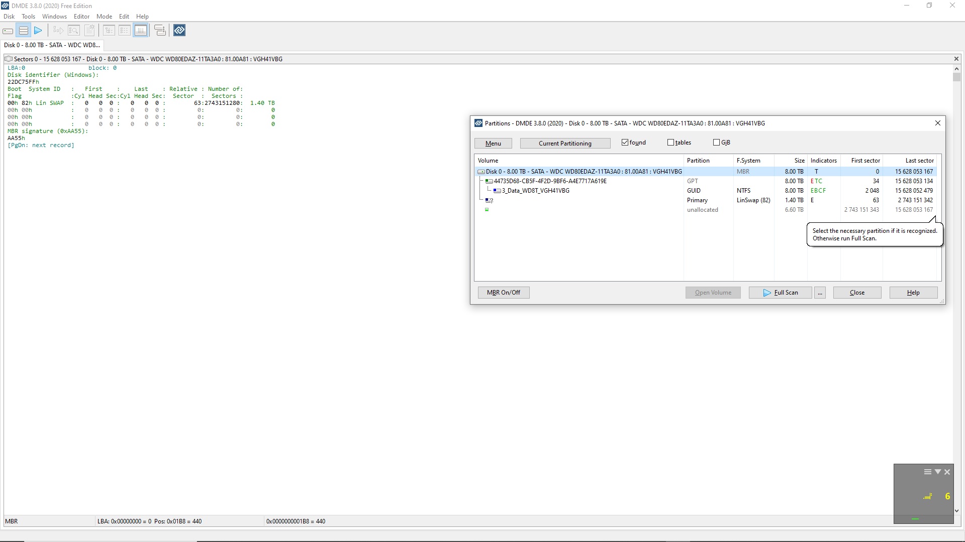

(This is another attempt at answering to Fzabkar. I did answer almost immediatly with the requested screenshots but a day and a half later I am not sure whether my answer is still being moderated or if if it somehow failed to post altogether.)
Good day, and thank uou for your time and efforts in helping me.
I am attaching screenshots from DMDE (possibly more than are necessary since I am not sure what information is useful to you). For each disk I took a screenshot of every element in the partition panel that seemed to be associated with synthetic information, but skipped those that only showed the data on the drive in hexadecimal.
Here are the attachment for drive 0.

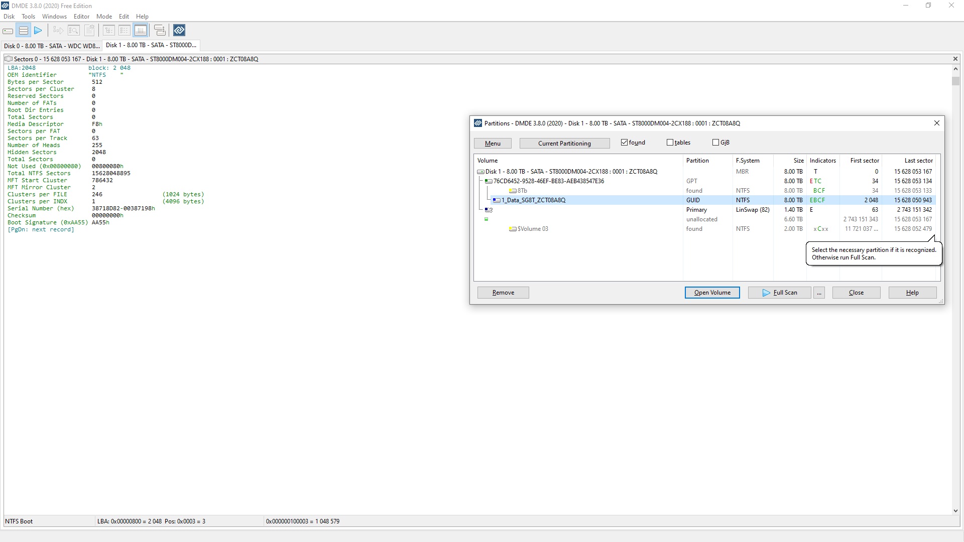

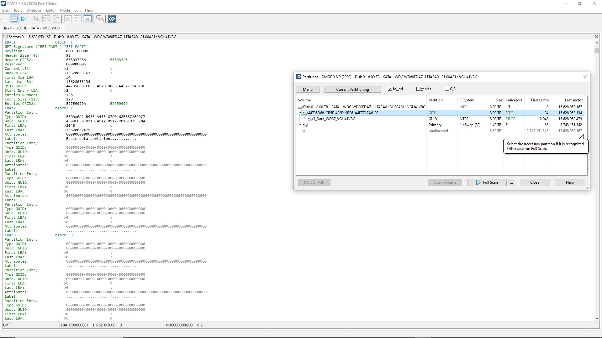

The GPT Protective MBR in sector 0 has been replaced with a standard MBR. Its size is 1.4MB because that is the capacity that an 8TB drive reports when it is facing a 32-bit LBA limit (8TB - 6TiB = 1.4TB).
The solution would be to r-click each LinSwap partition and select "Remove the Partition".
R-click the MBR and select "Toggle MBR/Boot signature on/off".
Then r-click the same line and select "Reset GPT + MBR signatures (GPT On)"
Apply changes and reboot.
These changes only affect sector 0. They do not touch your data.

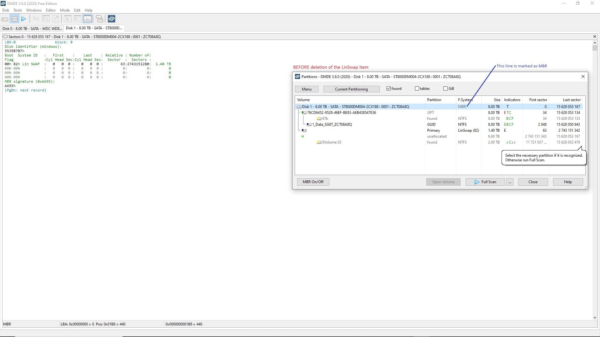

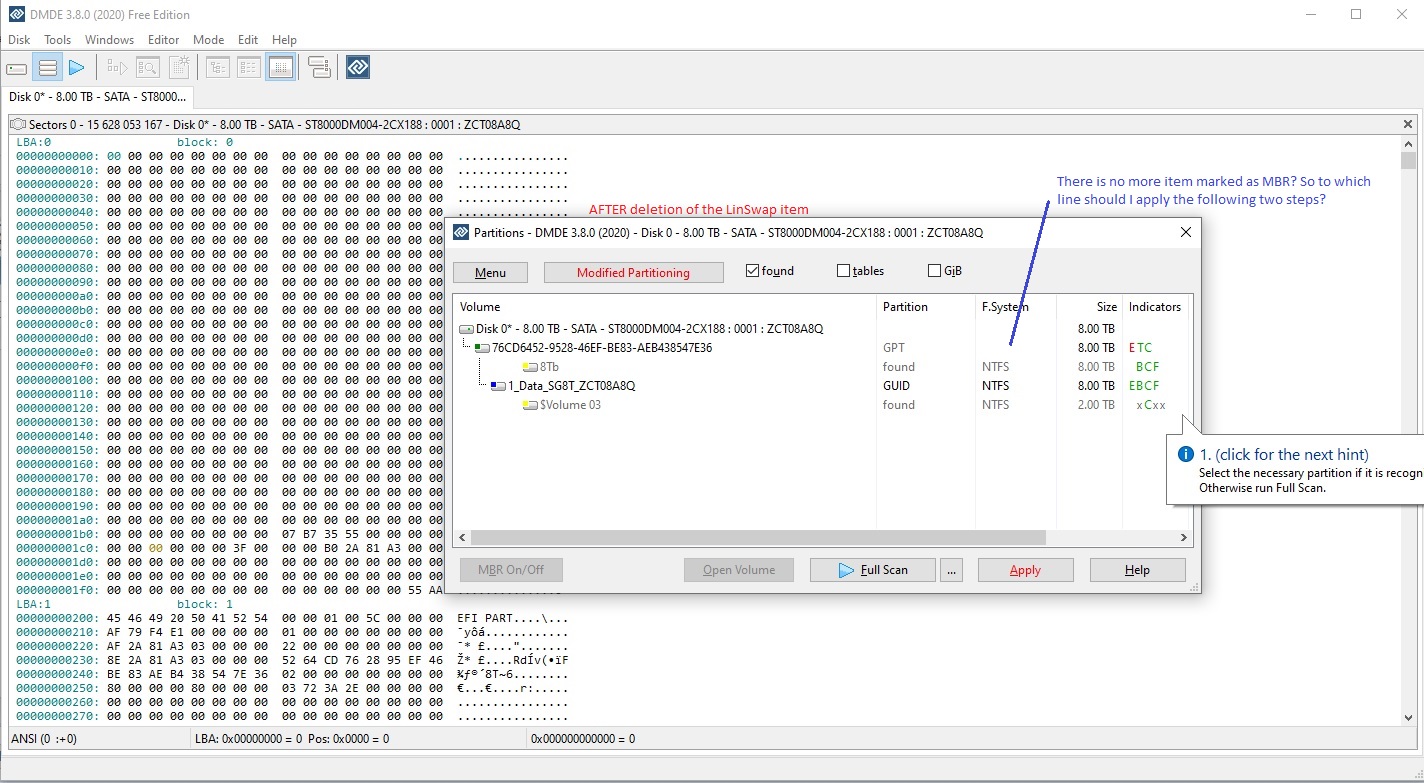

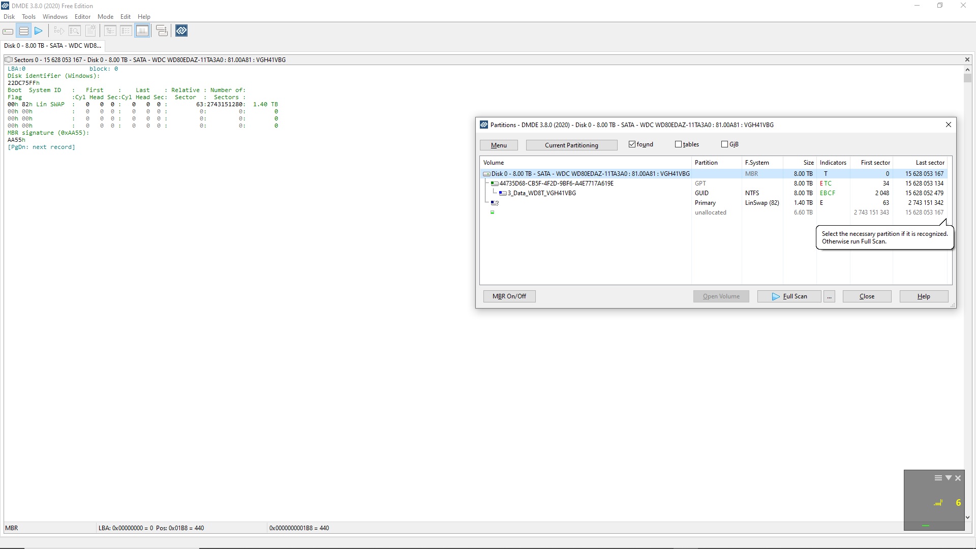

Good day,
Thank you for tour answer. These are extremely good news. Also my apologizes for the redundant posts above, I got a bit confused not seeing my answers displayed.
I would appreciate further guidance as I am afraid to make a mistake.
I started applying your recommendations on Disk1 (sometimes indicated as Disk 0 in the new attachment because I have temporarily un-plugged one of the HDDs).
Step 1: I right-clicked on the LinSwap partition and selected "Remove the Partition"
Step 2: I am blocked at this stage because the only line that showed the mention 'MBR' has now disappeared so I do not know to which item I should apply "Toggle MBR/Boot signature on/off" and "Reset GPT + MBR signatures (GPT On)"?
Also: The line indicating a 2 Tb NTFS (last line of the screenshot) should remain untouched and will disappear after the reboot?
cf. attachment
Thank you in advance
File comment: After LinSwap deletion

PostPosted: March 9th, 2021, 17:08
Posts: 17340
R-click the top line and turn GPT On.

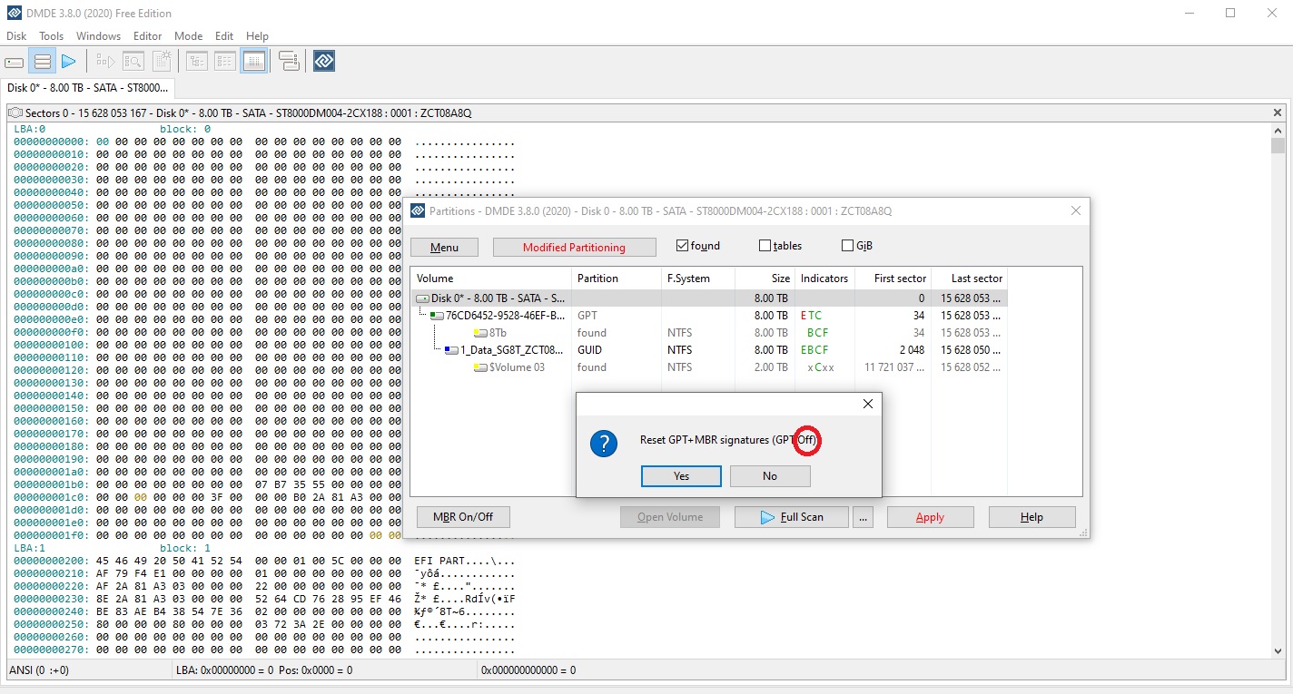

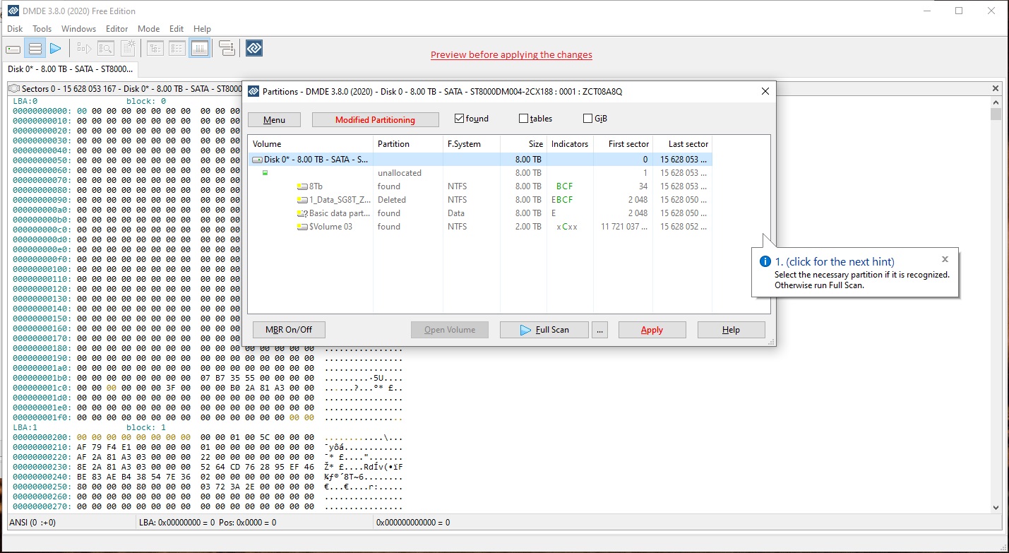

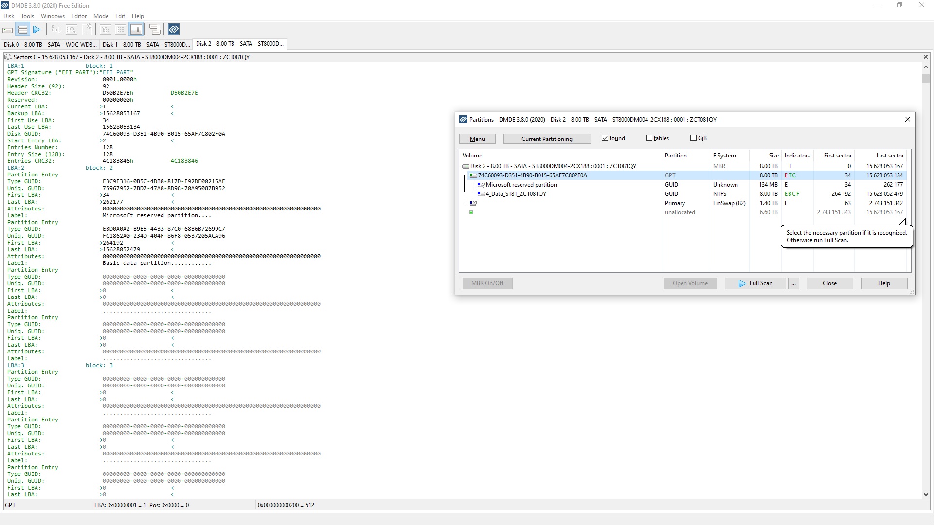

The option only says 'off' is that normal? (cf attachment)
I also attach the preview that I get after accepting the GPT dialog box. Should I accept the changes? The preview still indicates that there remains a volume of 2 TB it seems.
After I understood what to do with this disk I should be able to do the other ones myself.
Thank you.
File comment: preview before applying the changes
File comment: Turn GPT 'off'?

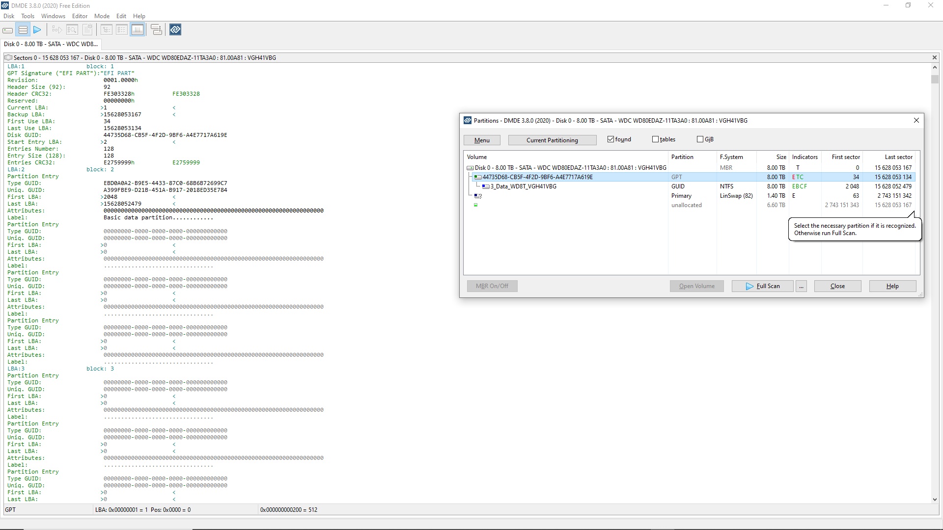

 Post subject: Re: Internal GPT SATA HDDs became MBR, partially unallocated
PostPosted: March 9th, 2021, 18:13
Posts: 17340
It appears that DMDE is not reinstating the protective MBR in LBA 0. You can do this manually by selecting Edit -> Edit Mode, Mode -> Hex/Text and then typing the appropriate numbers into the partition table.
See https://thestarman.pcministry.com/asm/mbr/GPT.htm
Copy the numbers in the last 4 lines, from 01c0 to 01ff, including "55 AA".
By turning GPT Off, you have deleted the "EFI PART" text from the header of LBA 1. You now need to repair offsets 200 to 207.
Once you have applied these changes, you should be able to access the data.

"By turning GPT Off, you have deleted the "EFI PART" text from the header of LBA 1."
Let me just clarify: I have not done anything yet. I only previewed the manipulations that you had recommended and then discarded all changes without applying anything.
Anyways, when you say "You now need to repair offsets 200 to 207." is that covered by your instructions about copying the values from 01c0 to 01ff, or does that involve yet another step?
Thank you
PostPosted: March 9th, 2021, 18:43
Posts: 17340
If the "EFI PART" signature is still present, then nothing needs to be repaired at offsets 200 - 207.
You only need to make changes to LBA 0.

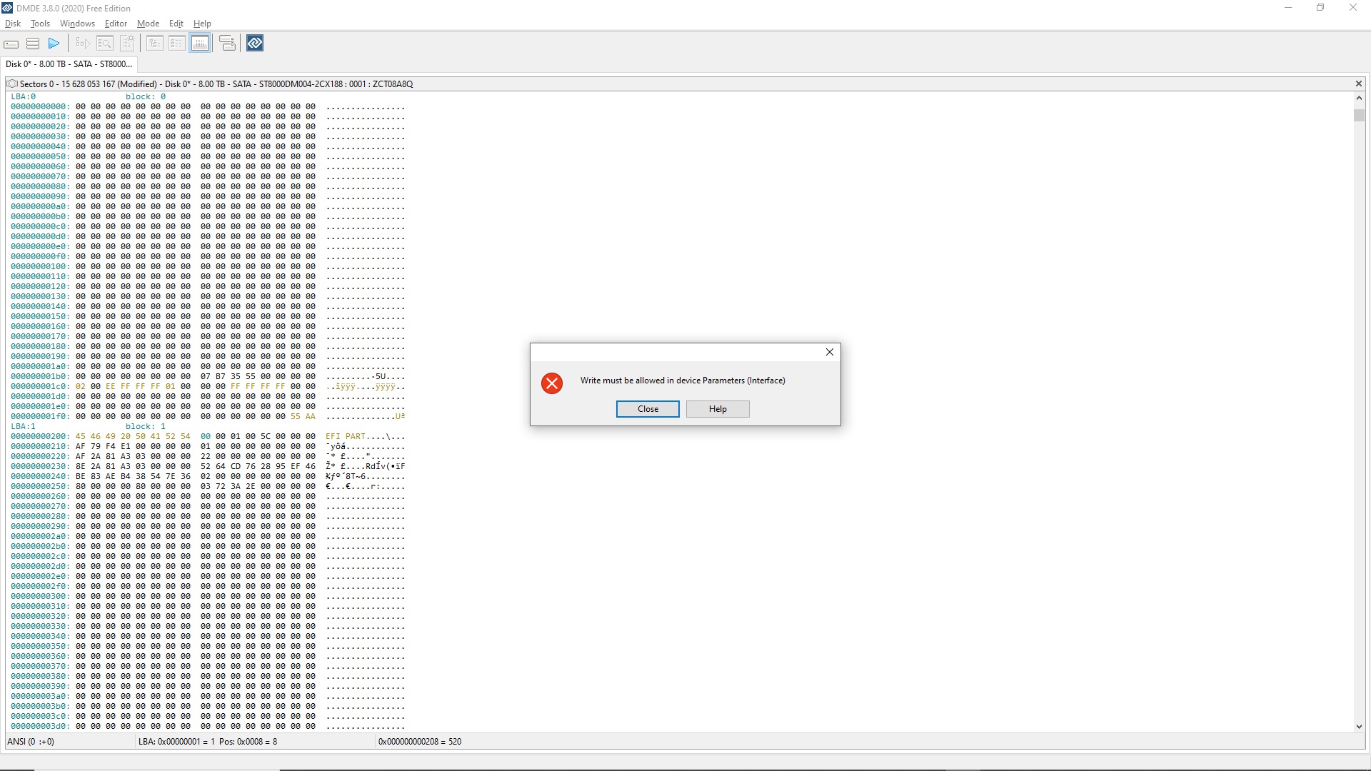

When I click 'Apply changes' I get 'Write must be allowed in device parameters' (cf. attachment).
How do I do that?
Thank you

Sorry, the new version has added an extra safety check:
    Disk -> Device I/O Parameters -> Interface -> Allow Write
    Disk -> Apply Changes
