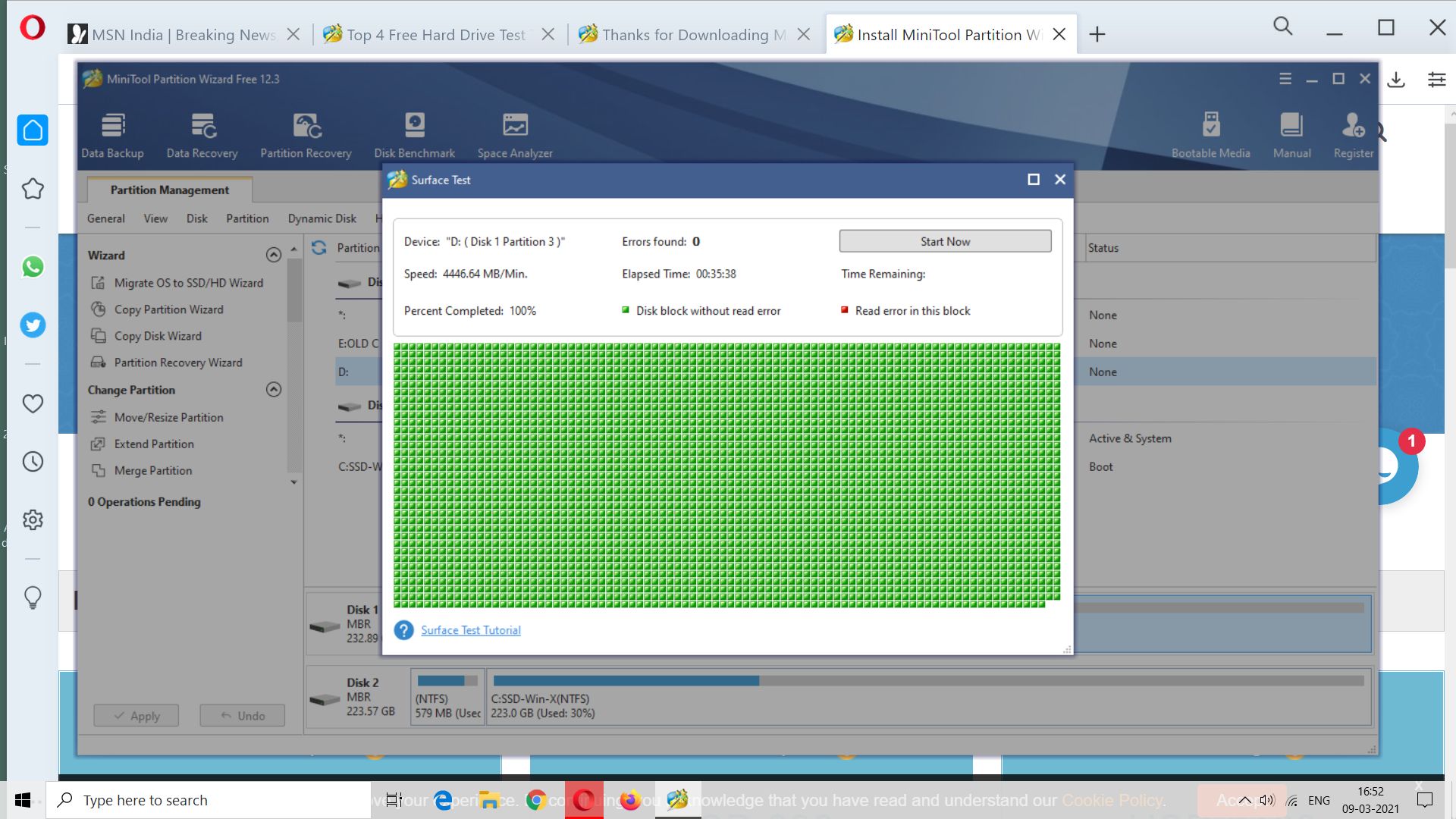

Have an HDD (NTFS) with two partitions D and E.
Partition D was showing some issue.
So first, it was checked with
SeaTools.
Result:
SMART - Pass
Short Drive Self Test DST - Fail
Short Generic - Pass
Long Generic - Fail
Then:
Windows, Tools scan : No errors found
Then:
EASUS Partition Manager : No errors
Then:
Minitool Partition : NO errors, (see attachment)
Can I get advice on what exactly could be the issue considering the SeaTools DST fail and Long Generic Failure.
thanks.
p.s. am a user with not much technical knowledge
File comment: Minitool Partition analysis result

Can you show us a SMART report with a tool such as CrystalDiskInfo?
If you need your data, use a tool such as HDDSuperClone to clone your drive.

SeaTools cannot be trusted. It will tell you that a drive is OK even it has several thousand reallocated sectors.
