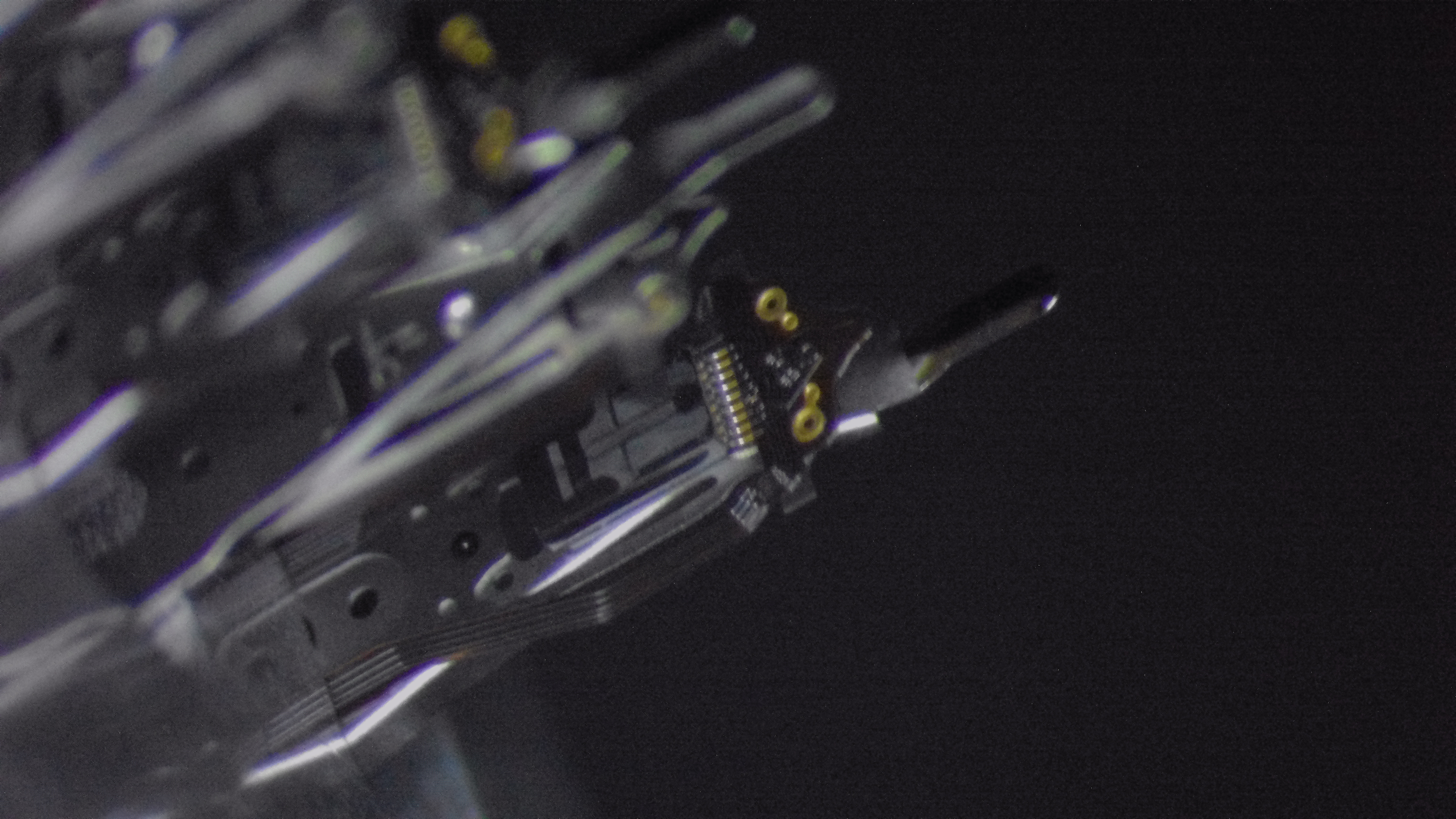

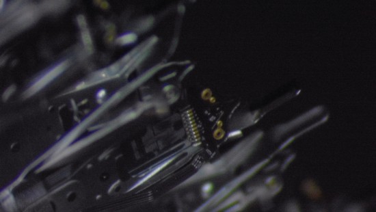

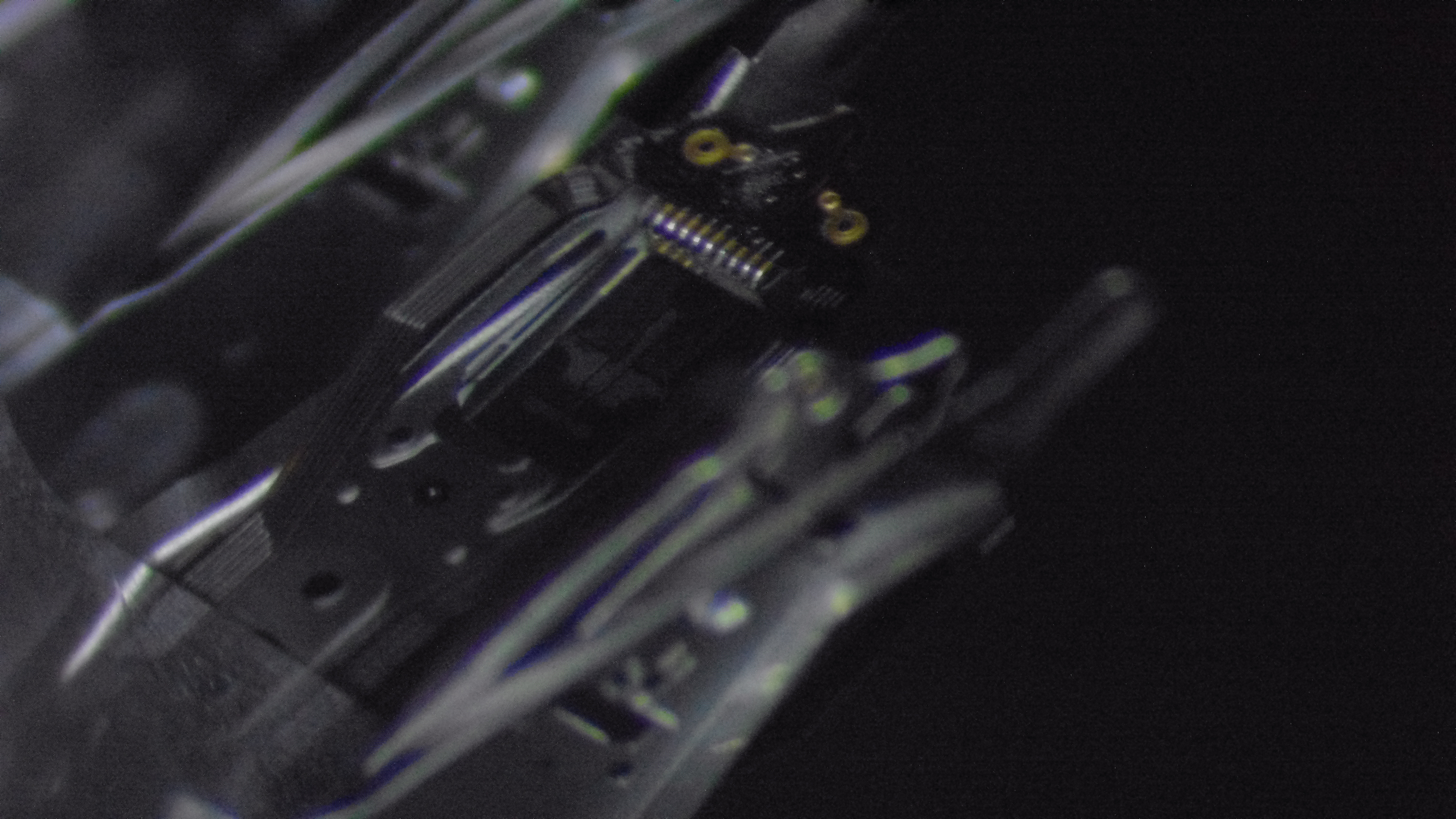

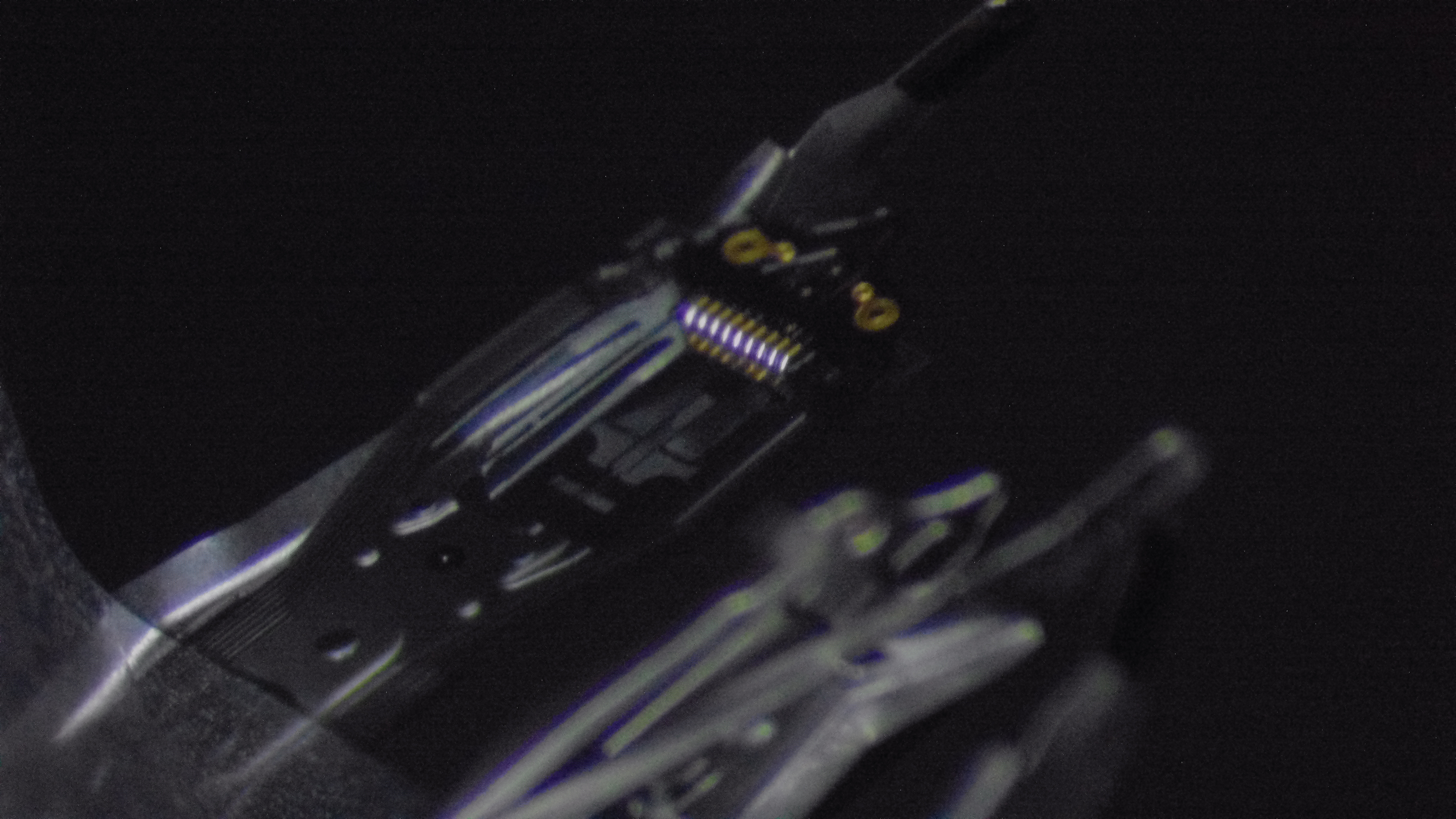

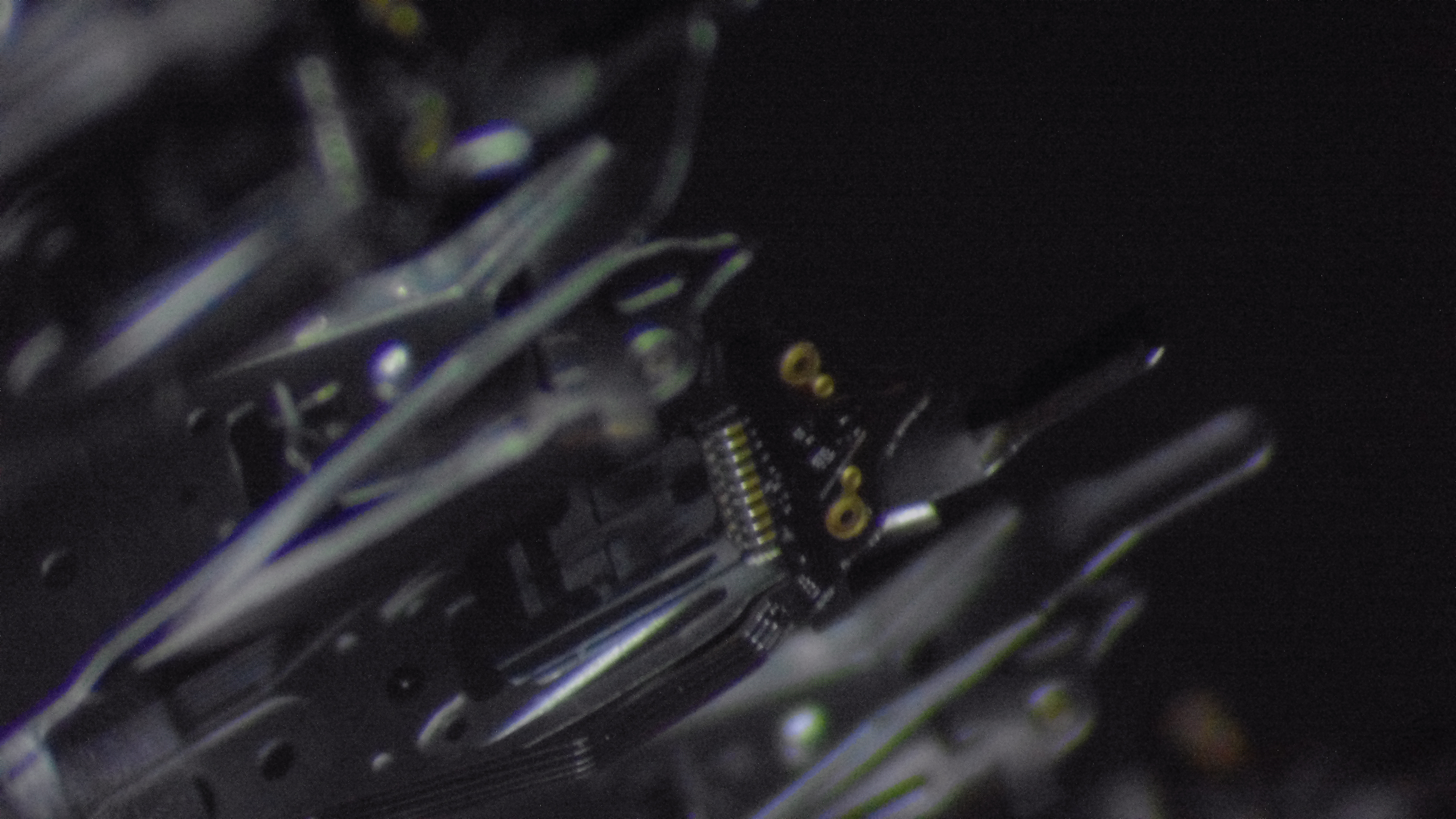

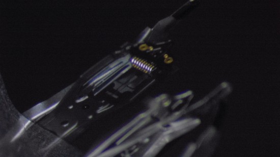

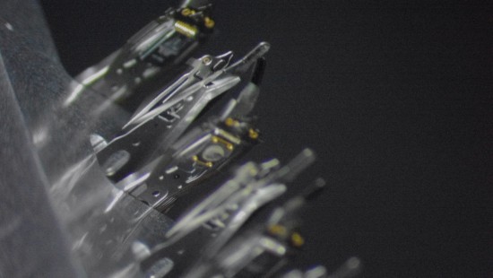

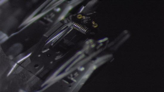

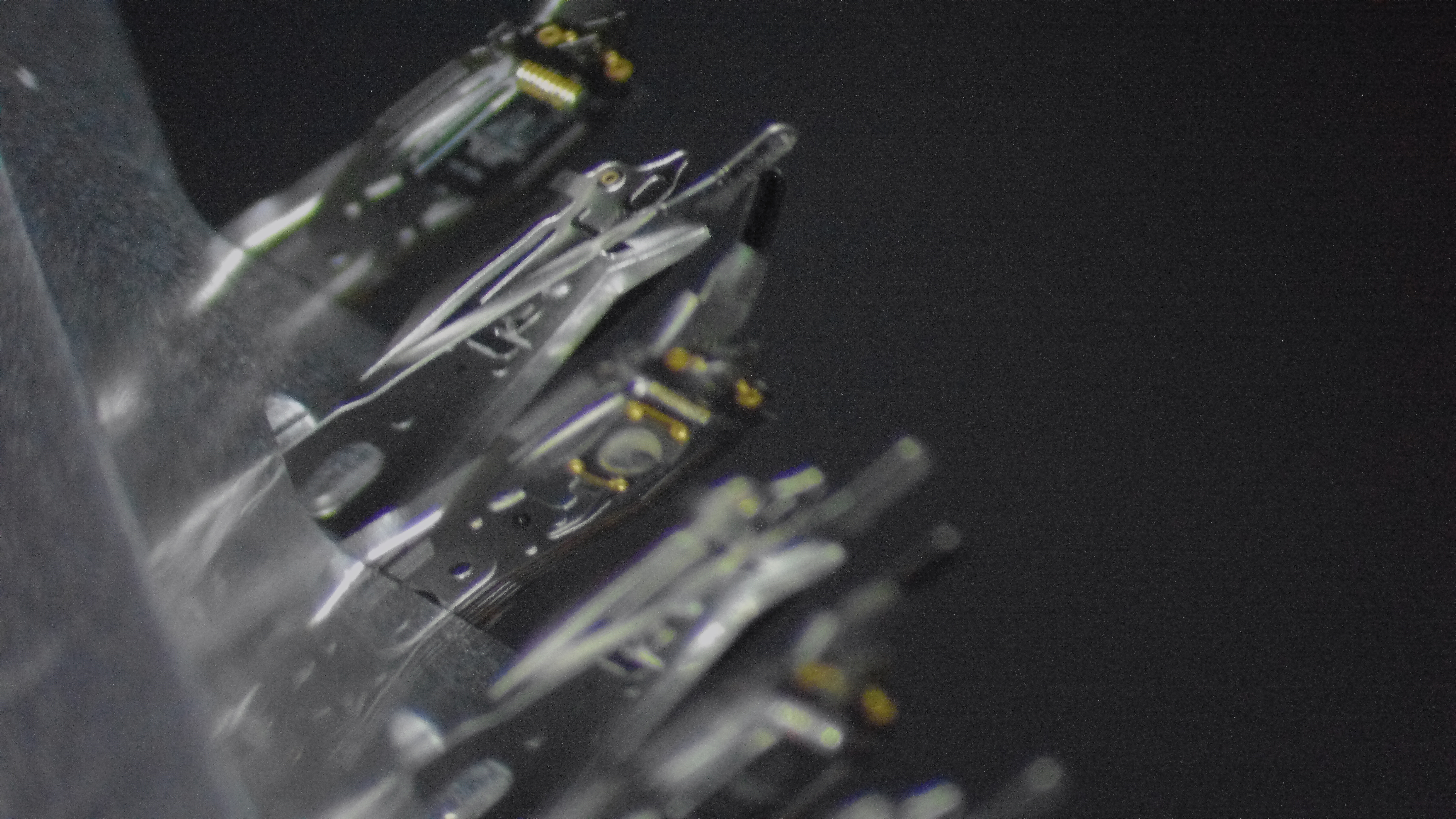

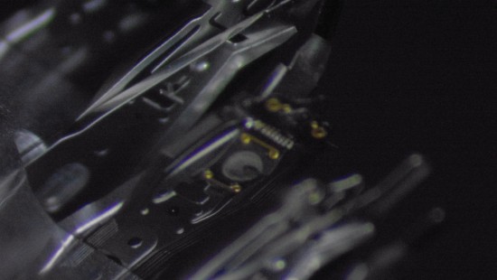

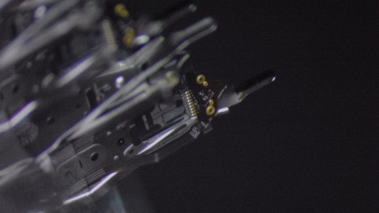

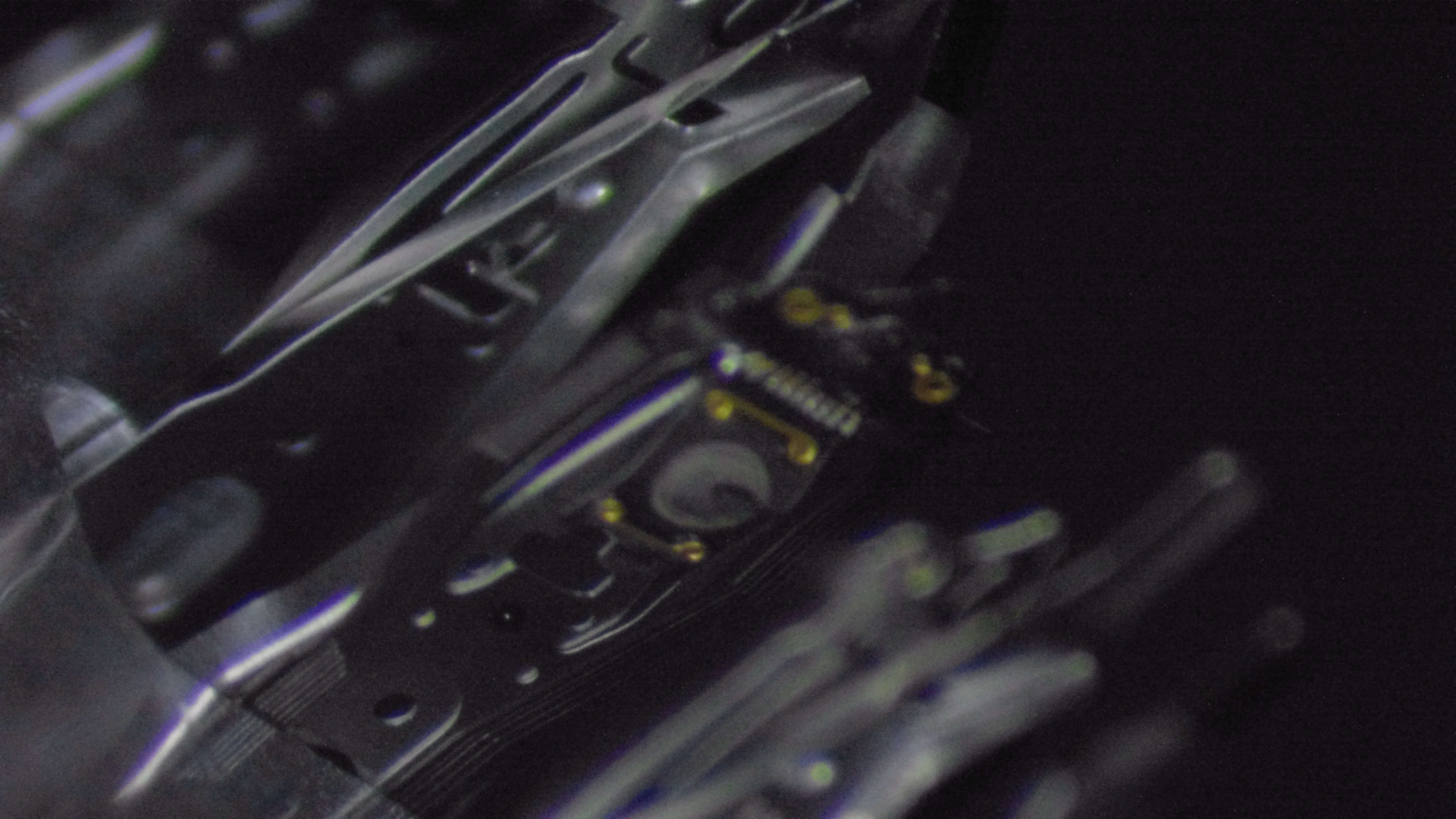

Hi Gurus,
Does anyone have experience in cleaning platters from this model?
Heads have some contamination and one is missing, however I'm not sure how critical is alignment on this model, therefore I'm looking for some guidance :)
Some photos:
 Post subject: Re: ST3000VN000- Platter alignment (Bacall) 4 Platters - 8 H
PostPosted: March 13th, 2021, 4:30
Posts: 3551
If I remember right, these are sensitive to alignment.
Anyhow, to me this kind of contamination + missing slider (ergo, impact), I wouldn't expect much from this project... :(
Thank you., I'll report back to client and if he wishes I'll try to clean them marked with a sharpie :D
