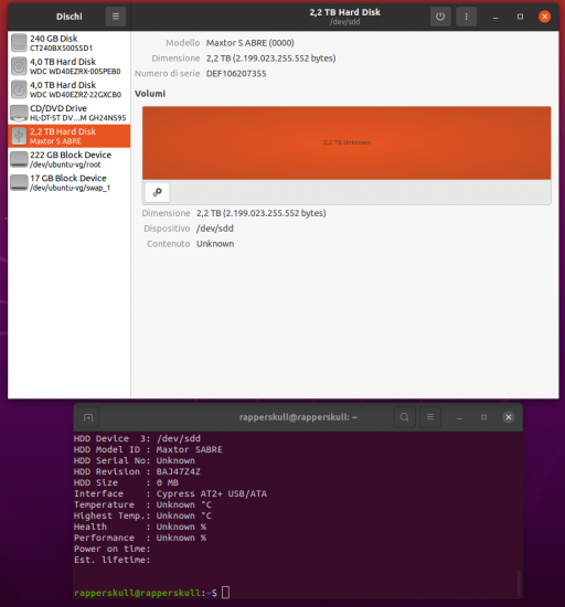

Forget about it, just realized my only internal IDE adapter has a PCI connector. However I tried with another enclosure, this time on a Ubuntu PC. Both show the exact same thing. The output of the terminal is from HDSentinel.

If there is any unstable issue with your PC or adapters then this would mean that hdd fw is not loaded properly.
FW modules are corrupt or can't be properly read due to bad head.
Without professional tools can't be fixed.

As the drive is showing Sabre as the family name and there is no detected serial no. I would suspect the firmware has suffered some damage.
A pro should be able to repair it quickly and cheaply.
The diy repair possibilities are out there but are extremely dangerous and risky to carry out as a good understanding of Maxtor firmware and the free tools would be required. Data is likely to go up in smoke with one or two mouse clicks.
