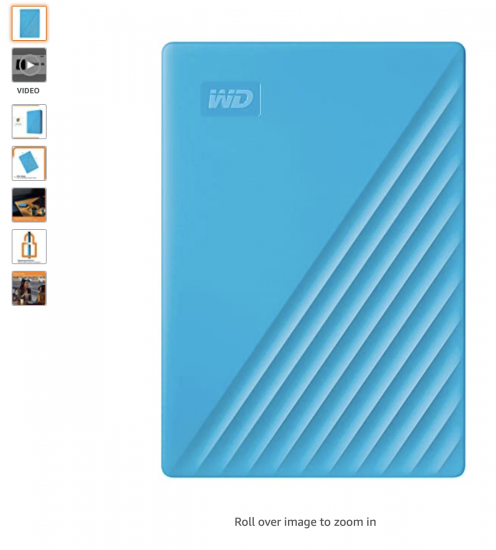

This is Claire here. Would just like to start out by saying that I am not involved in the recovery business in any way, and so I apologise if this is the wrong place for a layperson like me to be posting. I see that most posts here and from and for technically knowledgable folks from within the highly intricate world of data recovery, but I am at a loss in a particular situation and my lack of knowledge is the very reason I am here, so would greatly appreciate someone helping me out. I am describing my current conundrum below.
I am a photographer who had data lost in an external Hard Disc due to water damage in my office in May of 2020. I did have a backup, but unfortunately, made the cardinal sin of keeping it in the same physical room, and hence both copies were damaged - one more than the other. While one HD was completely beyond help since it was in a low storage unit, the other was kept on a desk and was only partially in water. Both were external Hard Discs.
MODEL NAME - Western Digital 4TB My Passport Portable External Hard Drive, Blue - with Automatic Backup, 256Bit AES Hardware Encryption & Software Protection purchased in FEBRUARY of 2020 (attaching a screenshot of image of HD)
I immediately contacted a recovery team which asked me to send over the disc, which I did. They took a few days to run tests etc, then gave me a two month timeline for recovery. It has now been nearly a year and all I have received from then on have been more timelines saying that the data is all secure and there, just that there is an issue with the decryption. I have left the disc with them since I know one thing about such situations - the more hands it goes into, the more chances of something going wrong. I don't want to take it to a team to tinker with something, then say they can't help, then go back to the original guys and for them to say "well the other team has done something we can't fix now". This is where the matter rests.
I apologize for the long post but I will try and get to the point
All I want is for someone with technical knowledge in the field to help me, by just deciphering the technical jargon and PLEASE just letting me know - am I being led on or is there any legitimacy to what these guys are saying?
Without making this any longer, I will try and attach as much informational stuff as and quote their emails to me below.

File comment: The External Hard Disc in question.
