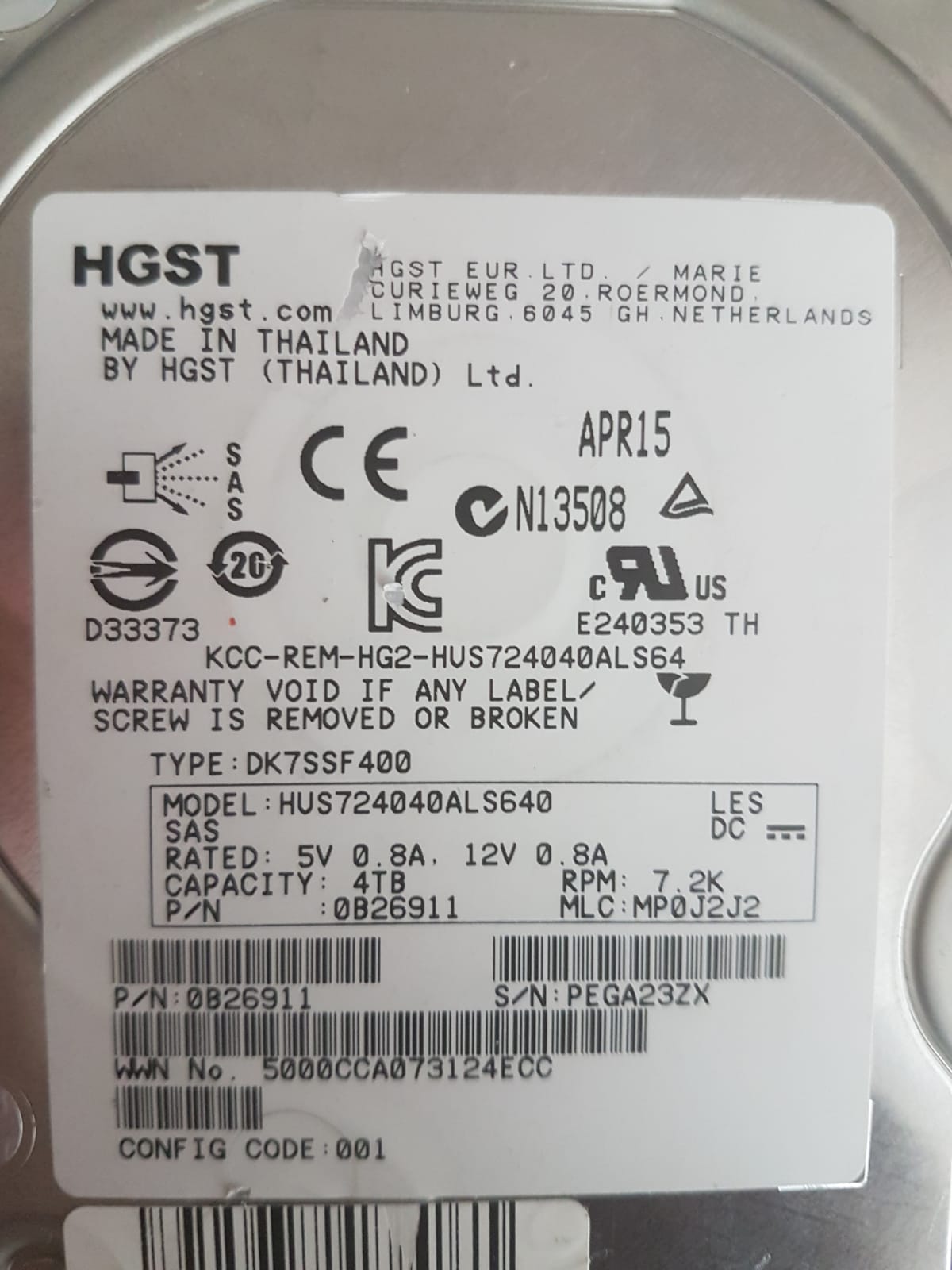

Hi there,
I have bought two used 4TB HGST HUS724040ALS640 and two 2TB HGST HUS724020ALS640 drives for a Dell R420 with H310 LSI controller.
The 2TB drives are working ok, but the 4TB drives aren't working at all. No matter what I try I just can't use them. A customer service guy told me that the 4TB drives have a different firmware and I can only use them with the LSI Logic controllers. Unfortunately returning the drives is not possible.
I seems strange for me, or maybe it isn't, that this drives are labeled HGST but smartctl says they are HITACHI. Does anybody knows if I can change this drives firmware to an "original" HGST firmware, like the 2TB drives?
Thanks!
lsscsi -sig
[0:0:0:0]    disk    HGST     HUS724020ALS640  A280  /dev/sda   35000cca028639d38  /dev/sg0   2.00TB
[0:0:1:0]    disk    HGST     HUS724020ALS640  A280  /dev/sdb   35000cca02864c518  /dev/sg1   2.00TB
[0:0:2:0]    disk    HITACHI  DKW2E-H4R0SS     ABAB  /dev/sdc   35000cca0730b2368  /dev/sg2   4.00TB
[0:0:3:0]    disk    HITACHI  DKW2E-H4R0SS     ABAB  /dev/sdd   35000cca073124ecc  /dev/sg3   4.00TB
 Post subject: Re: HGST HUS724040ALS640 firmware
PostPosted: March 25th, 2021, 21:39
HGST stands for Hitachi Group Storage Technologies or something like that.
So, it is a Hitachi drive.
