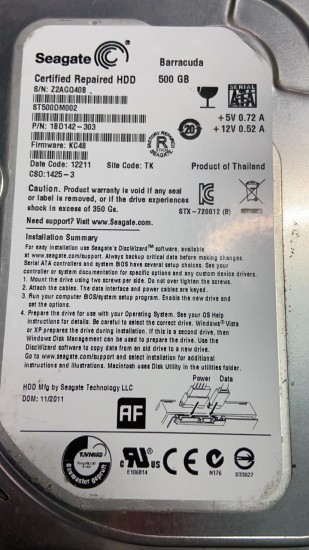

hello...
i have a hard disk when plug in no annoying sound from it normal hdd sound and not detected in windows. it has a problem in terminal program.
MCMTFileHandler: EXCEPTION: Failed MCMT read request
MCMTFileHandler: EXCEPTION: Failed MCMT read request.
i searched this error on google and find out that system file 346 when currupt than this error coming on terminal. when I read system file 346 on terminal this error coming.
Rst 0x10M
MC Internal LPC Process
Spin Up
(P) SATA Reset
ASCII Diag mode
F3 T>
e c r = 0 0 1
e c r = 0 1 0
e c r = 0 1 1
e c r = 1 0 0
e c r = 1 0 1
e c r = 1 1 0
F3 T>r346
r346
RW cmd 0002 req = D4 8A 00 00 80 01 00 00 00 00 00 00 00 C0 04 00 FF 7F 05 00 00 C0 04 00
opts = 00002241
RW cmd 0002 req = 54 8C 00 00 00 01 00 00 00 00 00 00 00 80 05 00 FF FF 05 00 00 80 05 00
opts = 00002241
RW cmd 0027 req = E0 CD 1C 06 EC CD 1C 06 00 00 00 94 00 00 00 00 45 00 01 82 12 48 10 08
opts = 00002241
opts = 00002241
opts = 00002241
opts = 00002241
RW cmd 0002 req = 51 D9 01 00 40 00 00 00 00 00 00 00 00 2E 09 00 FF 51 09 00 00 2E 09 00
opts = 00002241
RW Err = 43110081
RW cmd 0002 req = 51 D9 01 00 01 00 00 00 00 00 00 00 00 2E 09 00 FF 51 09 00 00 2E 09 00
opts = 00002241
RW Err = 43110081
DiagError 0000000E
F3 T>
i need good sys file 346. can anybody solve my problem?
Hard disk detail:
Spin Up
(P) SATA Reset
ASCII Diag mode
F3 T>
PH0G + 4K + MC + TWM,RAP16,Common Code 4, QNC
Product FamilyId: 3F, MemberId: 05
HDA SN: Z2AGQ40B, RPM: 7201, Wedges: 120, Heads: 2, Lbas: 0000075D672F, PreampType: 73 23
PCBA SN: 0000721755J5, Controller: YETIST_3_*/4_0(64A1)(3-12-4-1), Channel: AGERE_COPPERHEAD_LITE, PowerAsic: MCKINLEY DESKTOP LITE Rev 94, BufferBytes: 1000000
Package Version: PH0X2D.CCD4.KS0LCB.KC48 , Package P/N: 100723930, Package Global ID: 00446535,
Package Build Date: 02/13/2013, Package Build Time: 11:28:15, Package CFW Version: PH0X.CCD4.00532337.00446535,
Package SFW1 Version: D292, Package SFW2 Version: ----, Package SFW3 Version: ----, Package SFW4 Version: ----
Controller FW Rev: 02131128, CustomerRel: KC48, Changelist: 00532337, ProdType: PH0X.CCD4, Date: 02/13/2013, Time: 112815, UserId: 00446535
Servo FW Rev: D292
RAP FW Implementation Key: 10, Format Rev: 0001, Contents Rev: A1 0A 1B 03
Features:
- Quadradic Equation AFH enabled
- VBAR with adjustable zone boundaries enabled
- Volume Based Sparing enabled
- IOEDC enabled
- IOECC disabled
- DERP Read Retries enabled
- LTTC-UDR2 enabled

Update...
I got sys file 346 from my friend and write back to patirnt hdd and voila...all data backup.
thnx for this forum...
