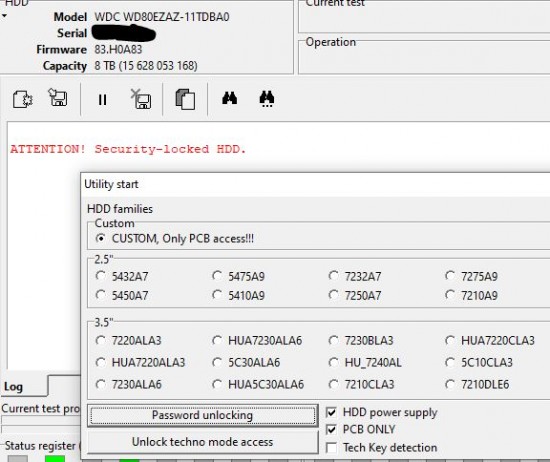

I got this drive today
WDC WD80EZAZ-11TDBA0
83.H0A83
Drive is locked, I have attempted to remove the lock but anything I try has failed, does anyone has a solution for this and is willing to share please?
Thank you

Locked as in read only or totally locked?

br5409 wrote:
Correct, is one of this WestenTachi drives. User got it from e-bay came inside of an enclosure and worked fine inside the enclosure until he took it out to use it as an internal drive, he trashed the enclosure. Drive is empty, he just wants to be able to use it.

SATA pin #3 disables all power to the drive, so nothing will be detected on that SATA port, locked or otherwise.

Drive is spinning and comes ready so PIN #3 is not the issue on this one, the issue is locked and any attempt to unlock it has failed. case close - client is doing and RMA.

I wonder if the drive supports the new ATA Rebuild Assist and remanufacture command sets (head test and depop), and whether these are still accessible in the drive's "locked" state. If so, then HDDSuperClone may be a solution.

Most likely mechanical damage, which is reported as a locked drive.
These are basically unrecoverable.
