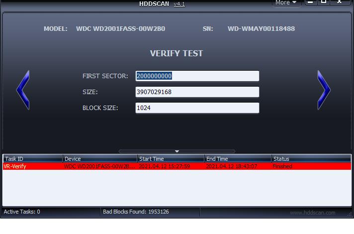

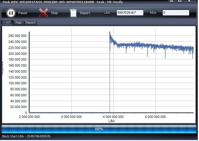

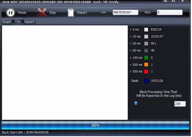

Half a year later:
It seems HDDScan cannot determine the end of the disk and places a continuous bunch of bad sectors beyound its end (during Verify test only, Read and Erase are OK)
Tested on two different computers, cables etc (both XP SP2 X64). No bad or suspected or relocated blocks according to S.M.A.R.T.
