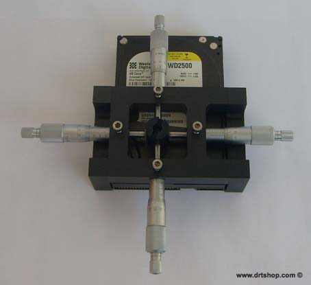

Done testing with my WD alignment jig tool...simple yet effective and i am selling few to cover my expenses :oops:

 Post subject: Re: Western Digital head alignment issue and tools
PostPosted: November 1st, 2010, 17:04
Posts: 1038
Location: South Africa
I see it sells for €984.00
Seeing that it's your tool this might be a stupid question as your answer might be slightly biased :D but how would you rate it's effectiveness - you say it's simple yet effective
DR tools prices are always hard debate in this forum...everyone expect cheap tools and free knowledge. I agree price might be high for some but then again...
Seeing that it's your tool this might be a stupid question as your answer might be slightly biased but how would you rate it's effectiveness - you say it's simple yet effective
It is slightly biased. :) Effectiveness is limited to patiance, but ability to document tried positions gives you the advantage.

Sorry price was wrong it should be 820€, had some problems with tax :oops:
PostPosted: November 2nd, 2010, 11:32
Posts: 791
I have a much simpler solution and costs about 100x less :)
