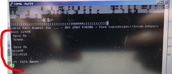

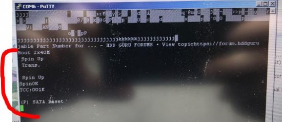

thanks pepe- Im actually getting nothing at all from the serial output of these problem Seagate drives. I have several good/working 3tb seagate drives (drives un-related to the problem drive) , and i used those drives to confirm all is working well with my FTDI serial adaptor setup, photo of that output below.
on the problem seagate drive: I did take a voltage reading of its serial pins, and was seeing only 0.12 dcV on its TX serial pin (as opposed to the normal ~1.7 dcV on a working Seagate TX serial pin)
FWIW - here is output from a good seagate drive i used as a test of my ftdi/serial setup:

you should get some kind of terminal output after swapping the rom chip to the donor pcb. Either a boot terminal or some output from the bootfw should be output...
unless your rom chip is toast and it's shorting Vio to Gnd...
Check with a multimeter in continuity check mode (diode), pin4 -negative (black lead), pin8 - positive (red lead), let us know your reading.

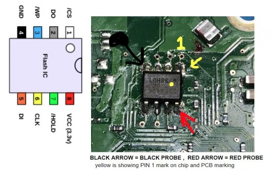

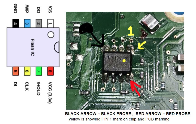

Assuming i have the pin out correct (based upon the pin number in the image attached below, and i can identify pin 1 based upon its DOT on the chip and the DOT on the PCB)
when i measure continuity between pin4 and pin8 of chip - i get ~512 showing on the multimeter (and NO beep / NO continuity sound).
to be clear- i took this measurement, when the PCB was NOT powered up, and while PCB was NOT attached to the HDD body (ofcouse, but i just want to be clear)
I understand.
question 1- so i should get some kind of terminal output even if the PCB is powered up + un-attached to the HDD body?
(there is a always a chance that my FTDI is having issues with the 1.7v output as its set 3.3v, however i did get termnial output from other seagate drives of the same model) -
do note my prior comment above please: on this problem seagate PCB/drive: I did take a voltage reading of its serial pins, and was seeing only 0.12 dcV on its TX serial pin (as opposed to the normal ~1.7 dcV that i see on a working Seagate TX serial pin from which i AM able to get terminal output)

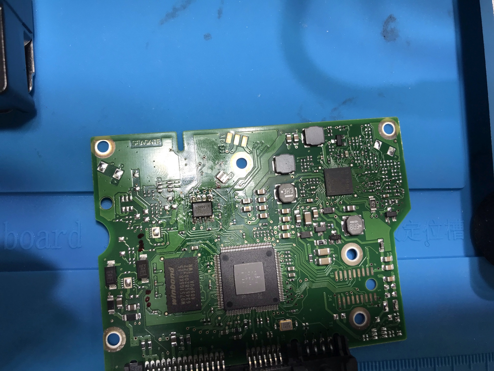

question 2- how can i test Vio to Gnd? (ie which pin # is Vio)? and do i check for it shorting while the pcb is powered up or without power?

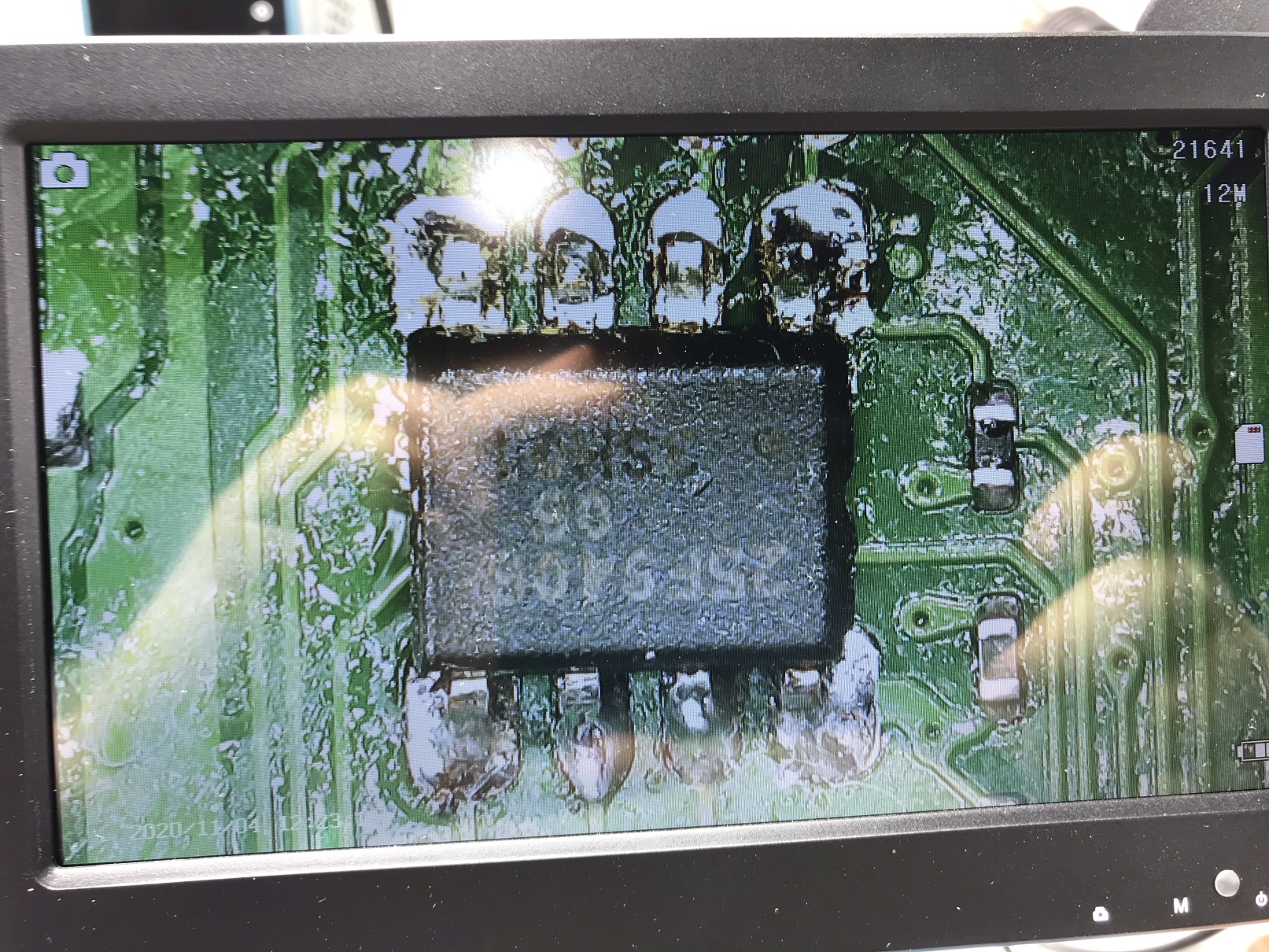

note- i have confirmed that my solder points of the 8pin chip are good, via checking continuity from each of the 8pin chips legs TO corresponding test points on the pcb itself.

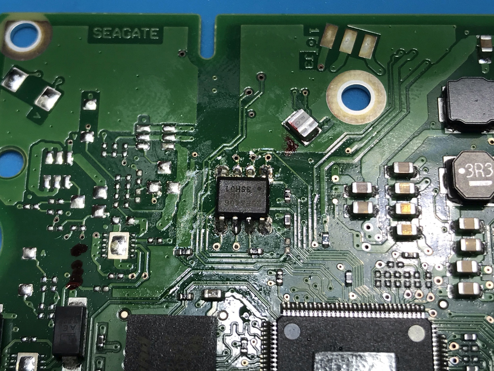

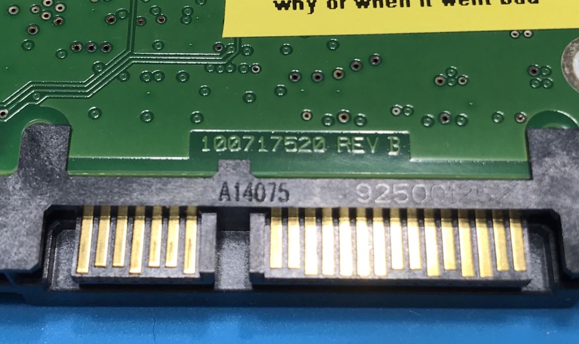

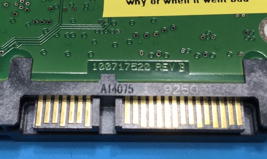

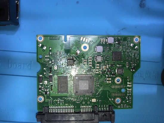

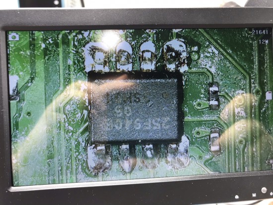

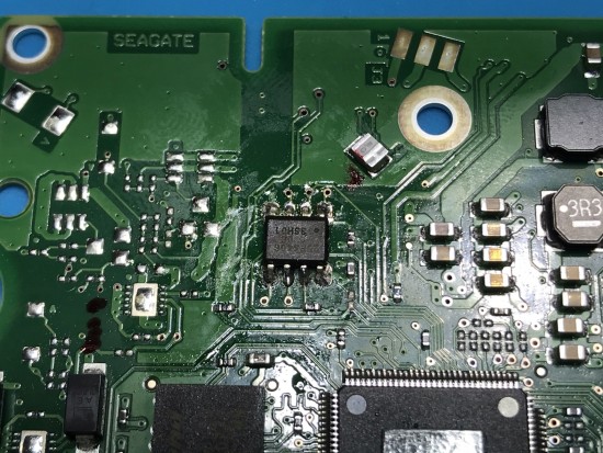

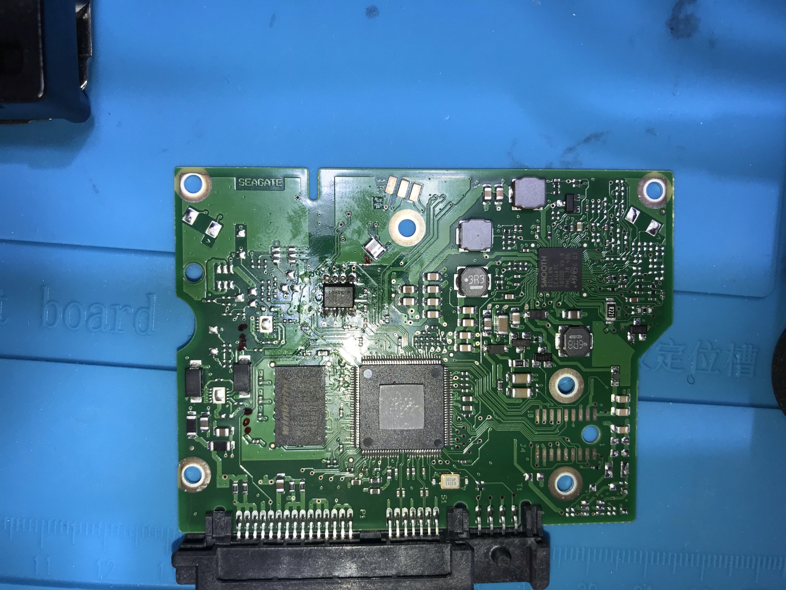

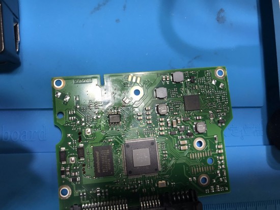

I have also added some photos of the problem PCB board
thank you again

Things look right except the 3.3V ftdi adapter. Can you show what drive did you get terminal output from? (label, pcb)
does the donor pcb work if you restore everything?
Vio for the PCB is the same as the Vcc of the ROM. Test for a short between ROM Vcc (pin #8) and ground (pin #4), with the PCB powered off. If there is no short, then measure the Vcc voltage (with the PCB powered on).
