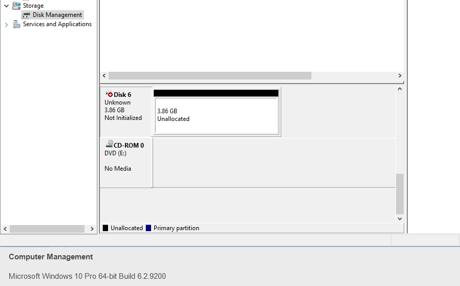

 Post subject: Re: Seagate ext drive not recognised except in Comp Manageme
PostPosted: May 12th, 2021, 21:38
Joined: May 12th, 2021, 12:11
Posts: 5

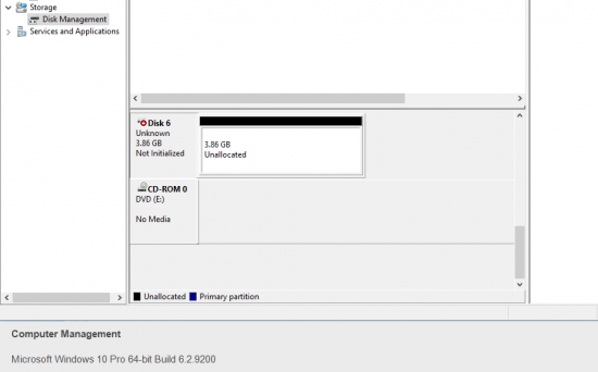

One thing I forgot to add, the Drive is a 2TB, but is showing up as 3.9TB in computer management. This is very strange.
PostPosted: May 13th, 2021, 8:41
Posts: 1322
That looks like 3.86GB not 3.86TB.
Which could be the default values if the drive can not read the SA. What does the computers bios say about the drive? I assume you have it connected directly to the motherboard for testing - if not start there.
Has the drive been making any odd noises, clicking or did this happen after a power event. What's the model number of the drive?

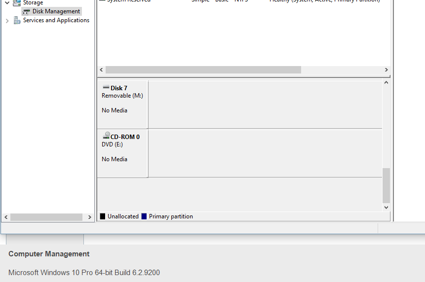

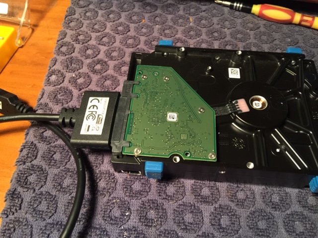

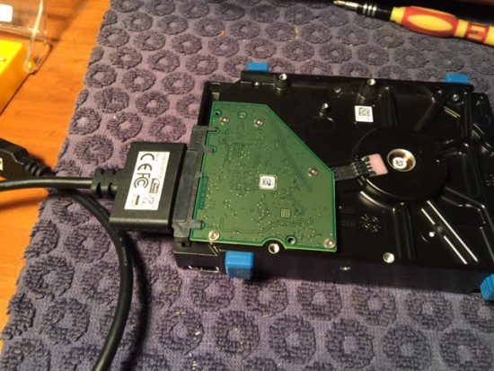

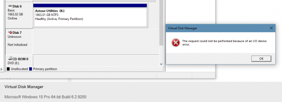

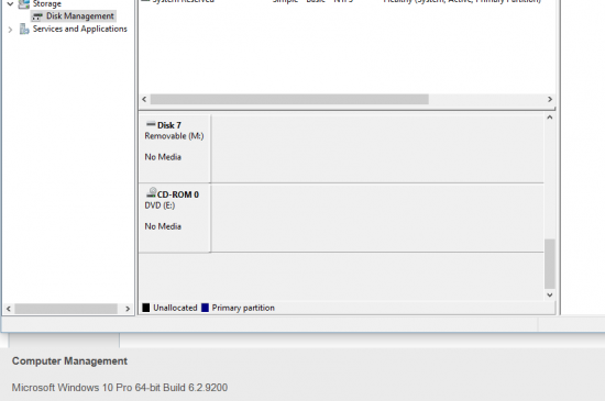

Not sure what you mean by connected to the motherboard, it is not via a hub, but straight into the computer USB 3 port. Today I thought what the hell so I removed the drive from the case and unplugged the interface card and re inserted a sata adapter, plugged back into the computer and still not recognised, but computer management found the drive as disk 7 removable M drive with no media on it..as per capture.

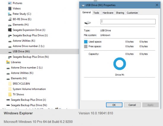

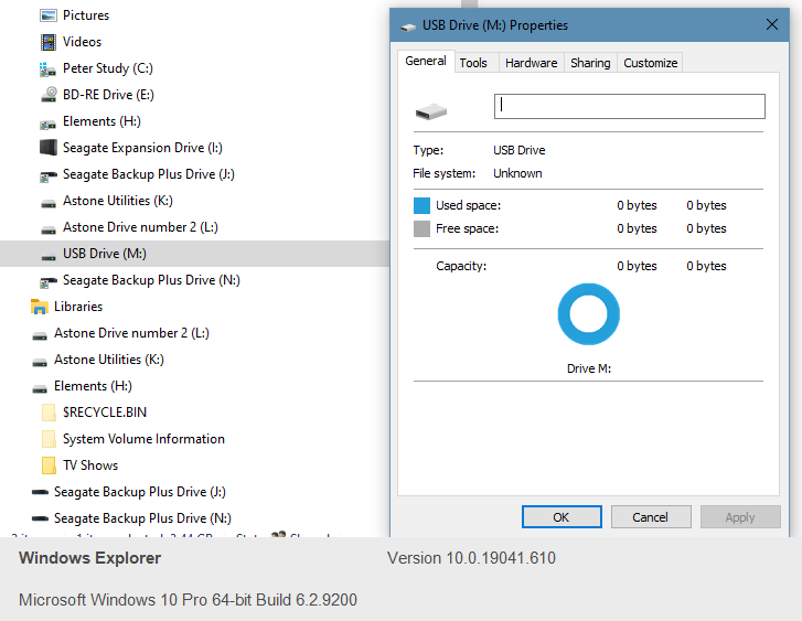

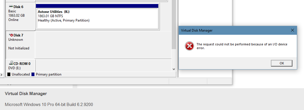

Just another shot showing in Windows explorer it is now recognised as M drive but nothing can be done with it as windows cannot access the drive. If I remove the sata cable and reconnect the original interface I get a totally different result from within Computer management and it does not show up at all in Windows Explorer. It takes forever to come up in Management.

You need to connect the drive to motherboard not via USB, USB can interfere with things. Once connected to the motherboard via sata check your computer bios - does it see the drive and does it report the correct size.
PostPosted: May 13th, 2021, 14:04
That 3.86gb is the default “fake” capacity shown by a failed Seagate F3 drive, just picked up from the PCB.
The drive cannot read from the SA (Service Area) where the firmware is situated, so there’s most likely some physical issues.
There’s absolutely nothing you can do DIY on this, requires a pro. Sorry,

Sometimes connector corrosion making this issue. Try clean PCB to HSA connector. (Rarely bad PCB)
İf nothing change then mostly this is head issue or firmware corruption.

Drive firmware is buggered, the drive will not work in its current state. I had a drive like that, I had to rebuild something, translator or bad sector list. But this wiped the drive clean. I suggest you get a data recovery company to take a look (Not a computer repair shop). I don't think your heads are damaged. More people might help.
