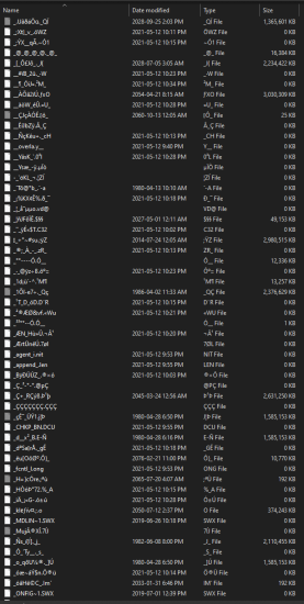

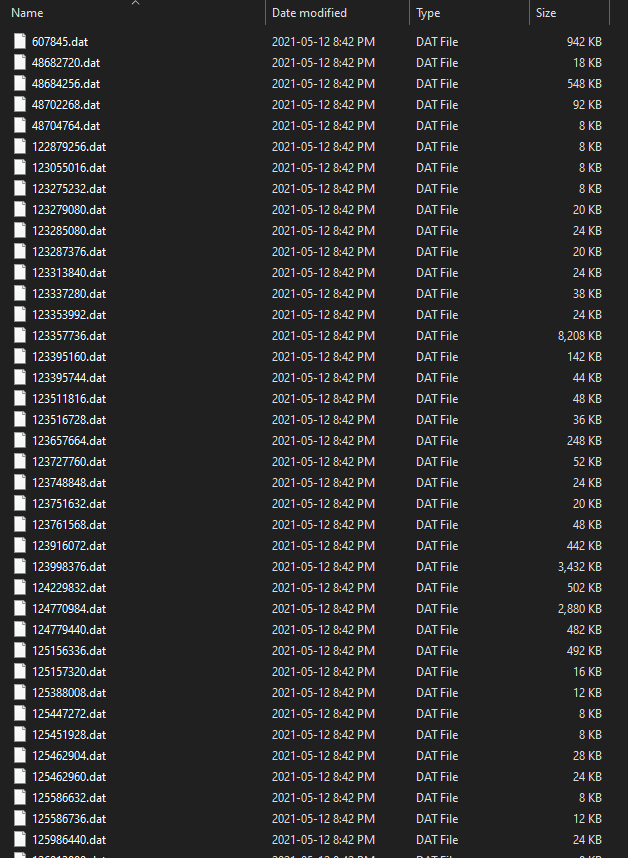

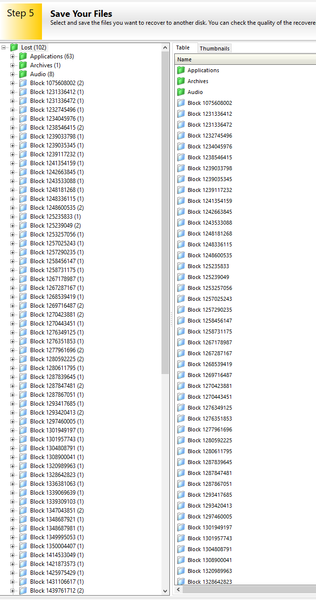

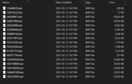

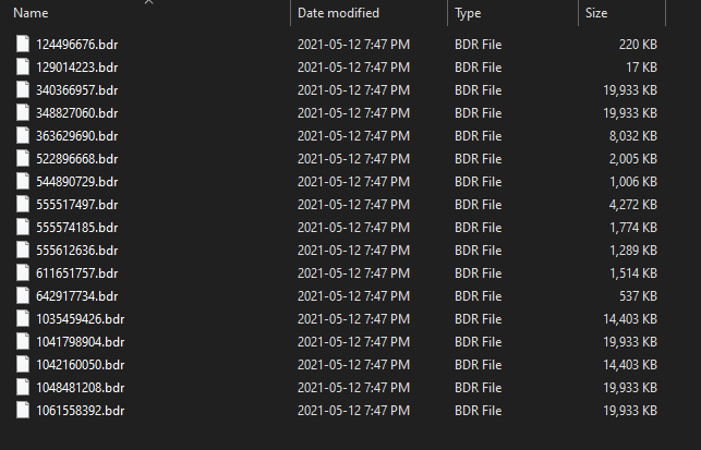

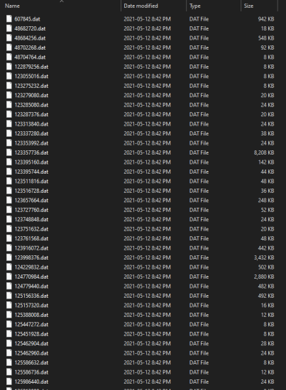

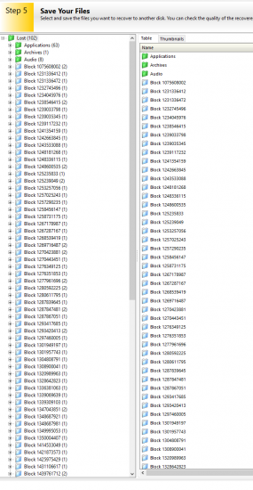

Hi Im trying to recover my data from a HDD and Ive tried many different tool. It seems the data is still there as the file structure still seems to be there but I dont know what to do with it as Im getting strange files and files with extensions I've never seen before. How do I put all these files back together again like Humpty Dumpty? Or is it a real Humpty Dumpty? Here are some screen shots. I appreciate your help!!

What software have you used to do that scan for the files and how did you scan, it looks like a raw scrape.
What was wrong with the drive initially.
What file system is on it.
Was there any encryption involved.
What application have you tried.
What's Make and model of drive.
We need a little more info to give guidance.

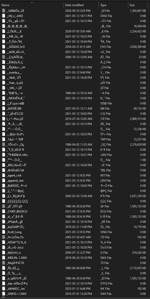

Hi ty for your quick responce, here we go, to your questions.
1. What was wrong with the drive initially.
- nothing but I did transfer all my files from another hard drive a few days before and everything looked good.
2. What file system is on it.
- It is a backup drive and is NTFS
3. Was there any encryption involved.
- No. It may have been on a bitlocker but wasnt actually drive a few years ago but I could read all the data a couple of days ago
4. What application have you tried.
- Magic Partition Recovery
- Stellar Data Recovery
5. What's Make and model of drive.
- Seagate ST-1000DM010

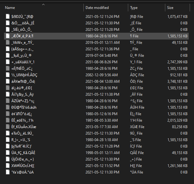

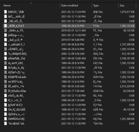

Also, Here are a couple more screen captures.

To confirm - you copied all your files from another drive onto this drive? When you say backup drive do you mean a drive you keep as backup and copy files to or a drive used by specific backup software.
Your choice of application wasn't ideal try something like - r-studio / DMDE / UFS explorer. I find r-studio the easiest to use. Good practice is to clone the drive before proceeding with something like hddsuperclone - the risk is yours not to.
Point r-studio at the drive and see if you can see visible partitions, if not try the partition scan. Do not do a scan of the whole disk yet. Post an image if you can.
.. and when was your last virus scan?
