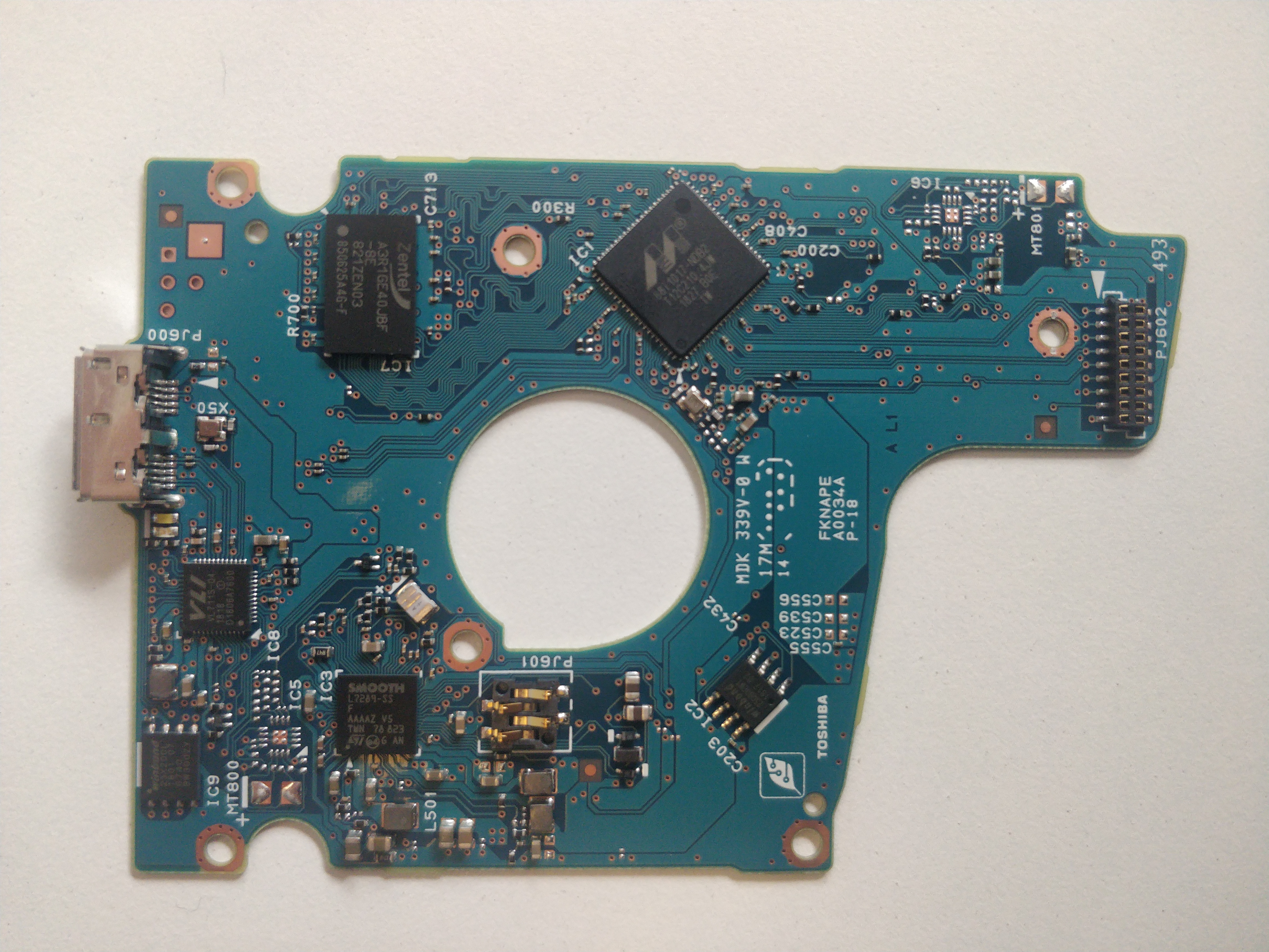

I have a Toshiba external Drive MQ04UBF100 on a G0034A board.
The board does not appear to be getting any power (LED is not showing, and the drive does not feel like it is starting). Usually, I would plug this into a SATA external caddie to access the data, however the connection on the drive is not what I expected.
Any advice on how to best access the data for recovery?
I am based in the UK. I have seen a board for sale on ALI express, and another in the US. But wondering if there is a more local method.

The most you should pay for a PCB + ROM transfer is US$50. The ROM is at location IC2.
There is a tiny fuse near the USB connector. This is sometimes affected by nuisance failures. It is located just above and to the left of the white arrow adjacent to the USB connector.

Pepe- That is fantastic, cheers! Any idea what I need to do, in order to be able to Direct Message people?
Lardman - I am the in house IT guy for my work, so never really done component transfers etc. The prices you discussed with fzabkar are within the user's budget.
He has advised that the last few times it was booting up, it involved adjusting the USB cable until it connected. So, it sounds like there is a faulty connection within the input, but as my previous line, I am no expert in these things.
I have attached an image of the board.

Looks like the diod might have been removed. If thats the case the resistor beside it could be blown and will need to be shorted. But wait for more confirmed message first, just in case I missed something.

Ahh the wiggle it till it works fix :lol: I can't see any obvious damage, the usb port looks ok but can we get a good picture of the pins inside of the connector, and I assume you tried the obvious and checked the usb cable.
If you have a meter handy and good eye sight check the fuse for continuity as per fzabkar's suggestion. It's also worth giving each usb pin a poke to see if they move.

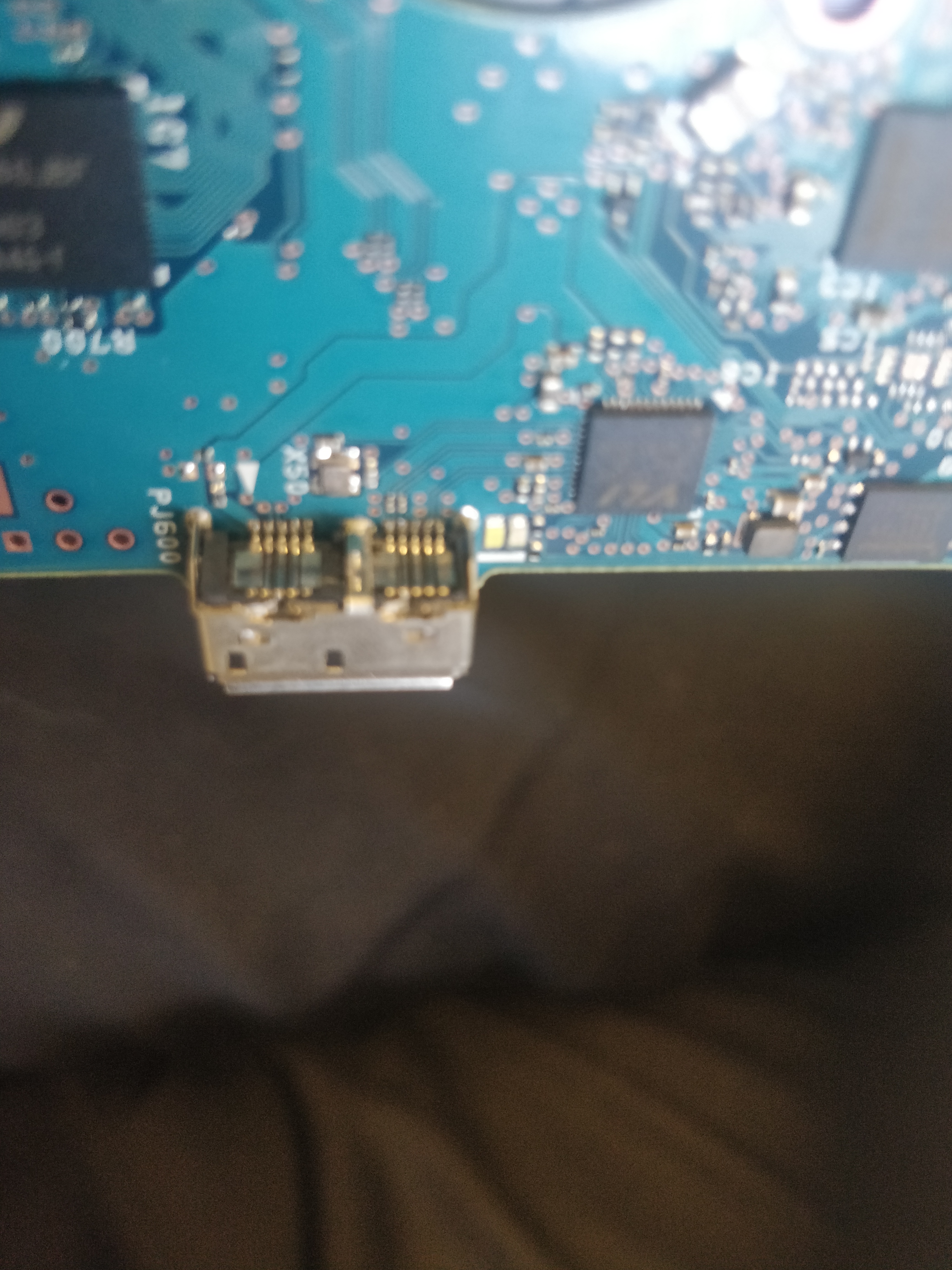

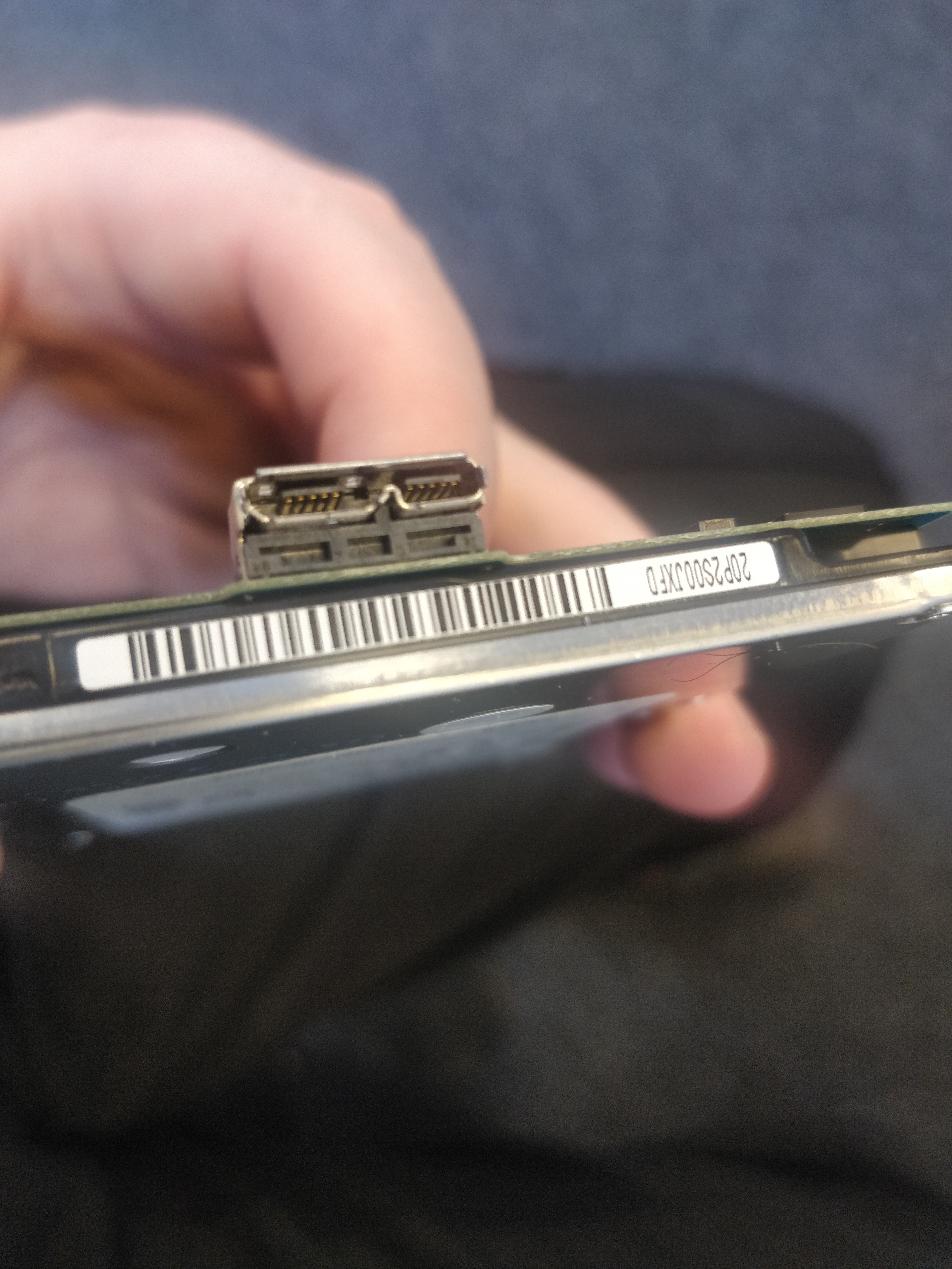

The auto focus on phones can be rather frustrating, I think I have the pictures requested. No movement on the pins, that I could see. No damage either anywhere, other than minor corrosion up and right of IC9 And below L501 on the kind of squarish grey things. (Very technical terms in use here)
Yeah, tried a different cable as well.

USB looks fine - that's a shame, mushed pins would have made this easier.
Did you check the fuse by the white arrow on pin 1? You need to check the usb bridge is getting power.

Back to the 'wiggle fix'.
They do fail so have you tried an alternative cable?
Also some top secret info.........you can try a standard micro usb charging cable as used in a samsung phone or similar. It will fit to the slightly wider connection on the socket.
