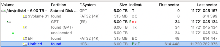

This is what DMDE shows for partitions.

I did a test undelete of the partition containing all my files. DMDE did undelete it, but the directory structure and files were not undeleted with the partition. I can still see all the directories and files in DMDE preview / directory mode but not sure how to have DMDE write this information to the disk. Maybe it's not possible with DMDE and I have to recover all the files to another drive?

The problem is that you have swapped external enclosures. The drive was originally formatted in an enclosure that had a sector size of 4KB. It is now in an enclosure that has a sector size of 512 bytes.
The easiest solution is to reinstall the drive in the original 4KB enclosure.

@fzabkar thank you. Learned a new lesson and a valuable one!
I'm surprised this is possible but sure enough:
https://www.klennet.com/notes/2018-04-1 ... -size.aspx
For anyone following, both "enclosures" were Sabrent brand made to accept any sata drive. I'm not 100% if my friend tried to initialize these drives on his Macbook or not, but somewhere along the line they were put into an alternate drive dock and something was done as they are no longer readable in either of the two hdd docks used. He has a couple others which are still readable and they were only used in one hdd dock.
