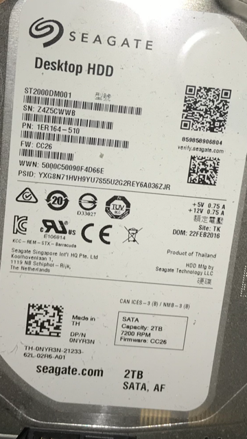

I have a problem with this ST2000DM001 Seagate drive (see pic 1 for sheet).
- From what I can make out, it starts spinning, then there are two identical noises and then it stops doing anything and I have to disconnect it and reconnect it for it to do the same thing again. If I just restart, it stays idle (you can listen to the sound file attached "HDD Noises", please disregard old fan noise at the end).

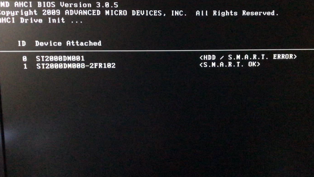

- It is recognized at startup and it says <HDD / S.M.A.R.T. ERROR> (see pic 2).

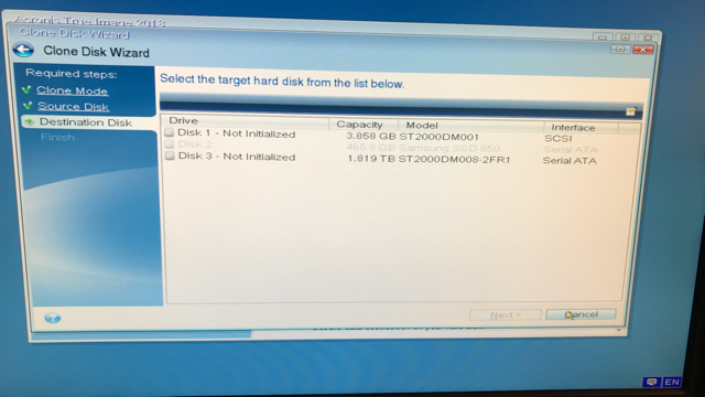

- It shows up on Acronis True image with the wrong disk size (3858GB instead of roughly 2 TB) (see pic 3).
Are you sure it's 3858GB and not 3.85GB?
Sounds like the default value from the PCB rather than the correct information being read from the drives SA.
If it's spinning up and then spinning down and isn't recognised in the bios there is very little DIY that can be done. If the data is important contact a DR pro, the drive needs to be checked for firmware / head and media damage.

+1, most likely heads are bad just pray they haven't taken media with them. If data is important DO NOT POWER UP THE DRIVE and consult a pro.

You are both right, it's 3.85 GB. I did not know about the PCB "disk" size.
Ok Thank both you for your inputs. It does not look very good...
One more thing I forgot to mention, Acronis True Image wrongly recognize it as on an "SCSI" interface instead of sata. Also it slows the boot of windows from 20 seconds to five minutes when it is connected. Oh well, I guess this thing is pretty dead according to you both.
