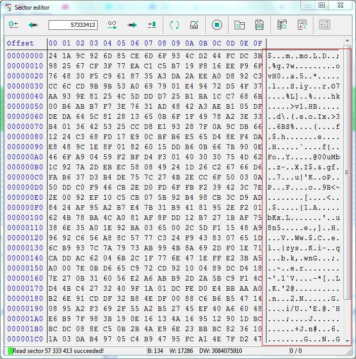

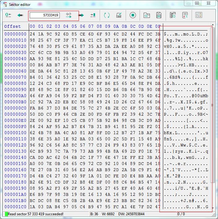

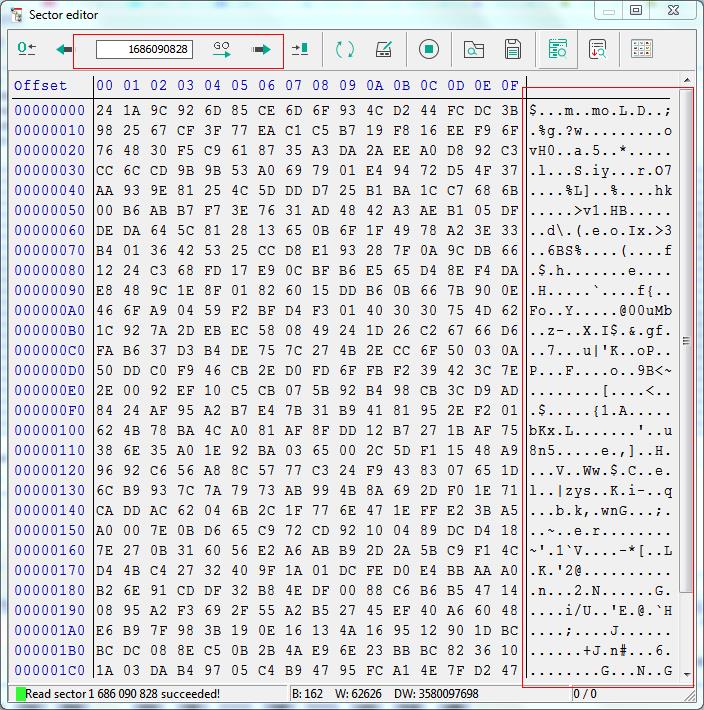

ST1000LM035-1RK172
Very strange. So much sector same Its occure when at slow reading speed
Sometimes its changing after reset .
Only Head 0 making this. And H0 , H1 both reading very good condition
Anyone meet this before?
what is your advices. Thanks

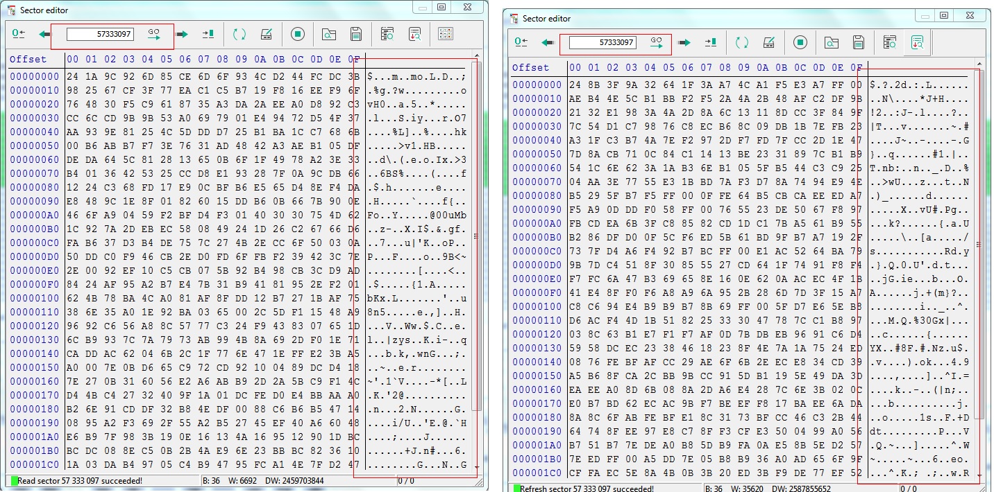

when refreshing sector. some sector changing. I guess that is real data

The mo.L.D. sectors are not data -- they indicate a reading problem.

This pattern is generated by the fw and used for filling buffers, it may be used to fill MC sectors, i am not sure about this latter one.
so you get this instead of an UNC error.
