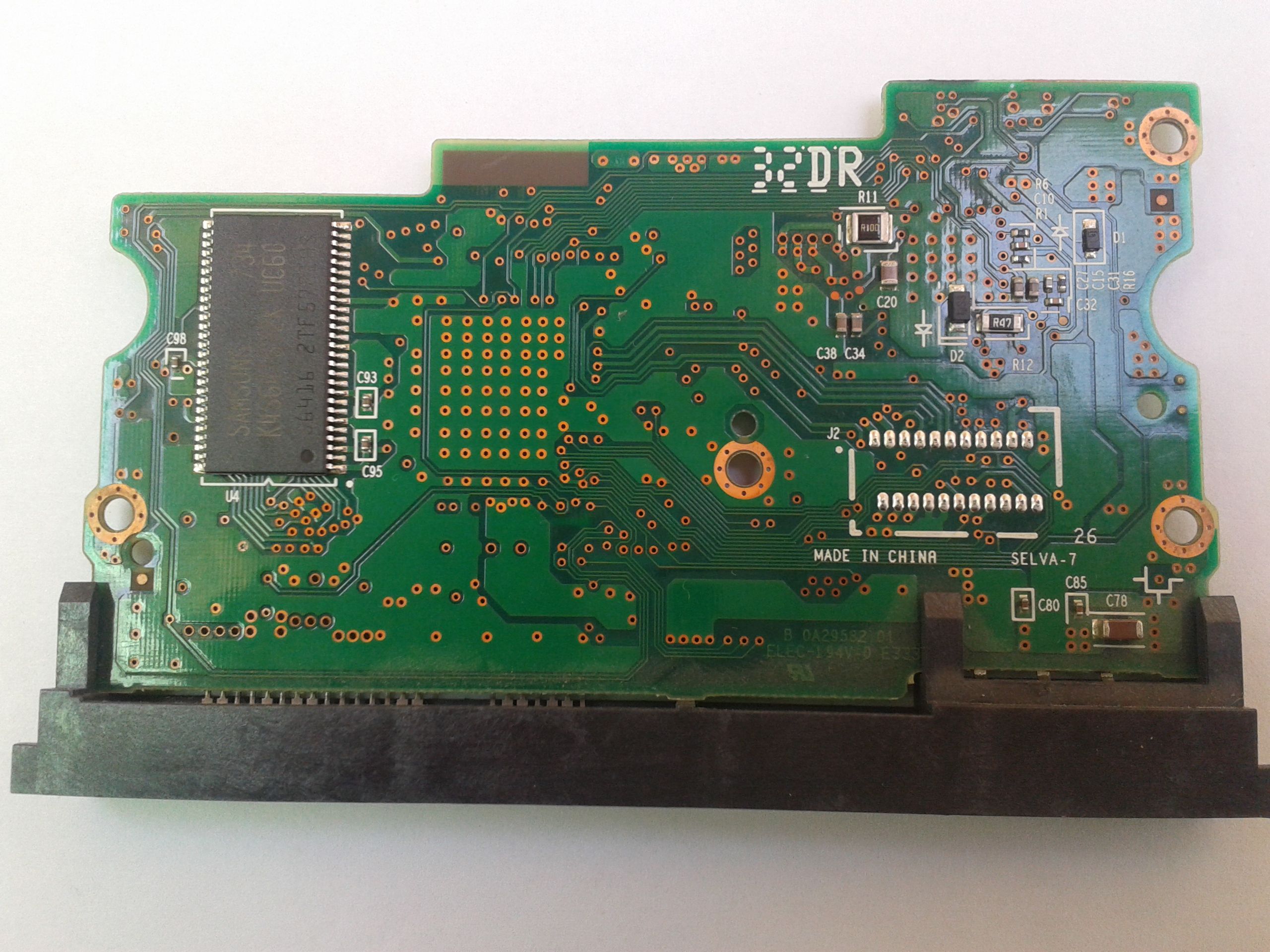

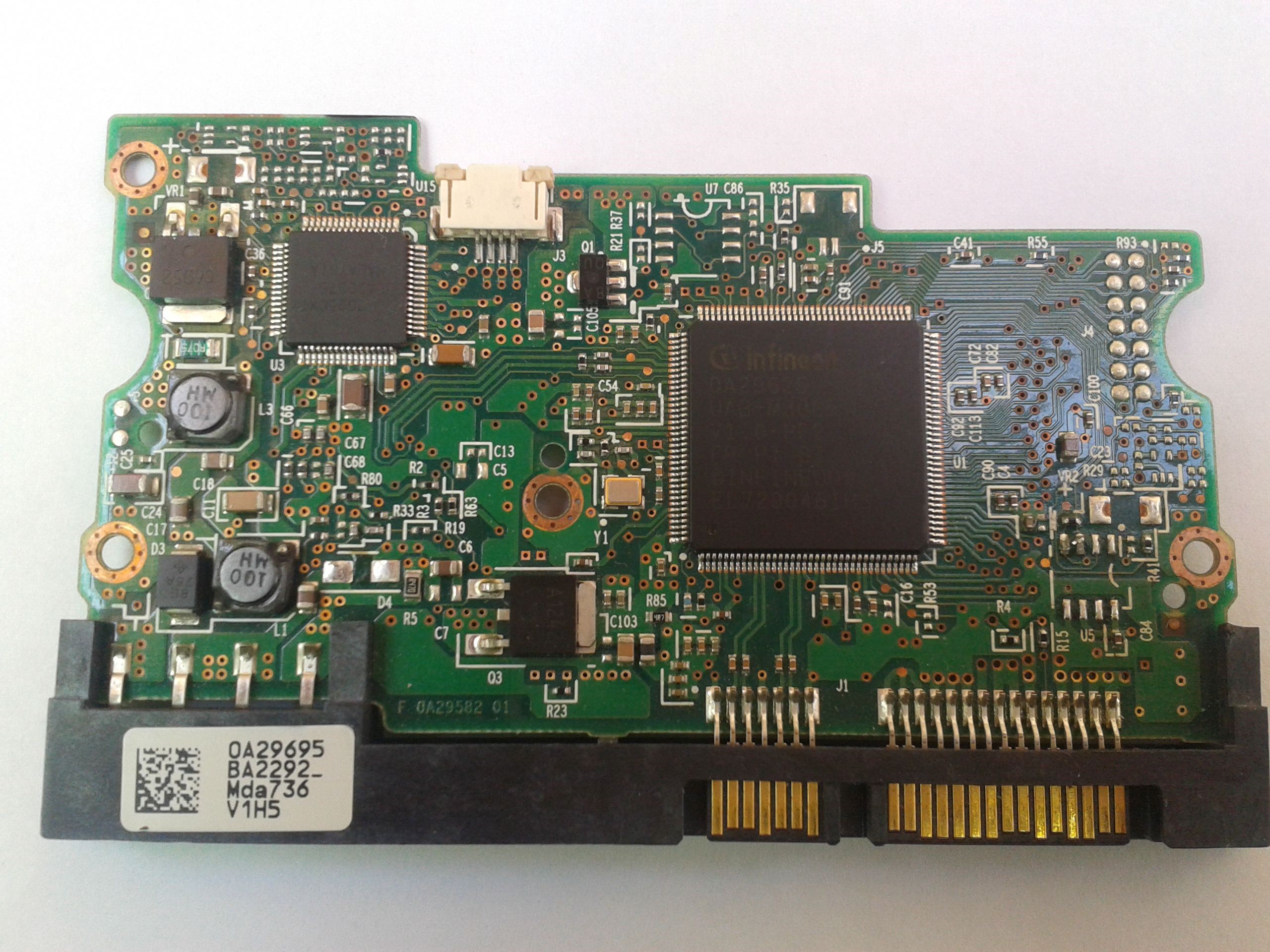

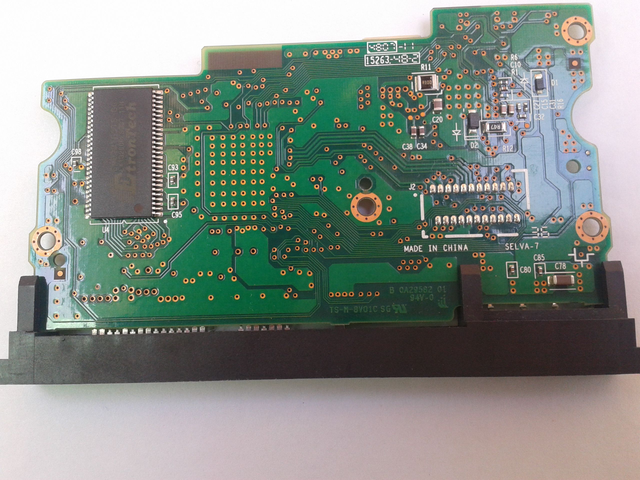

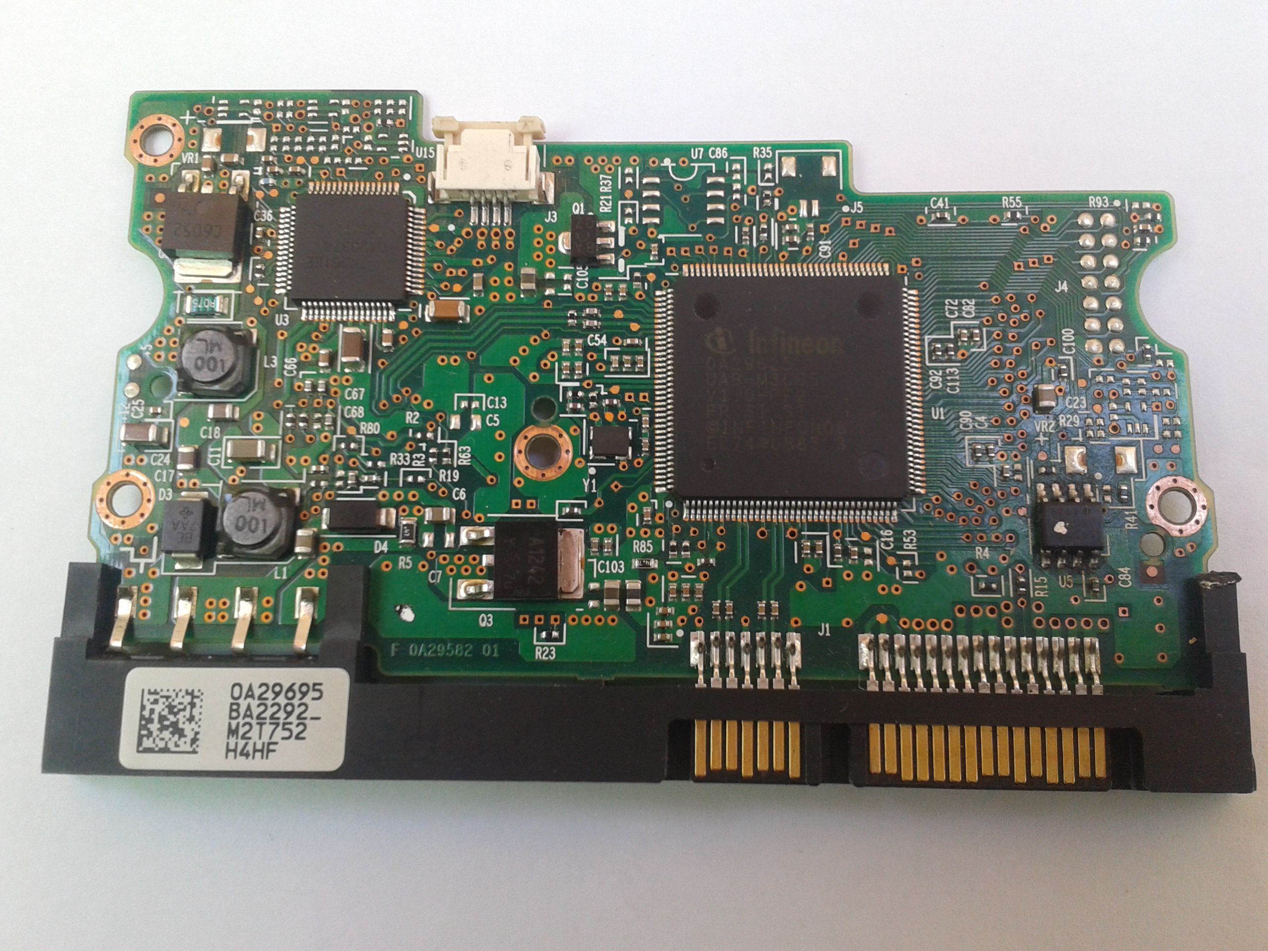

Please find attached an images for the patient and the donor PCB.
If you mean diod check I do it before for patient PCb and all existing diods are fine but D4 is missing in the patient PCB from begging.
the PCB is belong for my relative and he ask me to help him to retrieve important data.
Tomset wrote:
Need to start work with isolating the switch of heads. Leaving the motor contacts. If the motor starts, then the board has nothing to do with it
I did this test before I disconnect the motor connector and try, The same result (no spinning).
Thank you all

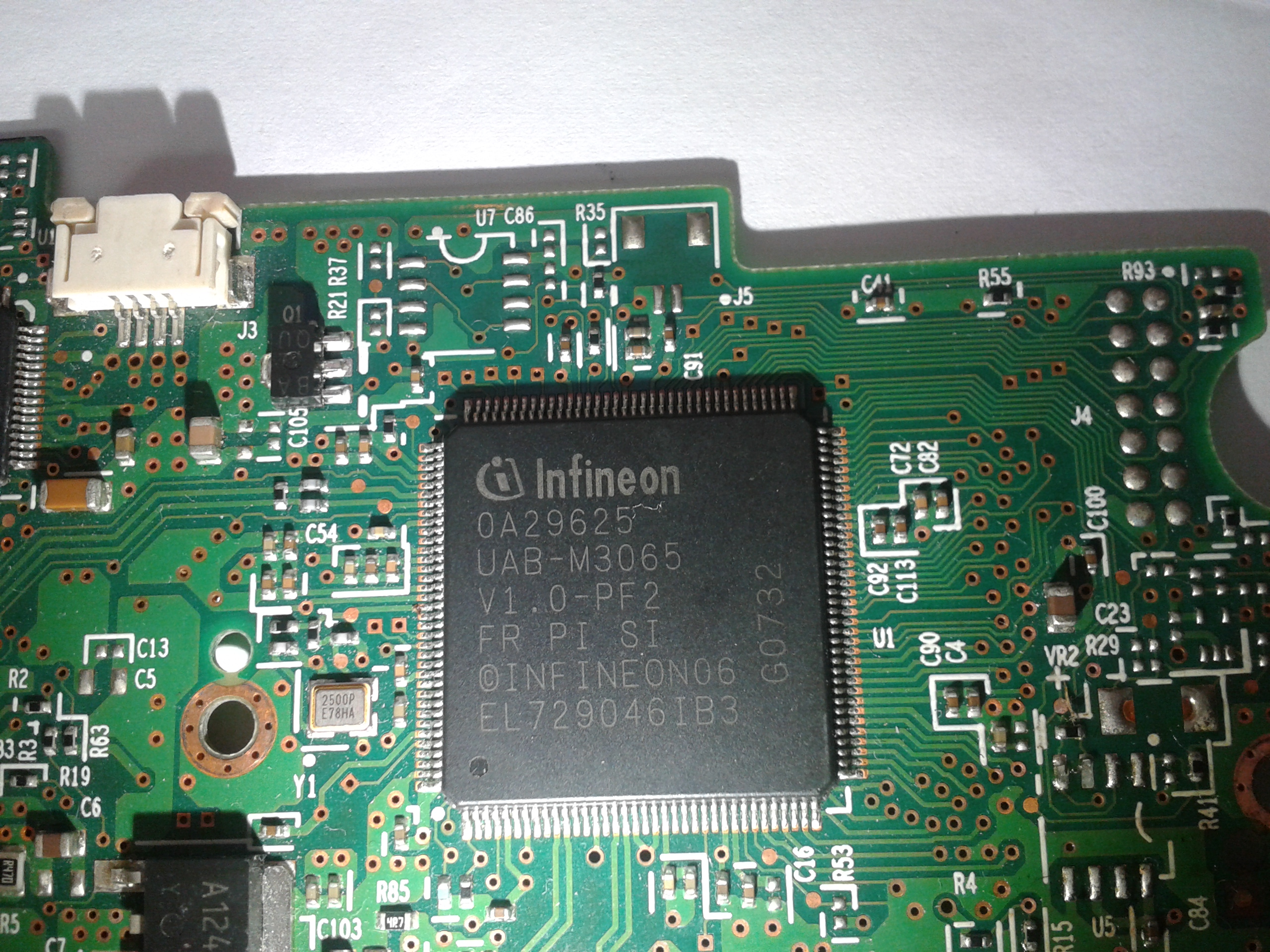

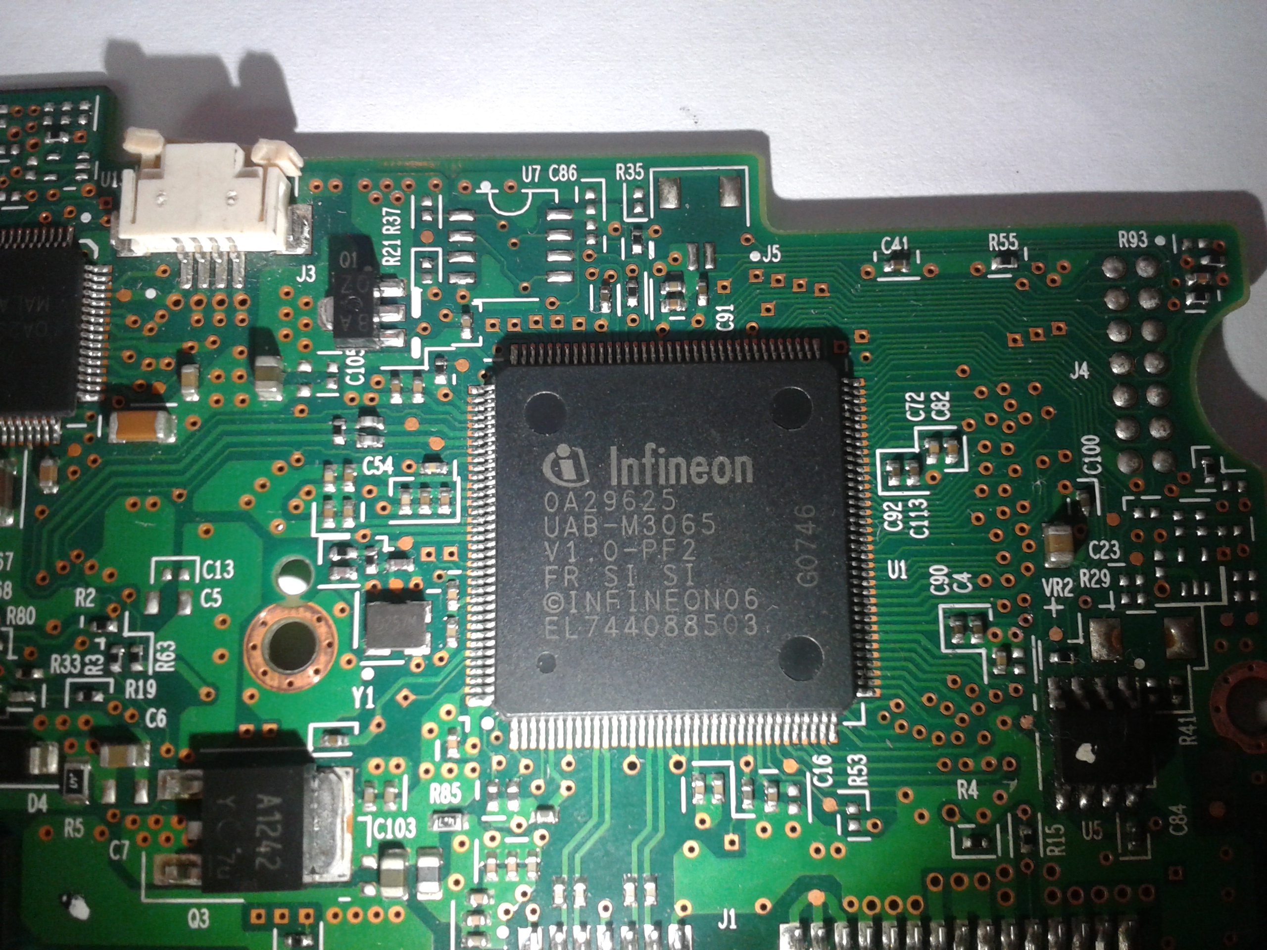

and here is an images for the main controller ICs for both patient and donor

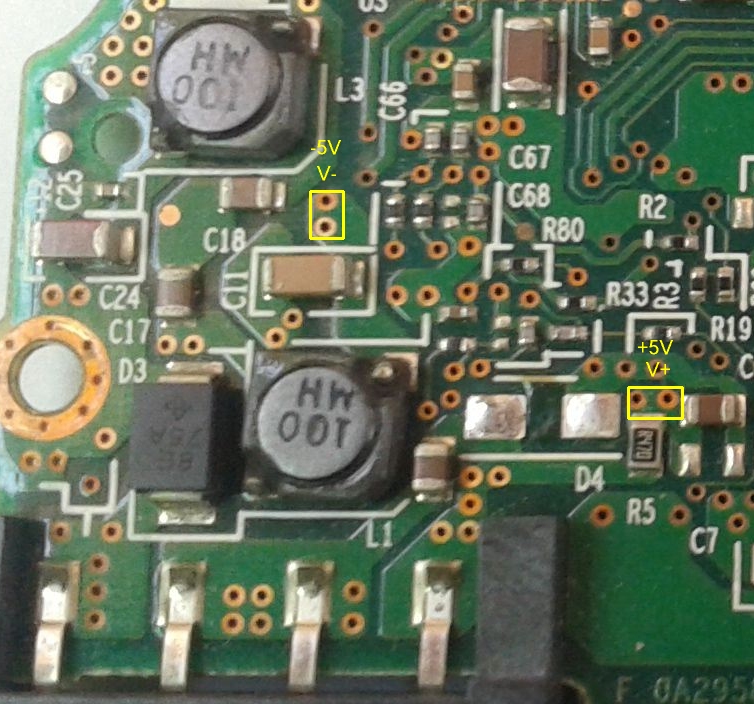

Measure the voltages at V1, V2, V3, V- and V+ with the PCB off the drive. Also measure the resistance of R5 (near V+).
V+ and V- are the preamp supply voltages.
Measure the resistance between ground and each of V+ and V-. Then install the PCB on the drive and repeat the resistance measurements. This will tell us if the preamp has been shorted.

if with a new board without replacing the NV-RAM, the motor did not rotate. There are only two options: Problems in the hermoblock or the board is not of the same configuration. Replacing NVRAM will not help in any way.
 Post subject: Re: Hitachi HDD data recovery
PostPosted: June 9th, 2021, 18:03
Posts: 421
Location: Moscow
there are boards on the PLA380
PCB:
0A29374
0A29375
CPU:
0A29625
0A29615
0A29626
0A29300
they are not compatible.
The general recommendation is to look for a board with the same code on the sticker. But and they may not be compatible.
