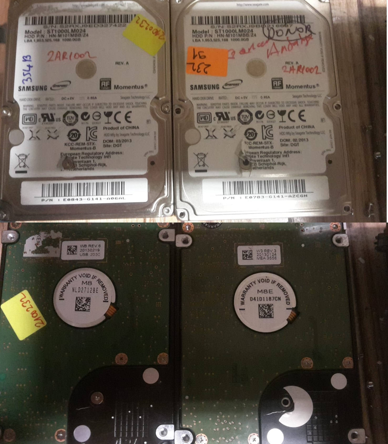

 Post subject: Re: Samsung Module ofset Method?
PostPosted: June 6th, 2021, 16:22
Posts: 4850
typical symptom of bad writing after head swap. It's only gonna get worse, it's not the sa that's bad, it was fine at the first start. so i see no point in relocating the modules, which would not be possible either, whichout the ability to write correctly.
PostPosted: June 6th, 2021, 16:48
Posts: 17328
Can you show us the two PCBs, patient and donor? AFAIK, there were at least two PCB versions for this model, one with a Samsung part number, the other with a Seagate number. ISTR that there were two different preamp voltages, 1.8V or 2.5V, but I could be thinking of another model.
PostPosted: June 6th, 2021, 18:17
Posts: 489
Location: Usa
yellow sticker patient
Sexy Womans from your town
PostPosted: June 6th, 2021, 18:50
Posts: 17328
According to the stickers on the motors, one drive is an M8 and the other is an M8E. Could that be the problem?
PostPosted: June 6th, 2021, 19:18
Posts: 489
Location: Usa
I have recognised this. But Patient accepted hsa. Its reading user data also.
I would try another donor. Bored me this case.
Just checked logic scan. Not good reading speed. Maybe M8 and M8E couse, or heads weak really.
DE imaging was at 66% before problem occured. Anyway.
I am also thinking about clone disk to same model with empty Slist. Then write patients Slist to it. Any chance for this? I have to do some practise for all
