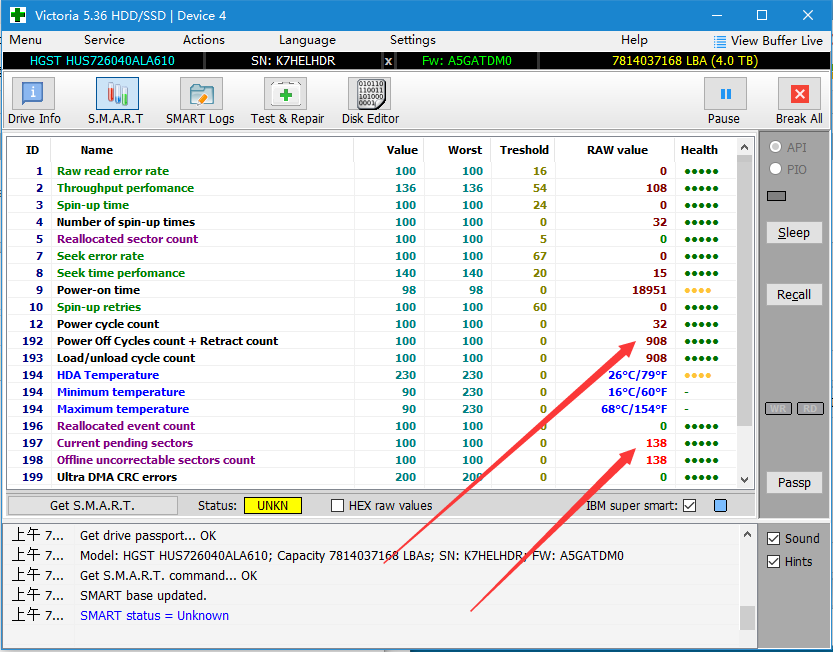

How to clear the red message marked in smart?

Why would you want to delete that valuable piece of information?
It won't do any harm and is helpful for the owner of the drive to evaluate the drive's condition.

RW surface scan and see if it reallocates them
