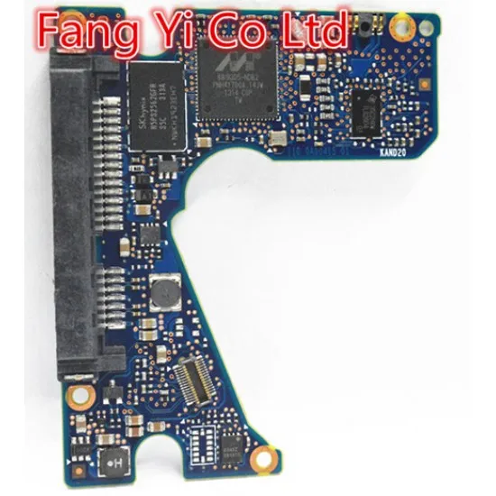

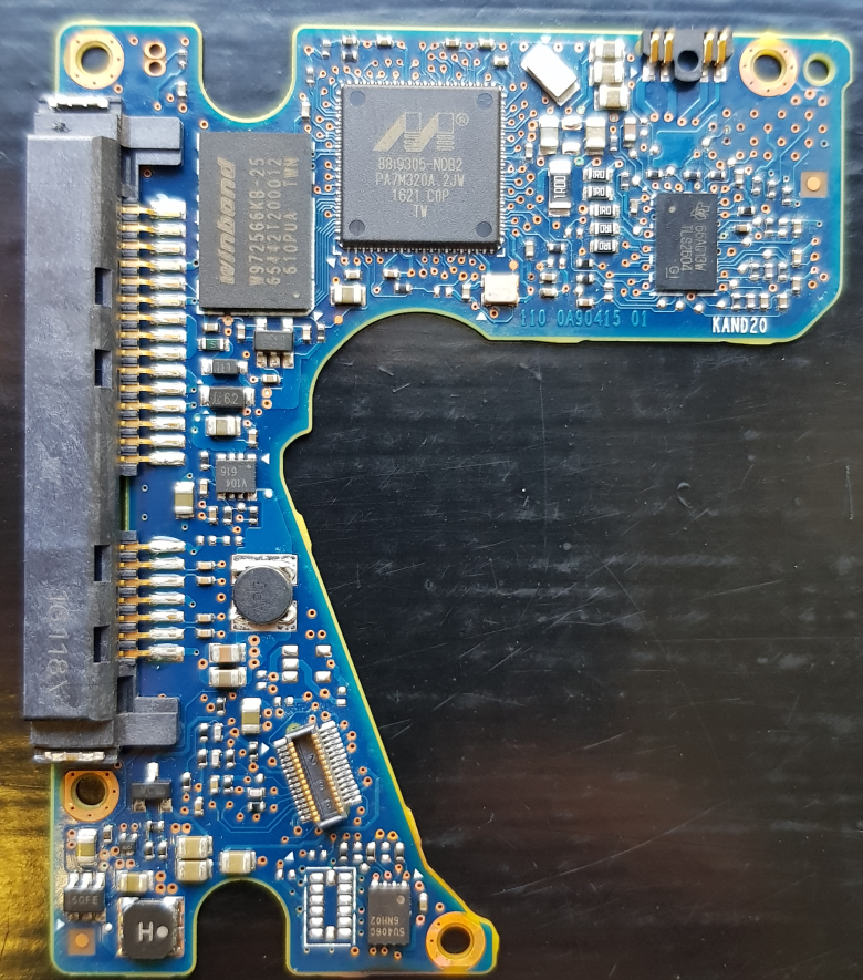

Can someone please confirm for me where NVRAM is located on this model? Embedded in MCU?

Location: Moscow
bottom right
US406C
ROM+NVRAM
 Post subject: Re: NVRAM location HTS541010A7360
PostPosted: June 15th, 2021, 8:47
Posts: 411
Location: Romania
Judging by the pcb layout, my guess would be botom right near the screw hole.
Rgds
Ahhh, too late :D
PostPosted: June 15th, 2021, 13:27
Posts: 17324
LE25FU406B, Sanyo, 4M-bit (512Kx8), 2.3V - 3.6V, Serial Flash Memory:
https://media.digikey.com/pdf/Data%20Sheets/ON%20Semiconductor%20PDFs/LE25FU406B.pdf
http://semicon.sanyo.com/en/ds_e/ENA1066E.pdf
http://pdf.datasheetarchive.com/indexerfiles/Datasheets-SW5/DSASW0080400.pdf
http://www.users.on.net/~fzabkar/Datasheets/DATAURLS.HTM
TCV7104FN, Toshiba, buck DC-DC converter, 2.7V - 5.5 Vin, marking V104, SON-8:
https://np.micro-semiconductor.hk/datasheet/07-TCV7104FN(TE85L,F).pdf

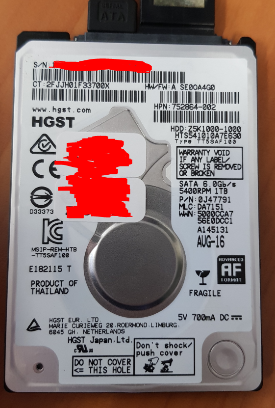

Drive has a damaged PCB so I've already moved that IC in question to compatible donor PCB. The 8 pin IC bottom right of the PCB pic. Problem is, patient won't spin with donor PCB and patient ROM.
Drive does come DRD DSC and reports correct S/N, but will not spin. Patient with donor PCB and donor ROM does spin, ID's with donor S/N but obviously no LBA access.
Trying to figure out why patient with donor PCB and patient ROM will not spin. Thought perhaps NVRAM was situated elsewhere and wasn't part of ROM IC?
PostPosted: June 17th, 2021, 11:05
Posts: 4848
i recall like these were built with 2 different spindle controllers and they are not compatible, so check the numbers on it on both pcbs.
PostPosted: June 17th, 2021, 17:23
Posts: 17324
The two different motor controllers appear to be TLS2604 and R42AAJ.
PostPosted: June 18th, 2021, 5:39
Posts: 1038
Location: South Africa
Thanks fzabkar and pepe. My first donor PCB did indeed have a different motor controller. Patient was TLS2604 and donor was R42AAJ. Wrote ROM to another donor PCB with matching TLS2604 and case solved. Seems I was trying to overcomplicate this case when it was just a matter of matching PCB properly. Thanks guys.
