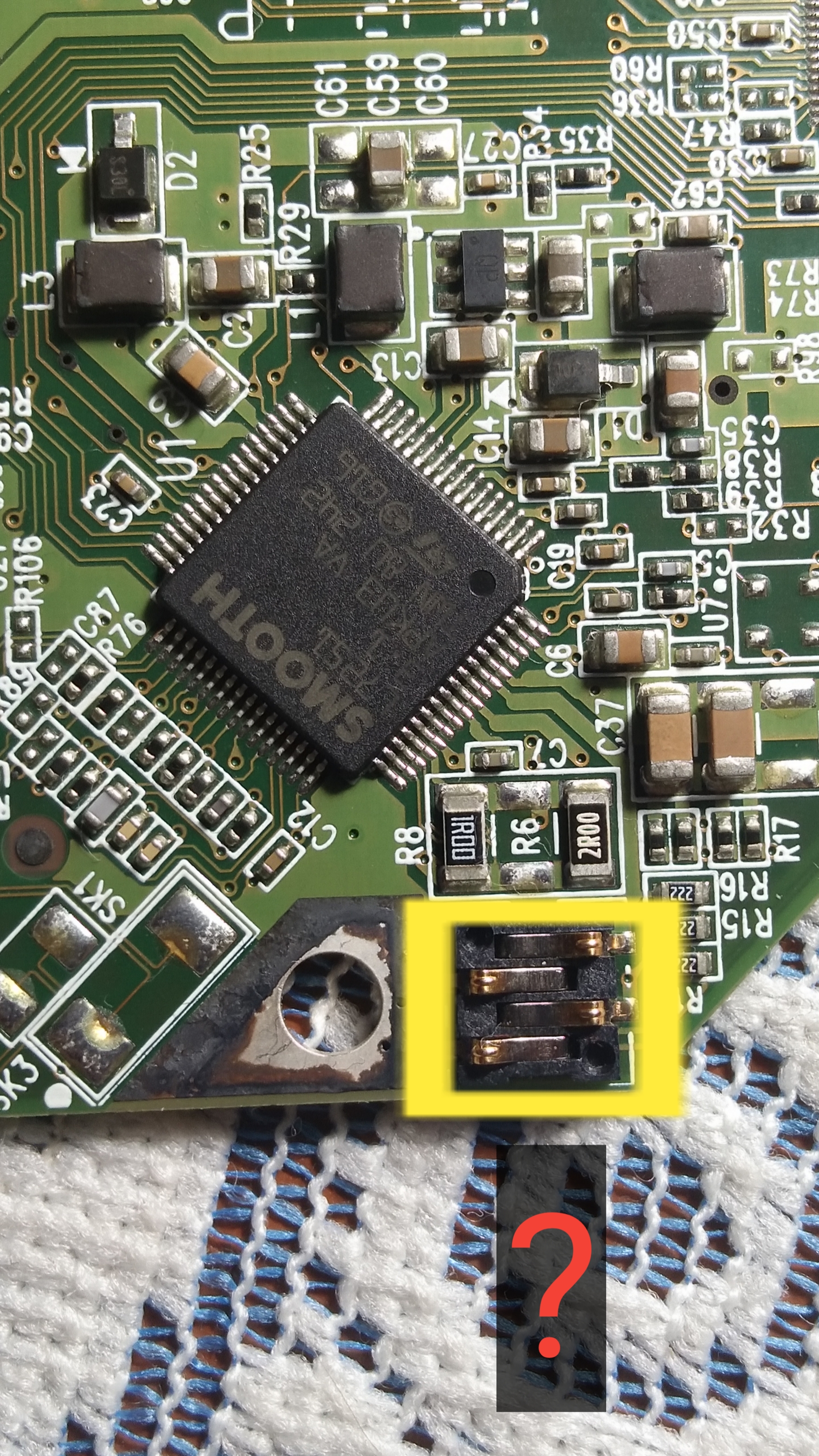

I have a desktop hard disk of we 500gb internal. One day, I started my pc, it was showing to select a boot drive, no hard disk was detected. And also no spinning sound or vibration is comming from it.
I have already checked the TV's diodes, no burnt on circuit board of hdd.
Please help me. I don't want to lose my data.

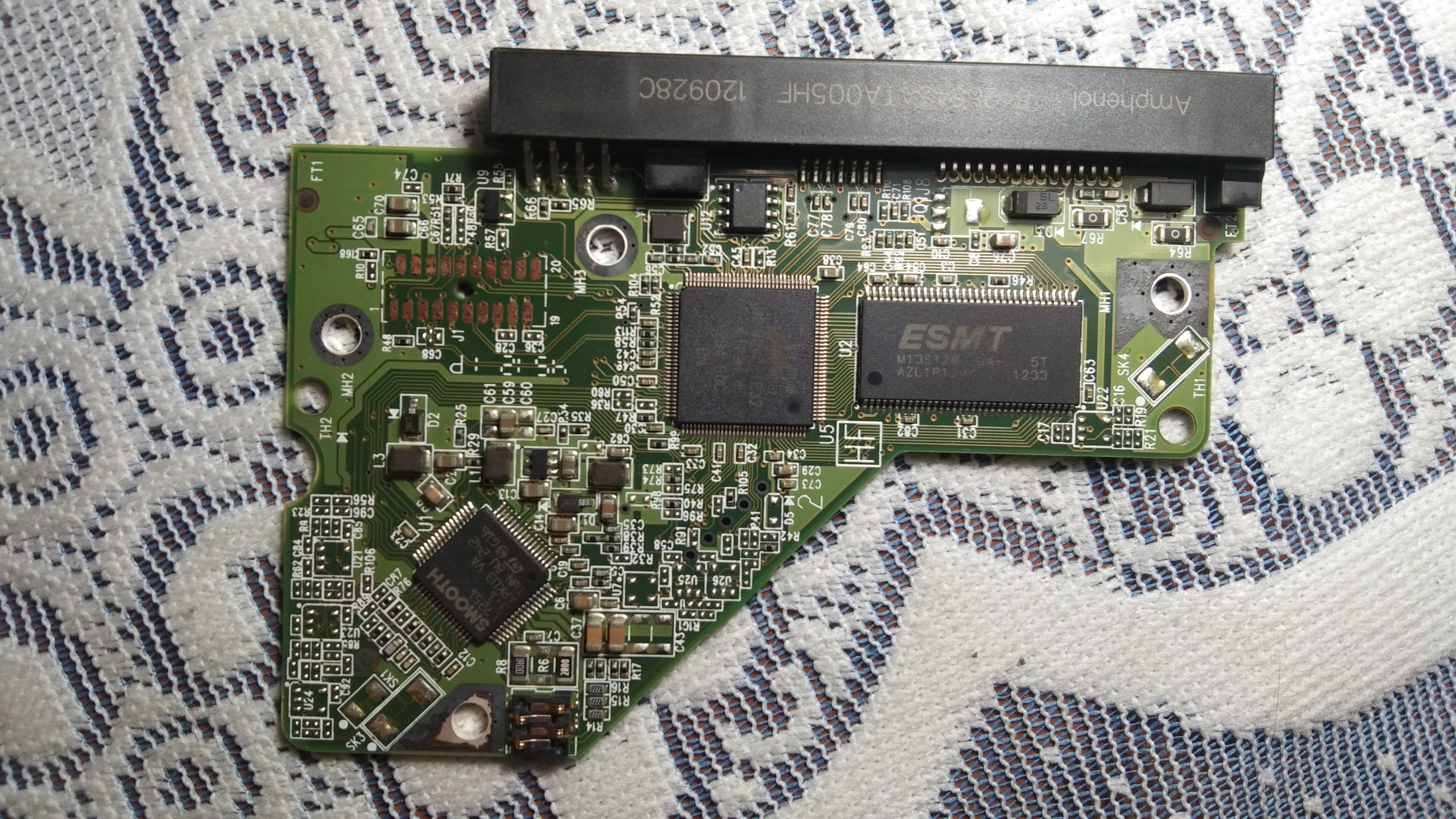

File comment: WD PCB board
 Post subject: Re: My Wd desktop hard disk is not spinning, no power.
PostPosted: June 7th, 2021, 5:00
Posts: 402
Location: Moscow
Isolate the 20-pin connector, leave the motor contacts. If the engine starts. The switchboard or heads died. If it doesn't start, change the board.
PostPosted: June 7th, 2021, 5:05
Joined: June 7th, 2021, 4:38
Posts: 13
How to isolate 20 pin connector
PostPosted: June 7th, 2021, 5:50
Posts: 1312
Tape or thin card like a business card.
... and whilst you're at it give the connectors a clean off and check the 0 ohm resistors around power in.

pvprashant1803 wrote:
I have done this already...all things are working and fine....but don't know what's the problem
if the motor is spinning with isolation of switch heads. so the problem is in the hermoblock, you need to change the heads.

I already mentioned that the motor is not spinning even after isolation of 20 pins
Model no. is wd5000aakx.
PCB board is 2060-771640-003 rev A.

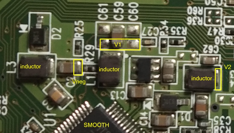

PostPosted: June 7th, 2021, 14:18
Posts: 17215
Measure the 3 voltages (V1, V2, Vneg).
PostPosted: June 7th, 2021, 15:29
Posts: 1312
From a working PCB for info.
V1 : 1.10
V2 : 2.57
V- : 0.08
In terms I can understand - that is to say very simple :) is there a reason to measure the values on the caps and not the inductors themselves, other than ease of access ?
PostPosted: June 7th, 2021, 15:36
Posts: 17215
V1 : 1.10
V2 : 2.57
V- : 0.08
V- is probably 0 because the firmware switches off this supply if it doesn't detect a preamp.
I use the inductor as a test point just because I cannot always tell which capacitor is connected to it. In general I would use the least "busy" test point to minimise the risk of damage if the probe were to slip off.

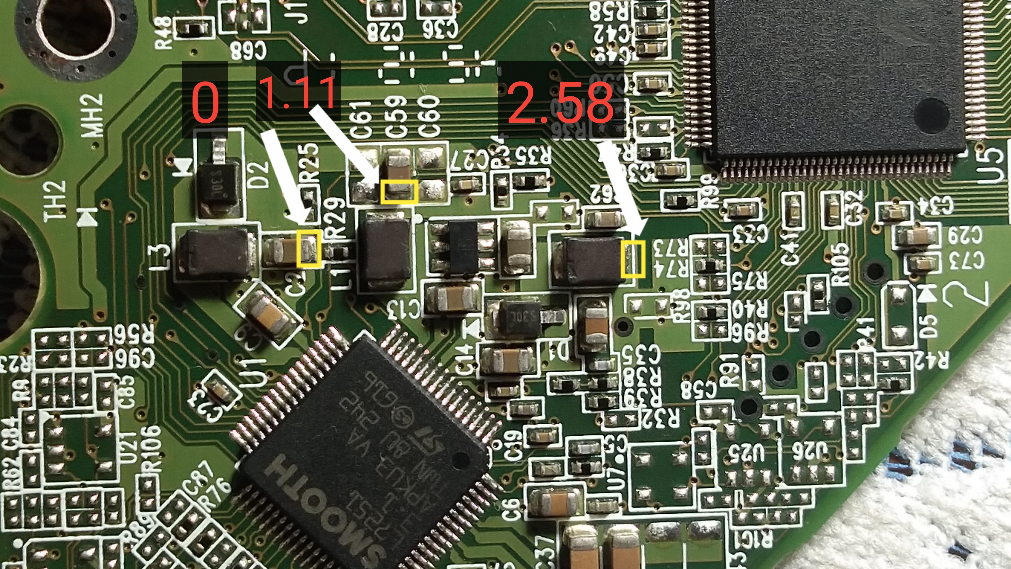

I got these values

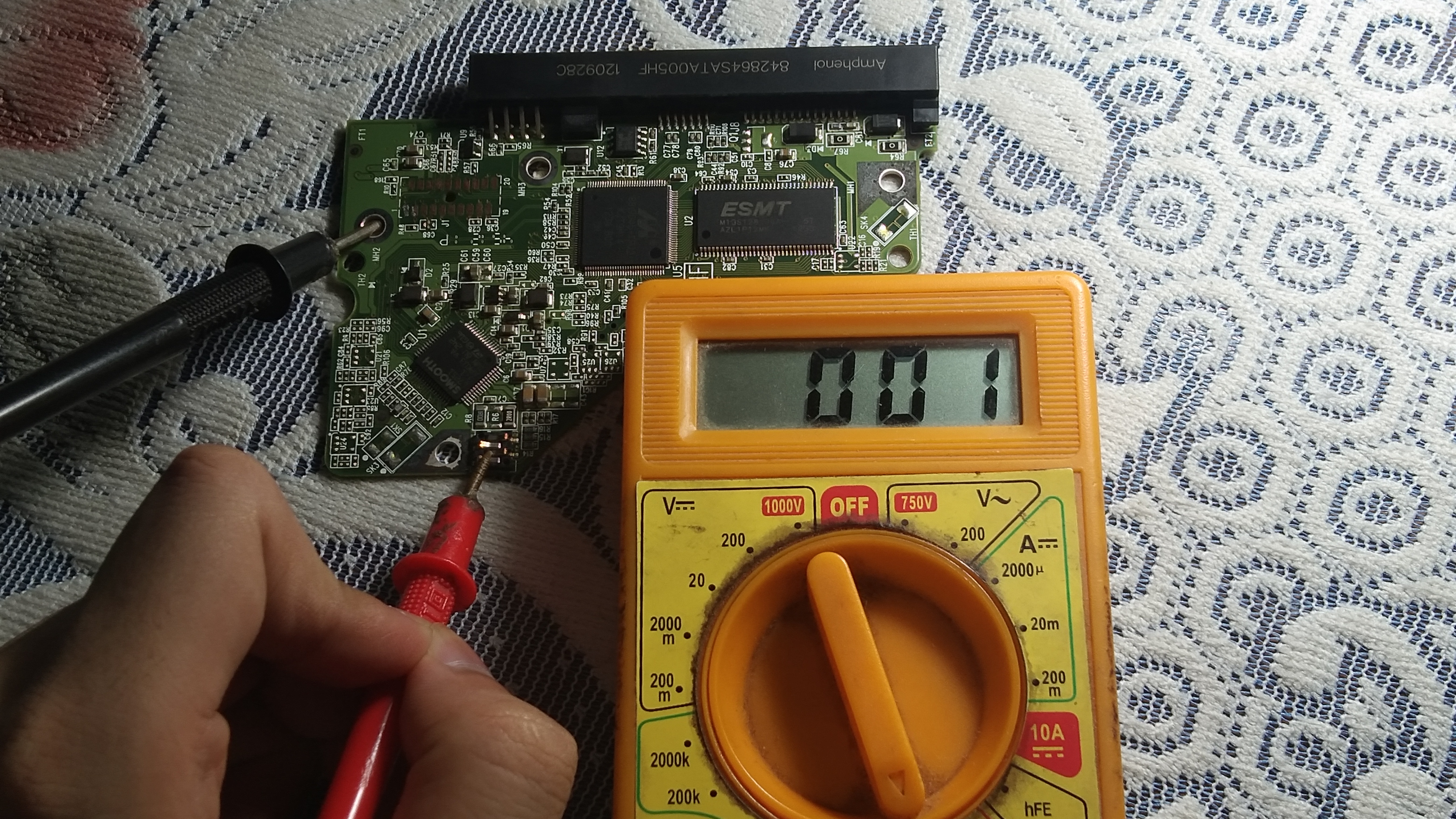

PostPosted: June 8th, 2021, 3:46
Posts: 13
Also, it is showing zero continuity value from ground to these 4 pins.
