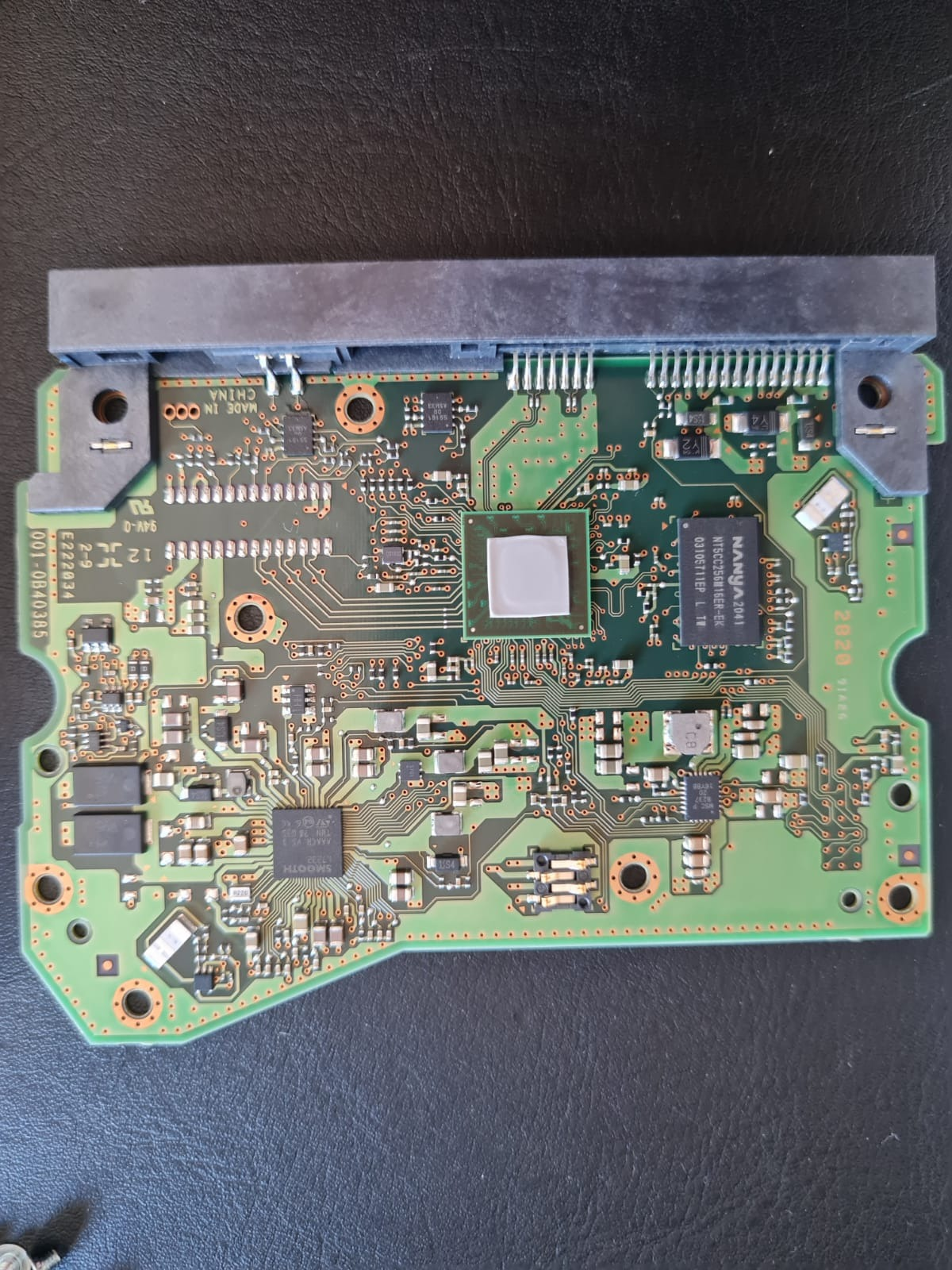

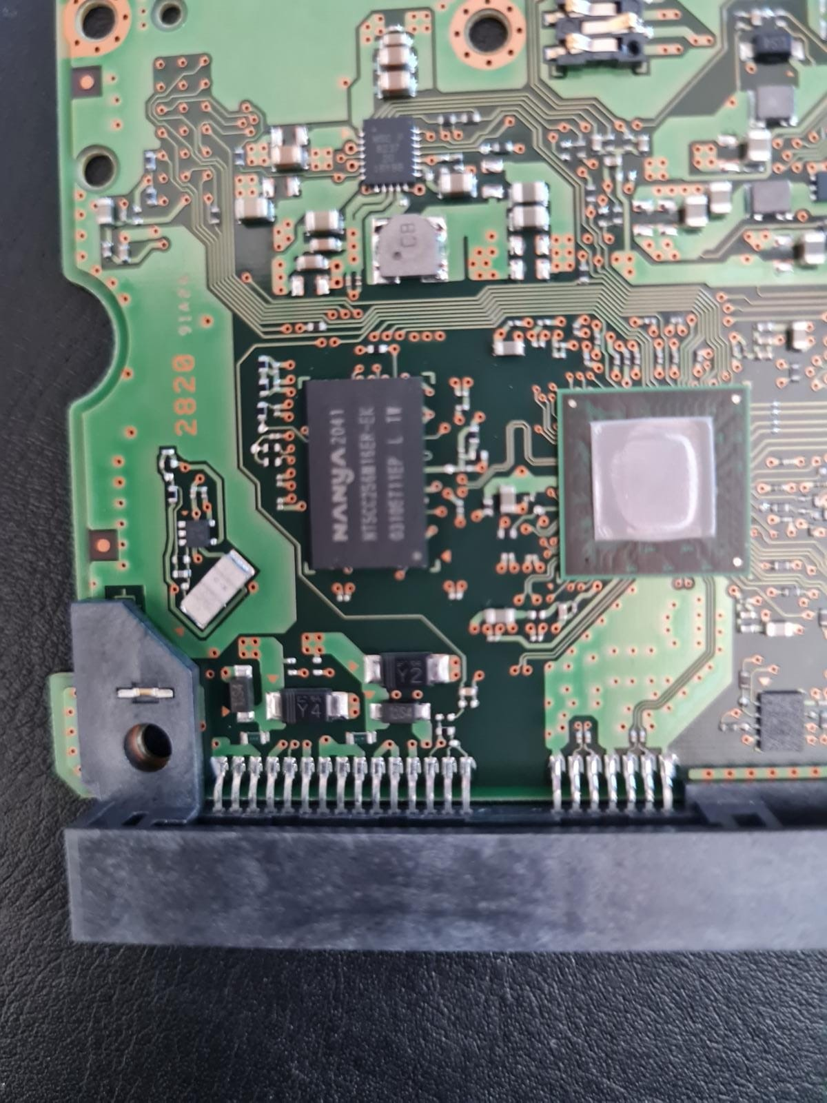

I opened today but looking at the diodes everything looks OK which I am guessing is not a good thing?
I have attached some images, if someone could check it would be much appreciated. I am not sure really what I am looking at.
Thank you

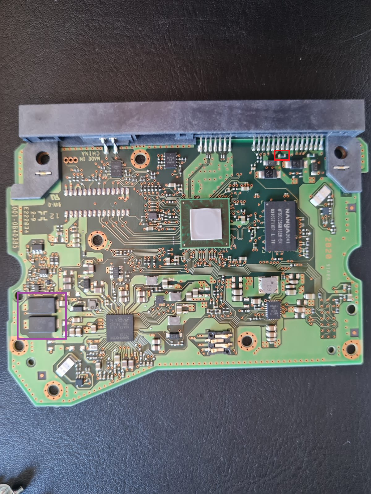

Unless something went really wrong you're not going to visually see anything. You need a multimeter to check the diodes and resistors/fuses bottom left. Meter in continuity/diode mode and a probe on each side of each component.
fzabkar suggests that one of the fuses is blown, I'd be looking at the one on the 5v rail first.

I have just tried testing everything with a mulitmeter. Again I dont really know what I am doing but I guessed I would try both red/black on either side of anything that looks like a diode.
The tiny one i have marked in red does not appear to be sending anything. The other tiny one to the right of it does (as you look on this pic).
The purple ones also did nothing but i dont know if they are meant to?
EDIT - just seen your reply. Thanks. So the one I marked in red is suspect?

Ignore the purple.
It there's no continuity on the red one - you have probably found your problem :D
Unlike the TVS diodes you can't just clip it off, you will either need to replace it or bridge it, how good is your soldering ?

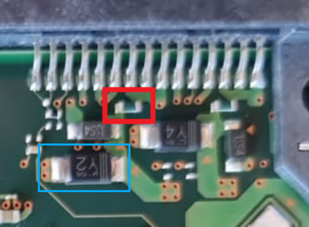

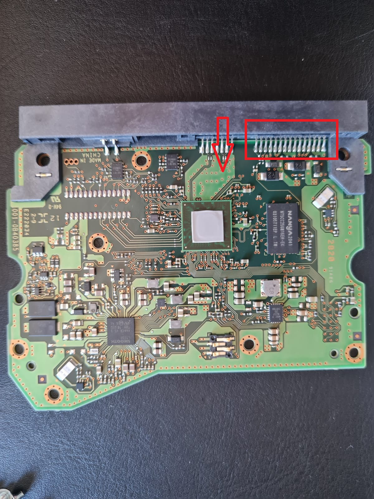

File comment: [quote="Lardman"]You should also check the diodes on the rail (they're just above) - they should have continuity only in one direction just in case it's more than just the fuse. [/quote]
Is this the rail?

Posts: 1319
The TVS is just above the fuse.
This is the diode to check, hopefully though it's just the fuse.
