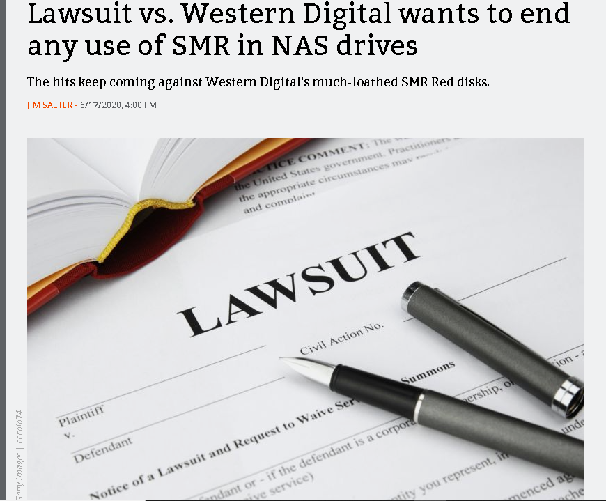

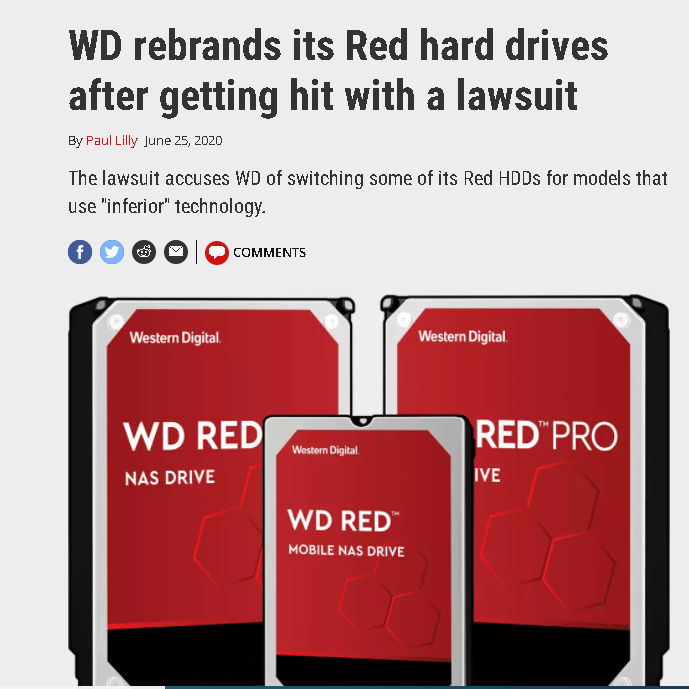

WD's support staff originally refused to tell, or were unable to tell, customers whether a particular model used SMR or CMR. There are plenty of threads in WD's forum on the subject, some of them laughable.
WD is now facing a class action law suit which charges that they "submarined" SMR drives into their NAS products.

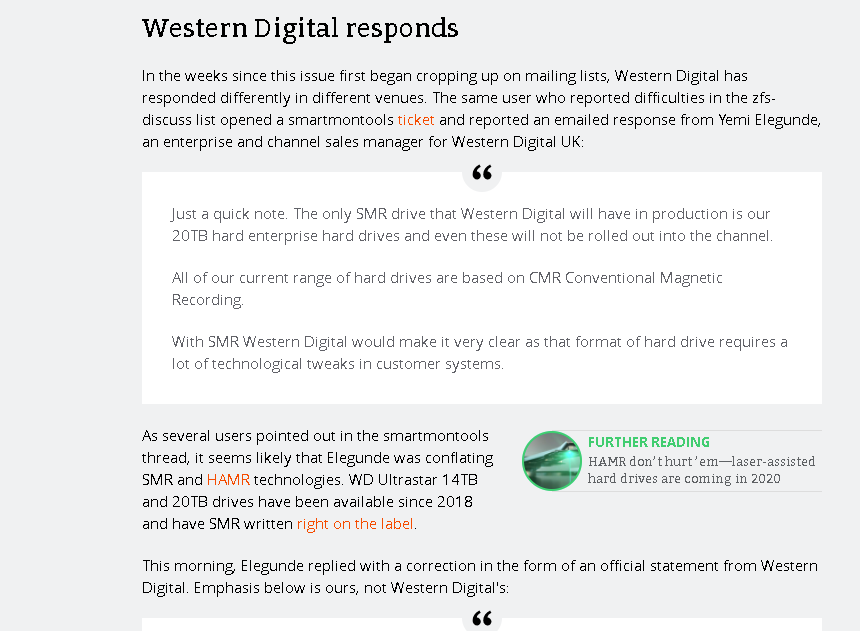

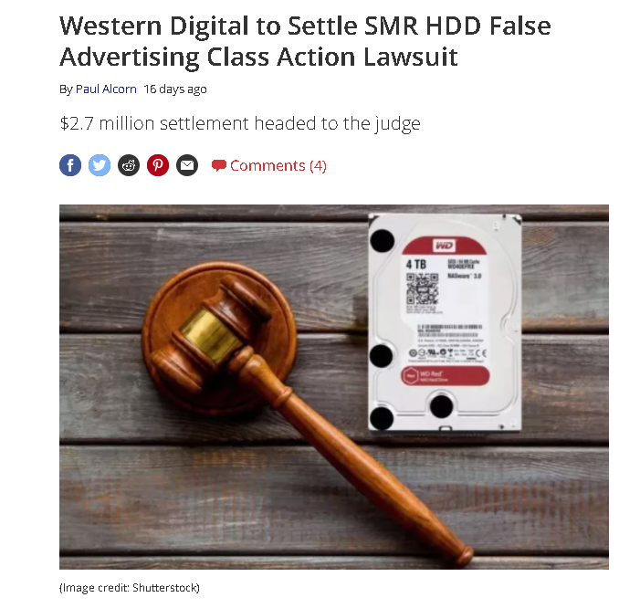

 Post subject: Re: SMR or CMR Is that matters
PostPosted: July 3rd, 2021, 23:15
Posts: 548
Location: brisbane

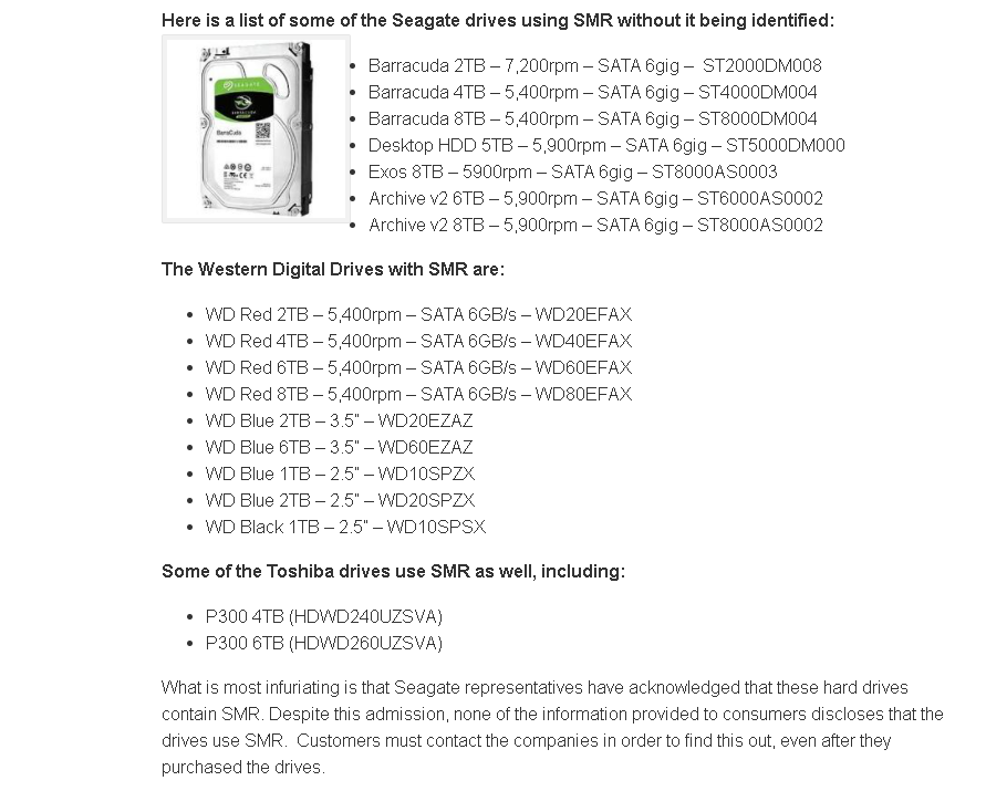

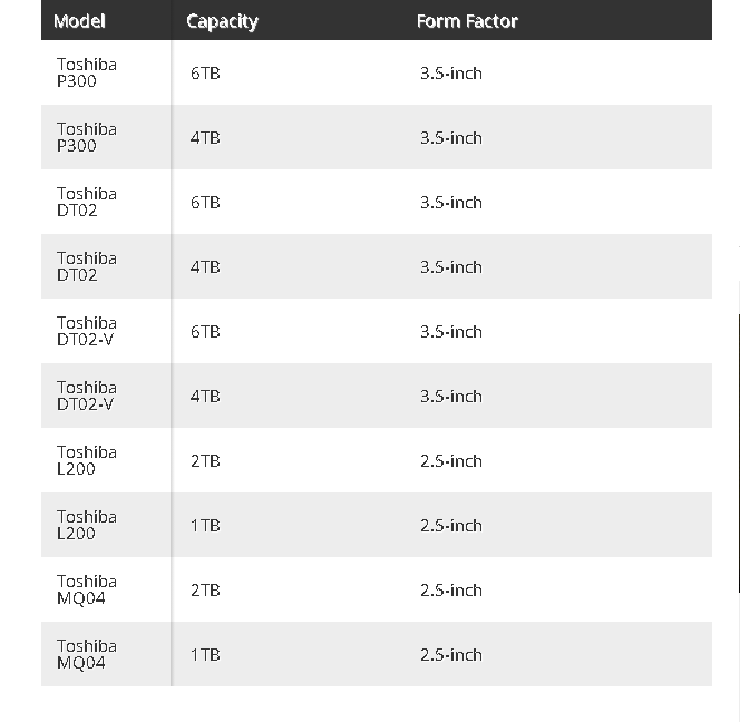

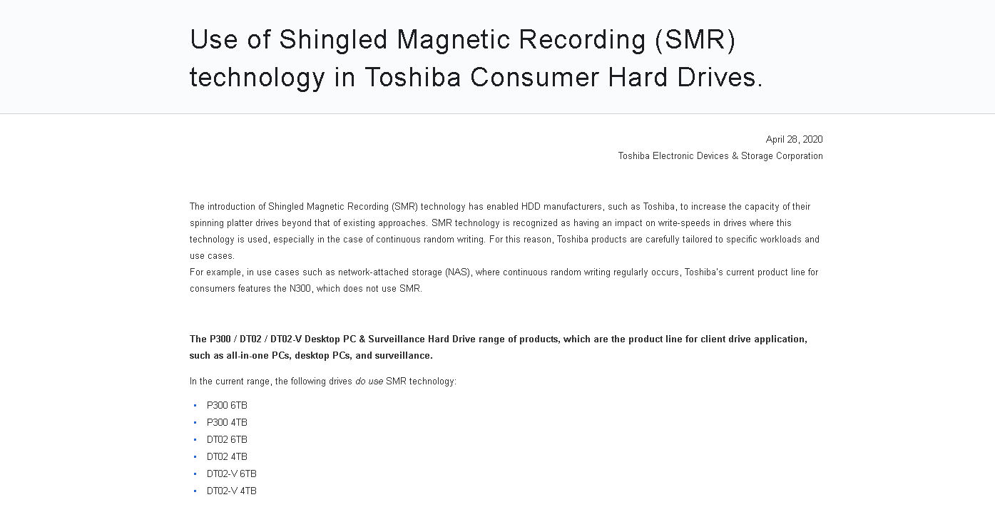

SMR are everywhere RED / BLACK Green , NAS etc.
Lardam has rightously said Mfrs. have hidden this information.

How Avergae Consumer or even technician will come to know which is SMR / CMR ?

There's this list of known SMR drives, on the TrueNAS site.

What WD and HGST hard drives are SMR?
https://hddscan.com/blog/2020/hdd-wd-smr.html
