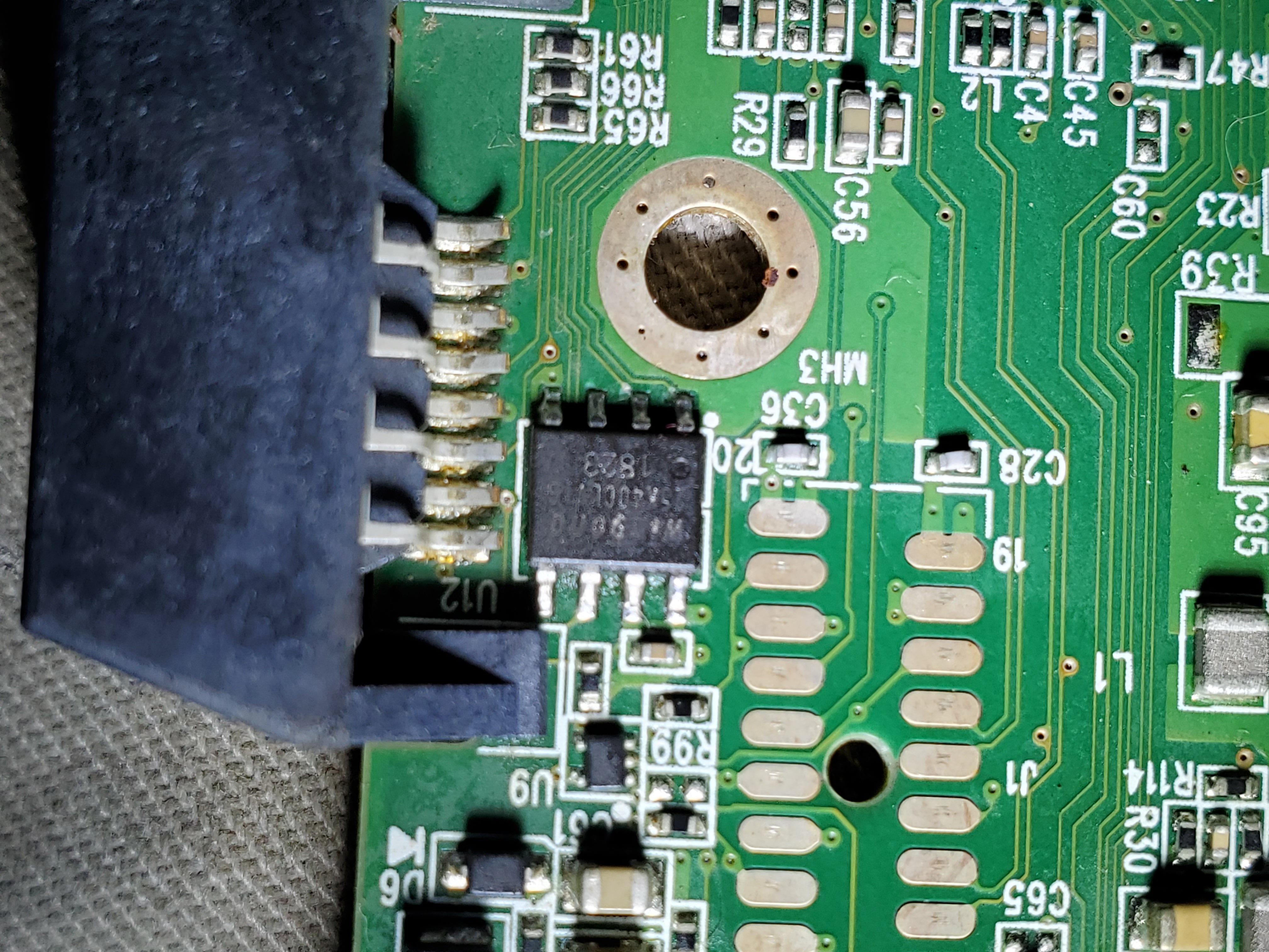

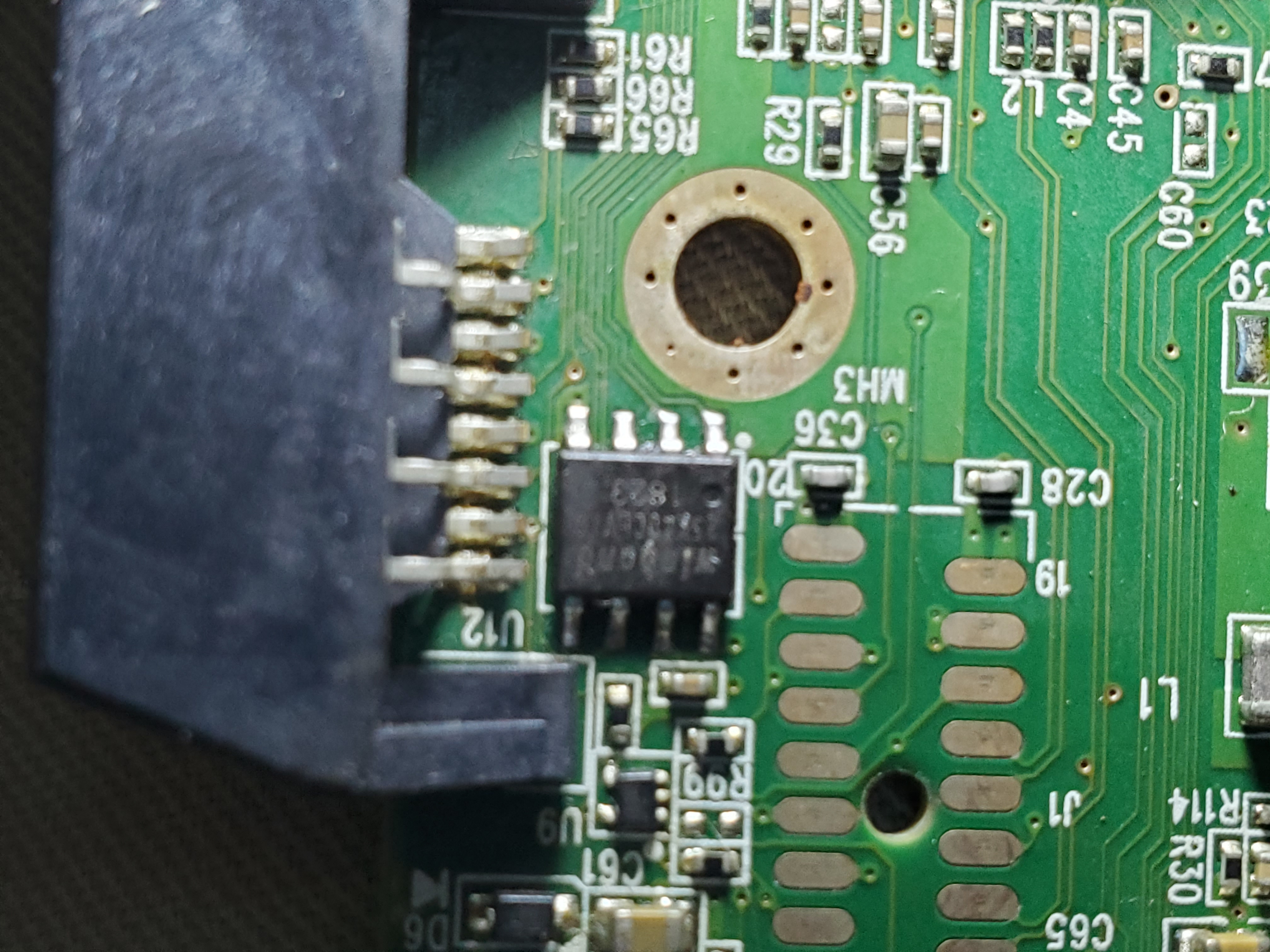

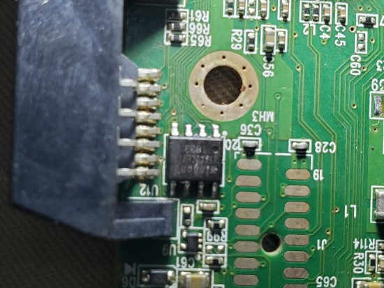

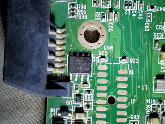

Lardman> I'm attaching two photos of the bios chip. They're really great, but they're the best I can manage with my phone. I took two so that both sides of the soldering job would be well lit. To my eye, the soldering looks to be good. No bridging or the like at any rate. I'm afraid I didn't think to take photos of the new PCB and the original PCB before dropping them off. But I did mark the old, failed PCB board before dropping it off. And looking closely at the BIOS chip itself, the markings on the chip on the new PCB look worn and faded, as I'd expect from an older chip. The BIOS chip he left with the old board looks brand new.
I DID pay a bit of attention to the orientation of the markings on the old board, and as far as I can tell the BIOS chip was installed correctly. Though it hardly matters at this point. From what I understand, if the BIOS was installed upside down, it would have been fried when it was turned on. Which leaves me back at square one anyway.
So, as near as I can tell (which is a pretty low bar) it looks like it's the correct chip, in the correct orientation, soldered in properly.

Soldering job looks good, nice and tidy and the correct orientation, the fact flux can still be seen is reassuring. As the drive is spinning it's not going to be the TVS diode on the donor although could have been on the patient.
It's looking more and more likely to be a firmware problem, getting something seen in the bios would help. You could try removing the PCB from the drive body and powering up to see if anything is shown in the bios. You're very quickly getting to the stage of needing tools (hardware and software) to progress things. I've not checked for a while but WDmavel may be the way to go if you really don't want to try a dr pro.
