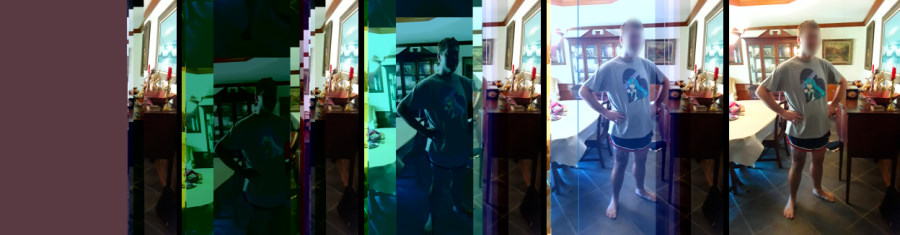

I sometimes spend same amount of time on repairing 5 severely damaged JPEGs that it would take to recover 100's of them from a SD Card in the first place. Something like this can easily take an hour:
No way that's part of the standard package! Suppose 50% of the for example 600 recovered photos is like that?
What if files were corrupt to begin with? I have had cases where people started with corrupt RAW photos, did follow all kinds of advice in end user forums and end up with files being lost all together. They have been digging the hole deeper and deeper before I get my hands on it but fail to tell me this story. They managed to make signature based recovery and file system based recovery as good as impossible! So, then they pay me recovery AND file repair, as before I can even begin to repair I need to figure out a way to recover the files in the first place.
