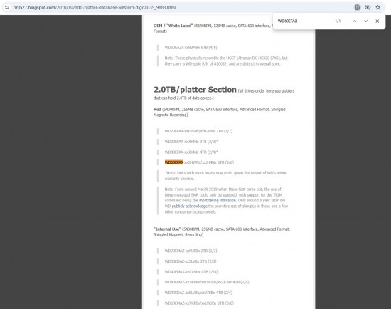

That's because this is a SMR drive, firmware is working in background.
Probably it also has active trim function as SSD do!
https://web.archive.org/web/20200417191 ... a_id/25185
https://support-en.wd.com/app/answers/d ... a_id/25185

From a firmware perspective, hard drives don't work as you think.
Many people believe that simply flashing the hard drive's firmware, perhaps by searching for a specific version on a dedicated website can change its functionality, like you would with the firmware on a CD burner or a TV.
Well, hard drives firmware is structured very differently; it's made up of modules, some of which are unique to the drive itself and therefore cannot be replaced.
For this reason, it's unthinkable to flash the entire firmware and expect the drive to continue working. The various updates that manufacturers release are nothing more than patches that modify only certain modules, and in any case, i don't think they release versions that allow you to alter/turn off the track reorganization functionality of an SMR HDD.
However, i wouldn't attempt to alter the trim functionality or SMR behavior in general. That would just kill the hard drive faster!
This makes sense only if the disk is experiencing physical problems (which your HDD most likely doesn't have, as yourself reported SMART doesn't indicate any problems) and you need to recover the data.
If your HDD is acting up, it's because you're not using it as intended by the manufacturer.
SMRs weren't designed for repetitive random writes, so i don't recommend copying and pasting numerous small files that might then be moved frequently from one disk to another and then rewrite again on your drive by filling all the space as much as possible. This would be a terrible use case because it would keep hdd to busy with SMR/TRIM operations. Also, this type of hdd isn't made for working on RAIDs systems!!
I recommend using this HDD for more sequential writes, such as large files like videos or image backups, which don't need to be deleted frequently and therefore need to be kept permanently in read mode.
If your hdd does a lot of noises (very busy) and you see that is getting slower, then you should stop abusing it!
I suggest to format it (do first a backup) and start using it properly as i explained.
