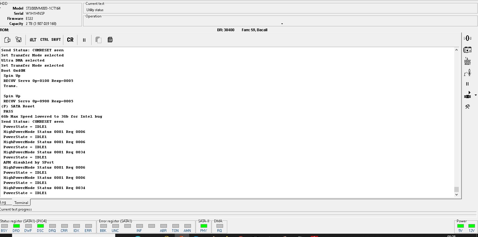

I have got seagate Bacall family disk , as per normal process I have backed up sys files. I have cleared SMP flags as well.
I have been successful to copy data from one partition (25mb/sec) so heads are healthy, but while copying from other now disk has become unstable.It is getting auto reset in loop (I have disabled soft /hard reset) . what could be the reason for this sudden behaviour ? I haven't touched translator or fired any command
as I am not fully aware of its implications (i4,1,22 etc) What should I do now as drive is getting power reset automatically in loop. I have to still copy aprox. 150 GB data.
terminal shows following-
Trans.
Spin Up
RECOV Servo Op=0900 Resp=0005
(P) SATA Reset
PASS
6Gb Max Speed lowered to 3Gb for Intel bug
Send Status: COMRESET seen
Set Transfer Mode selected
Ultra DMA selected
Boot 0x40M
Spin Up
RECOV Servo Op=0100 Resp=0005
Trans.
Spin Up
(P) SATA Reset
PASS
PowerState = IDLE1
HighPowerMode Status 0001 Req 0006
PowerState = IDLE1
PowerState = IDLE1
HighPowerMode Status 0001 Req 0034
PowerState = IDLE1

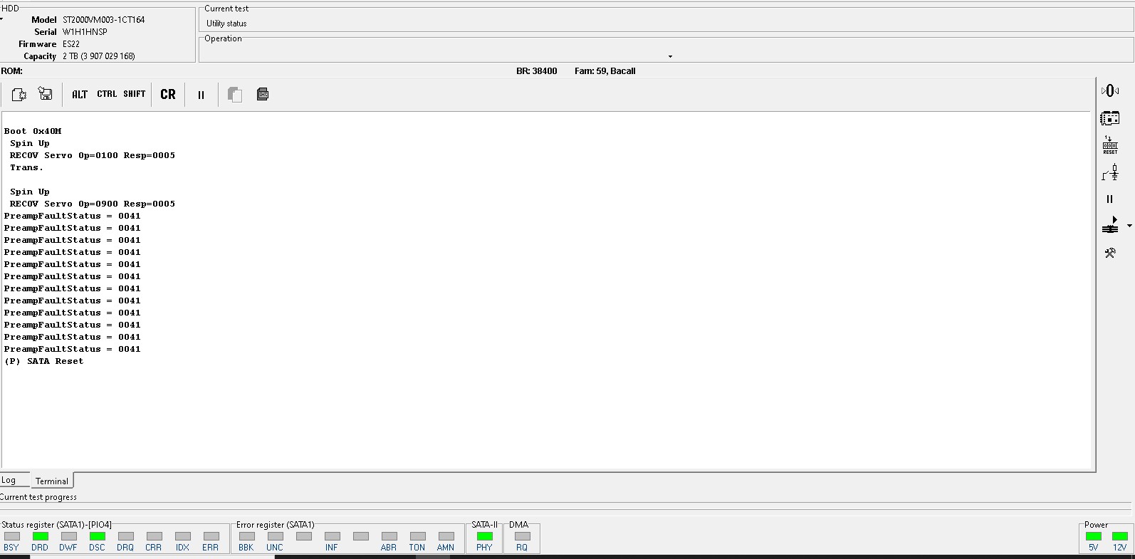

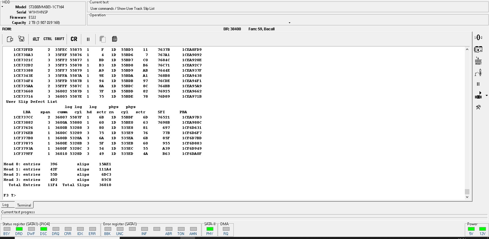

I want to add some more details here , when reading of head 2 starts then only restart loop event occurs ( I have disabled soft rest /hard reset). I think this has something to do with Head 2. All modules except 44 are ok .
Head resistance is as following -
F3 T>/7
F3 7>X
Head 00 Resistance 00F0
Head 01 Resistance 0145
Head 02 Resistance 00FB
Head 03 Resistance 0106

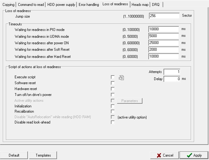

Can you post this screen please.
And an image of the map showing the start of either the skipped of bad blocks.
Couple of other things to try in DE.
Do your partition map
Sort by LBA in reverse
Change read order to reverse
Try stepping down the read mode to hardware failures
Increase skip size to 10K
And on a very small percent of drives (perhaps 1/500) disabling read ahead cache will help with stabilisation but absolutely kill read speed.
You should be safe to regen the translator and try that if you've backed up the module - but if I understand your diagnosis properly Id say platter damage.

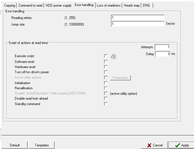

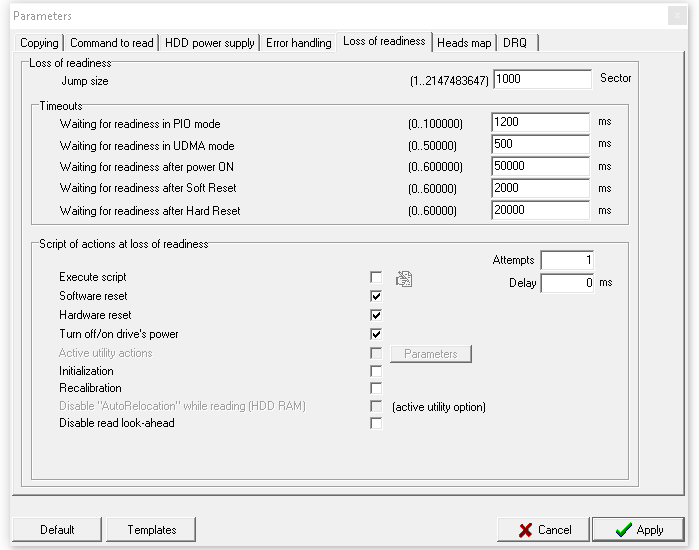

Hi Lardman
Here is my DE settings.
Now disk remains in permanant busy state , possibly heads have died by now. It is continuously power cycling on /off , though I have disabled this in DE. Even disabling Heads does not change switching on /off that means this has nothing to do with DE but something else.
Terminal shows following -
PASS
Boot 0x40M
Spin Up
Trans.
Spin Up
(P) SATA Reset
PASS
Boot 0x40M
Spin Up
Trans.
Spin Up
(P) SATA Reset
PASS
Boot 0x40M
Spin Up
Trans.
Spin Up
(P) SATA Reset
PASS
Boot 0x40M
Spin Up
Trans.
Spin Up
(P) SATA Reset
PASS
Boot 0x40M
Spin Up

Now Heads Have Gone ,But Data would have been recovered if you had used some different settings in DE ,I would urge you to go to youtube and checkout series of lectures from deespar to understand block size ,timings etc and then apply this to DE
