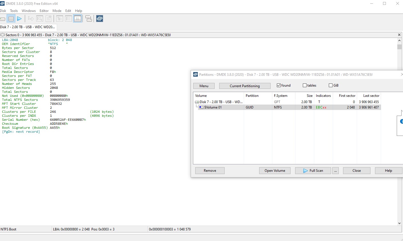

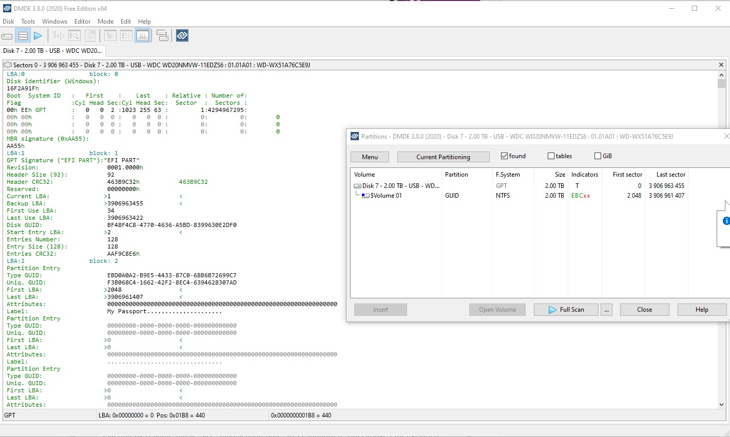

I've also completed the file restoration using DMDE. It worked slightly better than GetBackData. I was able to recover about 65% on my data most with original file names and directory.
Lardman suggested "Point something more sensible at the drive like DMDE and see what that makes of it." I've completed the data restoration but I'm a little out of my depth using the program for HDD repair. I've looked at the manual but don't see how to use the program for repair. I've attached the HDD reports.

DMDE's Indicators column shows "EBCxx". On a good NTFS volume it should be "EBCF". Usually this means that there is something wrong with the $MFT and $MFTMirr metafiles.
If you d-click $Volume 01, does DMDE show any files under the $Root, or does it want to launch into a file system reconstruction or scan?

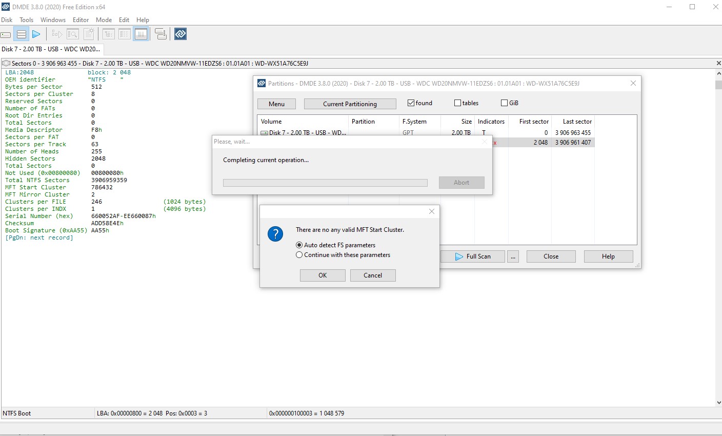

Here is the result of the d-click:

If there is no MFT start cluster, then why does Testdisk report that the MFT is valid???
Since you're experimenting, you could go directly to the expected location of the MFT and then page-down through the sectors.
The partition starts at sector 2048, and the boot sector is telling you that there are 8 sectors per cluster, and the MFT start cluster is 786432.
Therefore the start sector for the MFT is ...
2048 + (8 x 786432) = 6293504
In DMDE, select Editor -> Goto Offset, sector = 6293504.
Then select Mode -> MFT Record, or Mode -> Hex/Text, as per your preference.
You can then page-down until you find something interesting.
You could do this on a working volume so that you will know what to expect. DMDE will make you jump through hoops before it will let you write anything, so don't be too concerned.

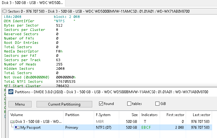

It seems odd to me that the last sector of the NTFS volume is 2048 sectors before the end of the drive (as seen over USB). Is this normal for this model?
 Post subject: Re: Why is my HDD seen as RAW
PostPosted: August 14th, 2021, 3:11
Posts: 1324
Can't say Id ever noticed, I don't have that model on the shelf but I've just checked the nearest my passport to hand and the MFT is also 2K short. AMPG as to why.

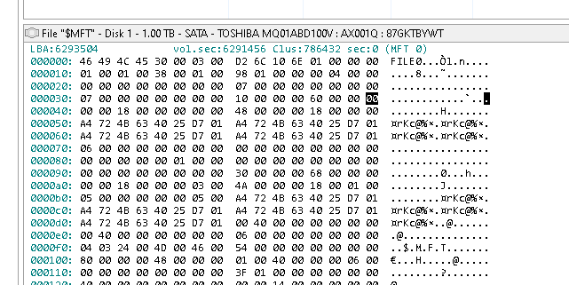

Lardman wrote:
Save it as a bin then either rename it or zip it and then post it. You'll need to look at the contents in HEX but even then it may not appear to make much sense.
Here's the zip file.
dev7_lba6293504_10000.zip [6.05 KiB]
Downloaded 856 times
PostPosted: August 14th, 2021, 15:16
Posts: 1324
That file is just 0's. Valid data should look a little something like this.
Your drive has an NTFS partition which ends on LBA 976707583. That's the last sector of the user area.
The OP's drive has an NTFS partition which ends on LBA 3906961407. The last sector of the user area is 3906963455. That's a difference of 2048 sectors. I just thought that was odd. The last sector of the volume would be the backup boot sector, so I'm wondering whether TestDisk looked for it in the wrong place.
I'm also wondering whether a 2TB drive now normally ships with GPT partitions rather than MBR. If not, then the drive may have been reinitialised with some tool which deletes the boot sector and FS metadata.
For example, let's say your 500GB drive were to be reinitialised and a new 500GB GPT partition created in place of the original MBR partition. The boot sector and FS metadata would be zeroed, and the copy of the boot sector at the end of the volume would be overwritten with GPT metadata.
