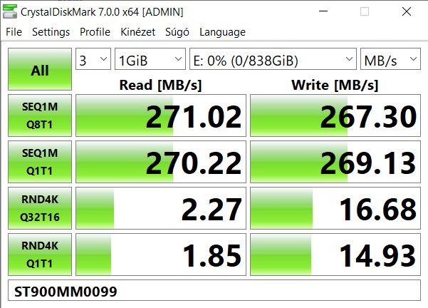

I could not find any proof that the ST900MM0099 has NAND cache, but I wanted to find out. The drive is quite fast:

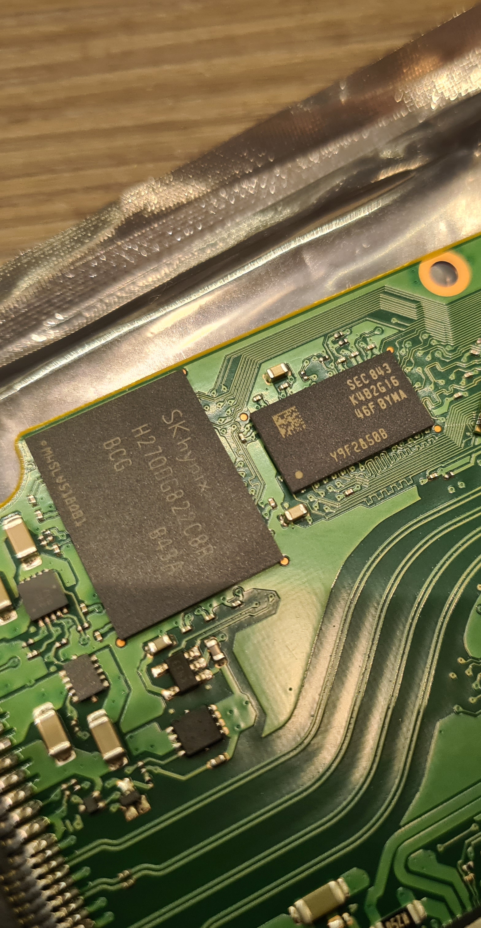

I had the idea of asking Seagate Support. First, they did not understand what I meant. They asked me to explain what eMLC is :) After a few round they have confirmed that while the drive has 256MB cache it does not use eMLC NAND cache. Bummer. Somehow I did not believe them and had the idea to carefully remove the PCB. Surprise:
Looking up the part numbers, to the right is a 256MB Samsung DDR3, to the left is... 16GB Hynix MLC NAND. :D
Now I kindly asked Seagate support to confirm if the drive has NAND cache installed but disabled (not likely).
