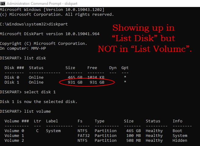

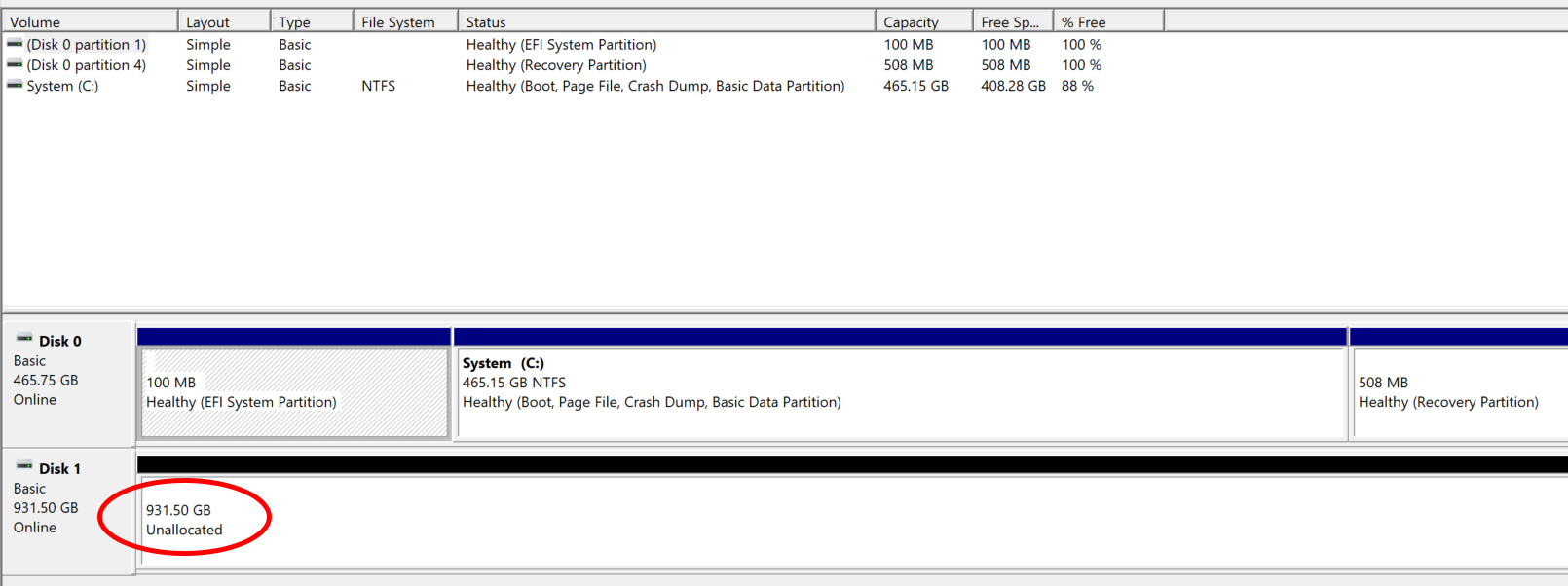

Hi. I have a HP latpop which has 256GB M.2 (OS) and 1TB HDD (Files). Recently I upgraded my M.2 to a larger capacity. When I am about to do a clean install, I accidentally deleted the 1TB from the Windows Setup. Problem is I can't find my external drive back-up. I didn't format the 1TB. Is there a way I can recover the files? I already tried EaseUS Data Recovery Wizard and Disk Drill. But unsuccessful.
Thank you in advance!

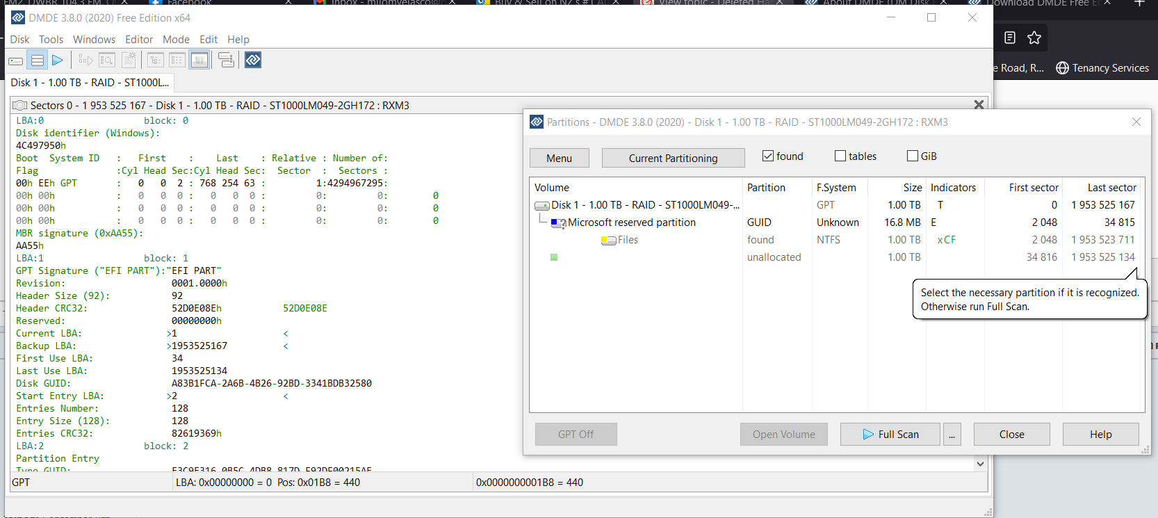

Show us the Partitions window in DMDE.

Is this the one?

Yes, that's the window. Select ''Files', click 'Open Volume', do you see your folders/files?

It seems to me that both tools should have recovered something. The fact that DMDE has found an $MFT and copy of the boot sector would suggest that the partition may not have been TRIM-ed, so that is a weird result.

The free version of DMDE would probably have recovered your data. If you had replied to Arch Stanton, we may have been able to show you what to do.
