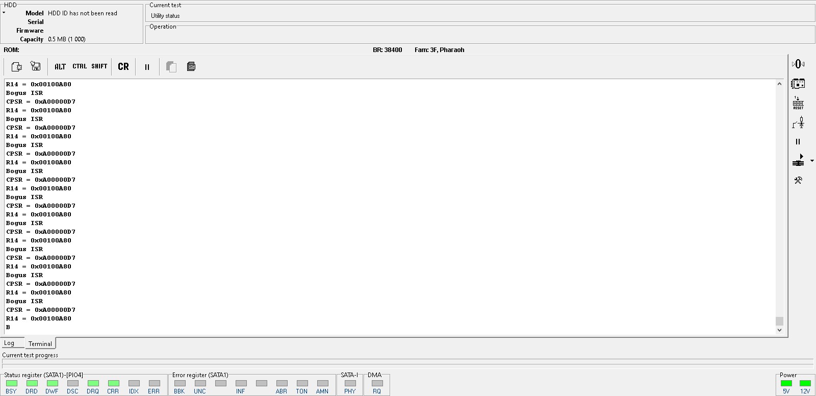

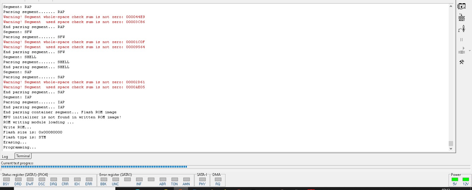

I am working on a seagate 7200.12 hard disk -- ST350418AS / FW CC45
When it came it showed pcb related symptoms ( all registers dimly glow ) , I have copied rom ( first time) using Revealprog -IS eprom programmer.
Copying was successful , I have selected flash 25 XX40 series and 3V , 512KB rom was copied.
I have written this rom in several pcb's 100535707 REv. B , I have got pcb no. matching except rev . which was C instead of B.
Disk does not give detection on any pcb and gives strange terminal.
I want to know whether this happens when rom is read using eprom programmer ? or something is wrong in my reading.
I have attached rom , can someone pls. check whether it is having any errors while reading. When I open this rom image it shows proper model /sn in utility.
here is terminal.

That's either a bad read or the rom is in a very bad state.
Read it a few more times with programmer to see if the files are the same.

several objects are corrupt in your rom.

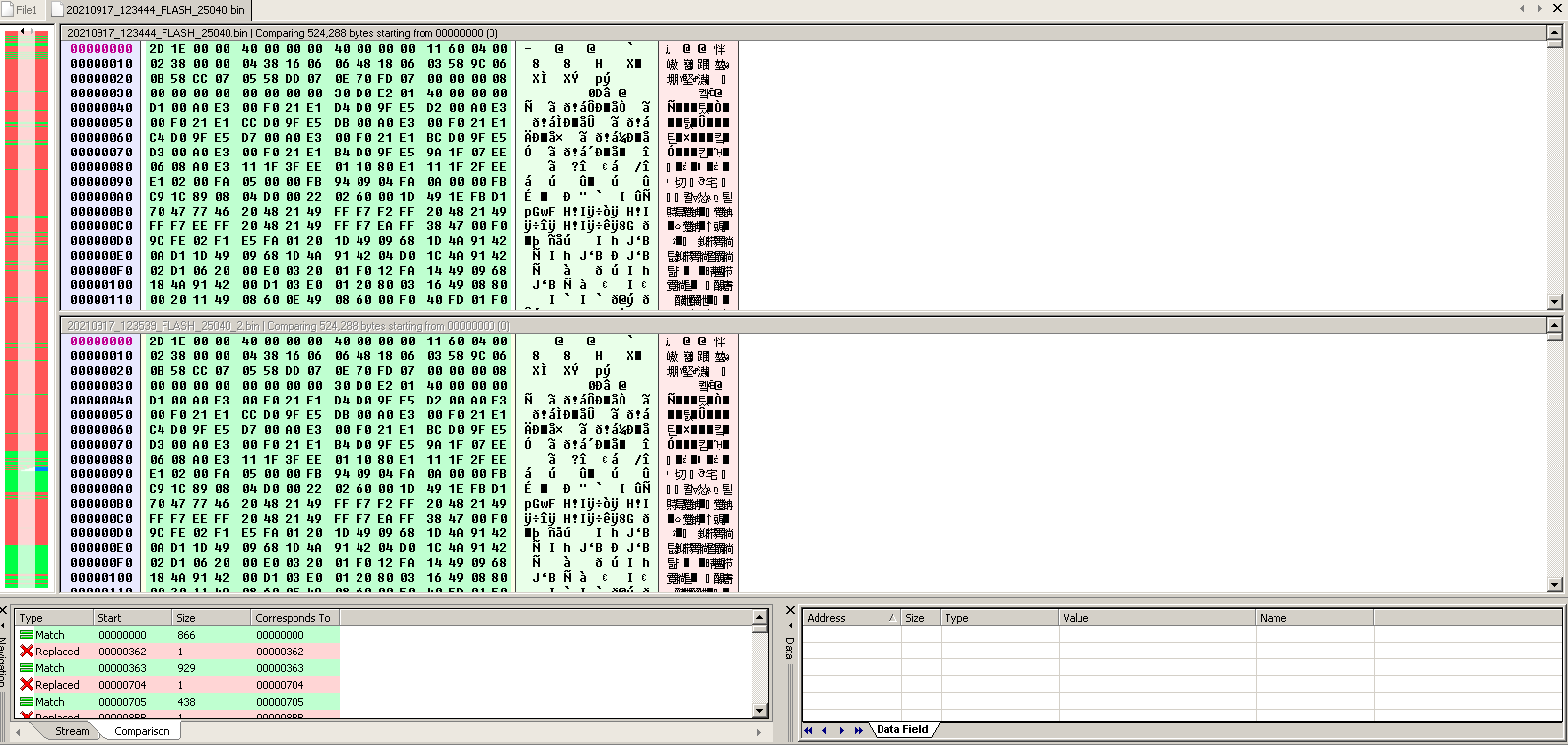

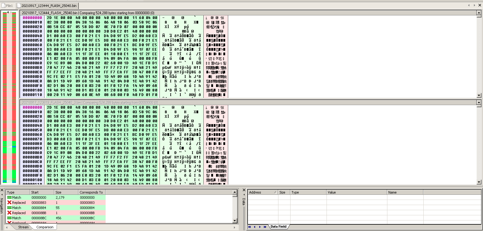

I have read rom 3 times again , but I have found that there is differences in each files.
Also attached is video of entire reading process , may be I am at fault while reading eprom.
I am sure all 3 files will be having some errors. I think since exactly same chip was not present in database (winbond 25X40AL014 ) programmer might have read wrongly. SHA256 checksums of all 3 files are different.
Here is all 3 copies and reading video.

Needless to say if you were getting a good read all 3 would be identical. Whilst the cap if fine in all of them there are errors in the rest. How are you physically connecting to the chip - clip or ziff socket?
Solder the chip onto a donor board and read it from the pcb via terminal from PC3000.

i tried correcting RAP based on the last 3 readings but it does not work out (crc still bad), the corrected dump still differs at a lot of points from the first dump and what's very strange they are not single bit differences, rather values incremented or decremented (13 vs 14, 19 vs 1A).
At other places values are replaced with 3F no matter what they are in the other 2 dumps.
dunno how to explain this behaviour...

After comparing the RAPs ...
Comparing files 00061848_DL_RAPM_bad.bin and 00061848_DL_RAPM_BAD_2.BIN
00000E28: 3F 6A
00000EAA: 3F 41
00001660: 7A 3F
0000276A: 3F 6C
00002B5A: 3F 43
00002E44: 3F 7C
000030B2: 3F 43
00003442: 3F 43
00003694: 7C 3F
000036A2: 43 3F
0000373A: 43 3F
000037D2: 3F 43
0000386A: 43 3F
0000399A: 3F 43
00003A32: 3F 43
00003B62: 43 3F
Comparing files 00061848_DL_RAPM_bad.bin and 00061848_DL_RAPM_BAD_3.BIN
00001660: 7A 3F
00002B5A: 3F 43
00002D22: 43 3F
000033AA: 43 3F
000034F7: 54 3F
00003694: 7C 3F
000036A2: 43 3F
0000372C: 7C 3F
0000386A: 43 3F
00003B62: 43 3F
Comparing files 00061848_DL_RAPM_bad_2.bin and 00061848_DL_RAPM_BAD_3.BIN
00000E28: 6A 3F
00000EAA: 41 3F
0000276A: 6C 3F
00002D22: 43 3F
00002E44: 7C 3F
000030B2: 43 3F
000033AA: 43 3F
00003442: 43 3F
000034F7: 54 3F
0000372C: 7C 3F
0000373A: 3F 43
000037D2: 43 3F
0000399A: 43 3F
00003A32: 43 3F
It seems that 0x3F features in every bad comparison.
0x43 is common, too.
