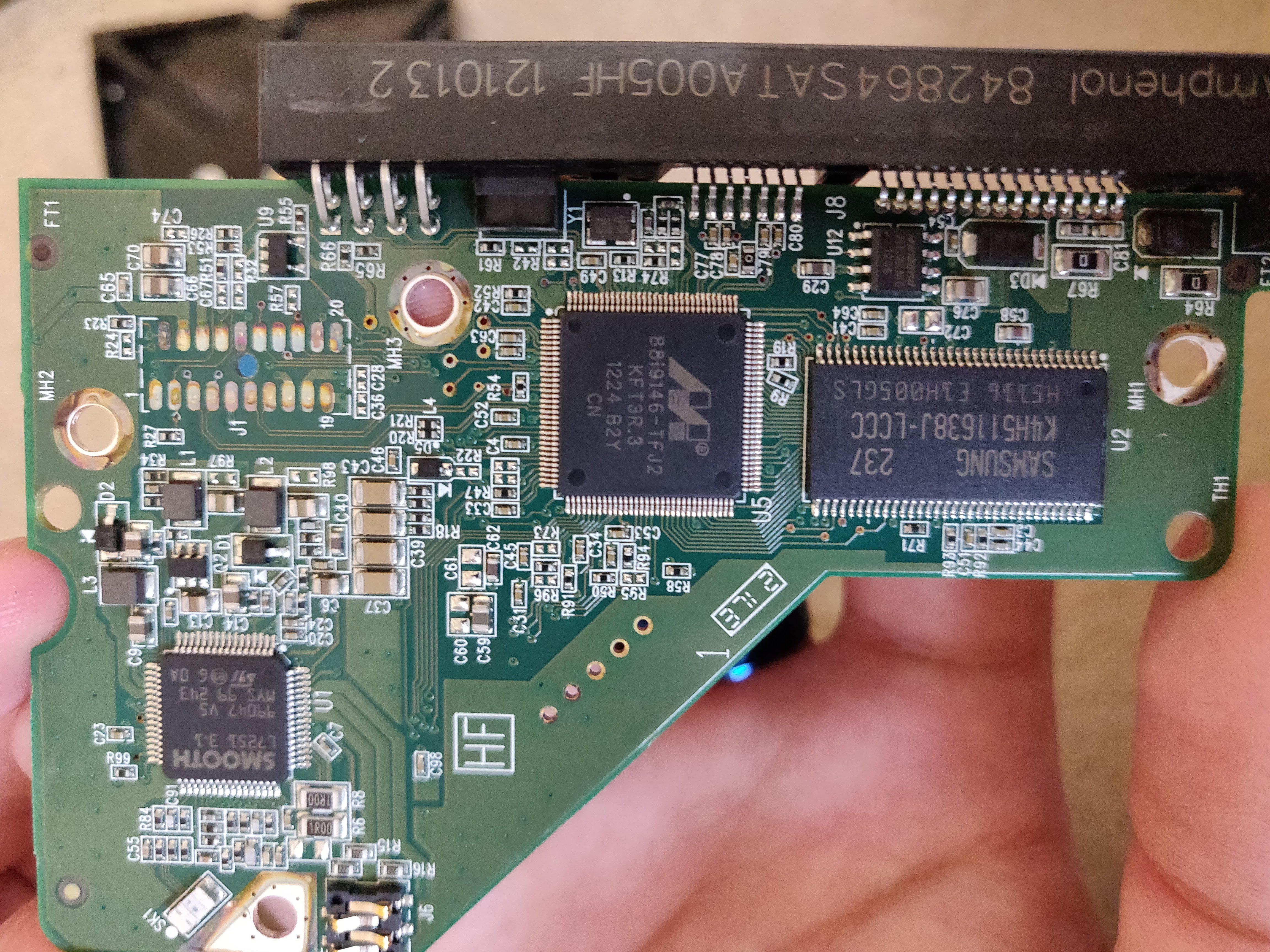

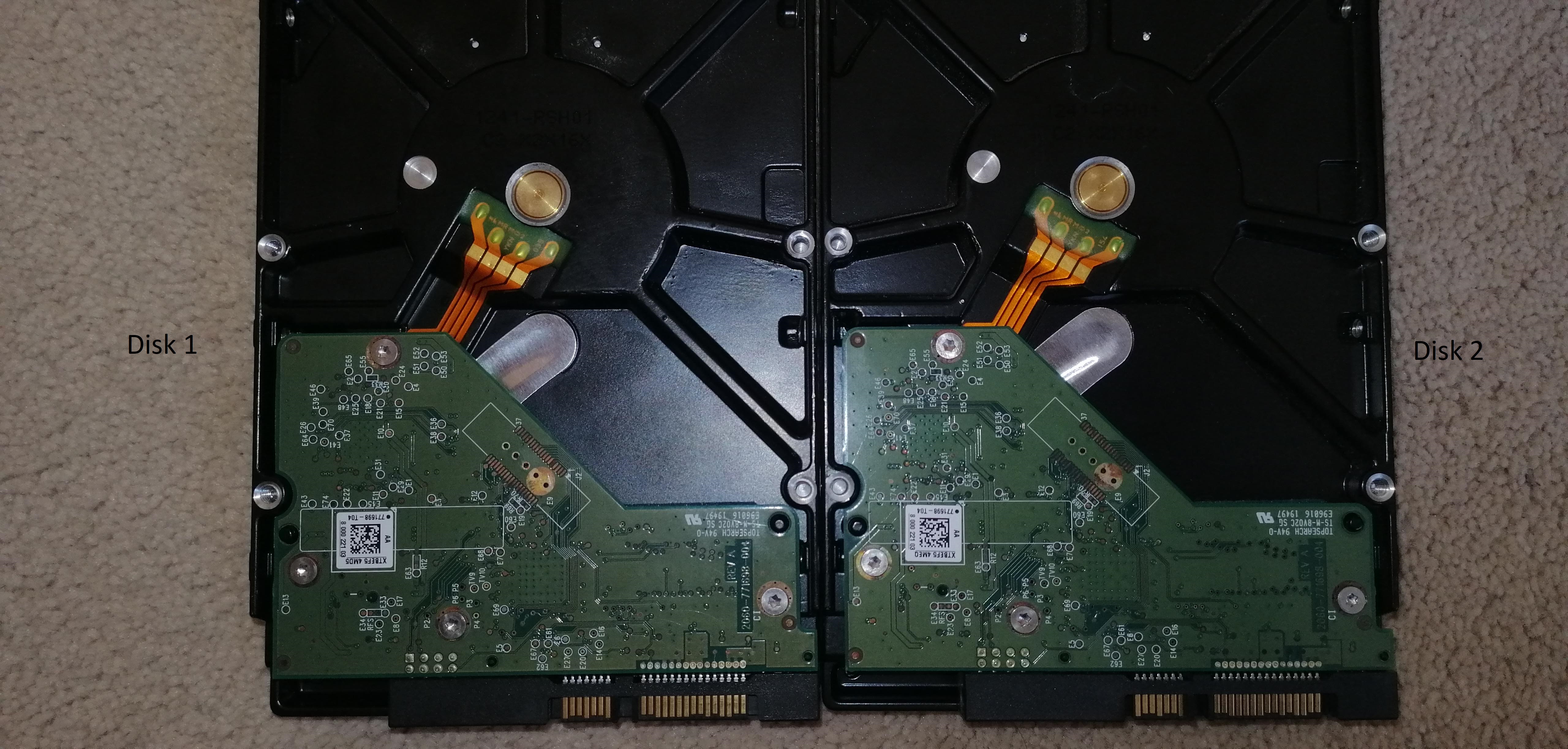

Here are the best pictures of the PCB I could get:
Disk 1:
Both Disks:

Hi all, Attached are some more pictures of the boards.
pepe, What is a TVS?
and Lardman, yes I have a multimeter.
If you need pictures of the other side of the PCB let me know and I'll get some :)

Hi all, here are some images of the PCB:
Disk 1:
https://hissmarthome.uk/f/disk1.jpg
Both:
I have high-quality versions of these but the forum won't let me post them.
And yes I have a multimeter.

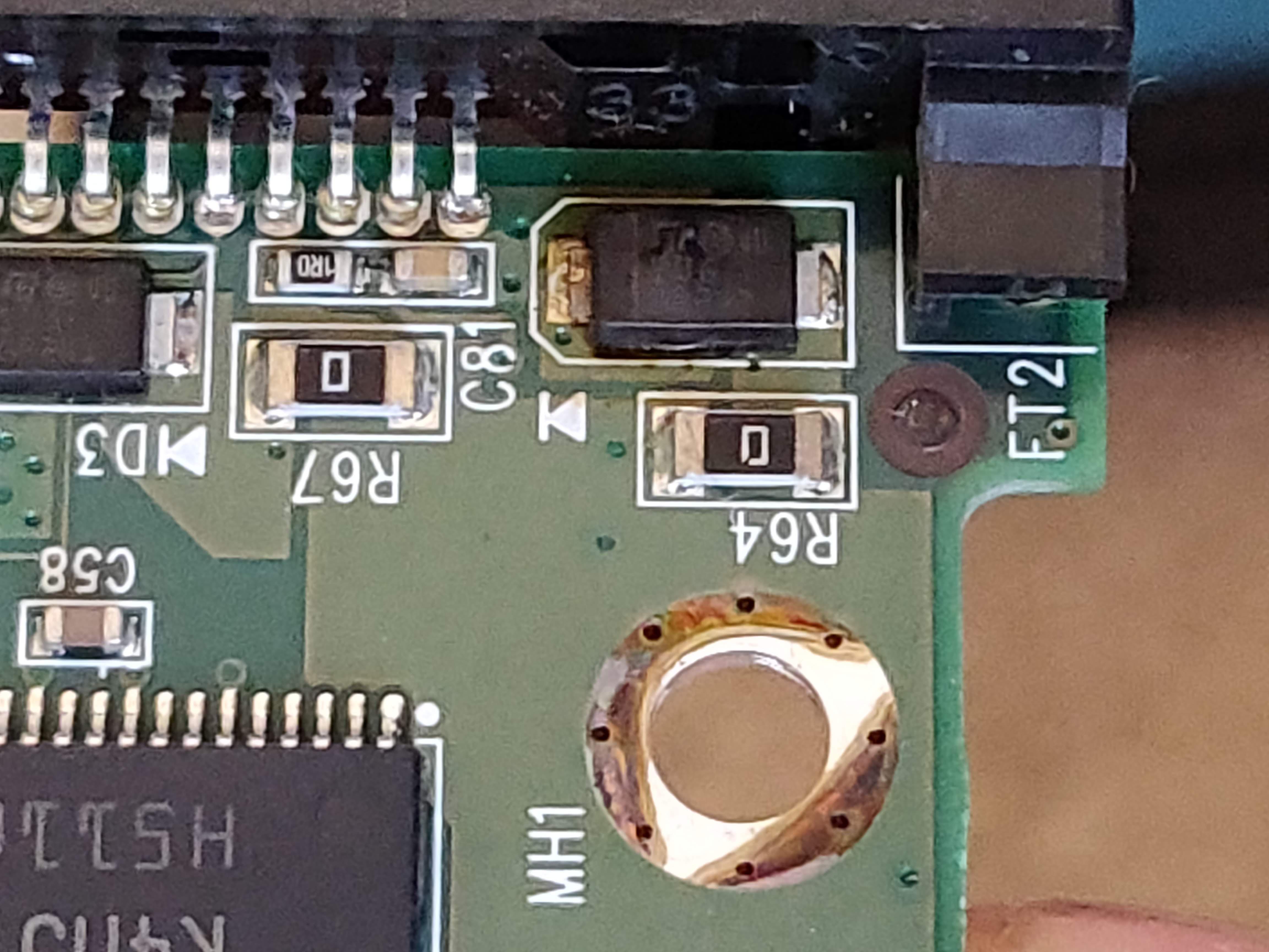

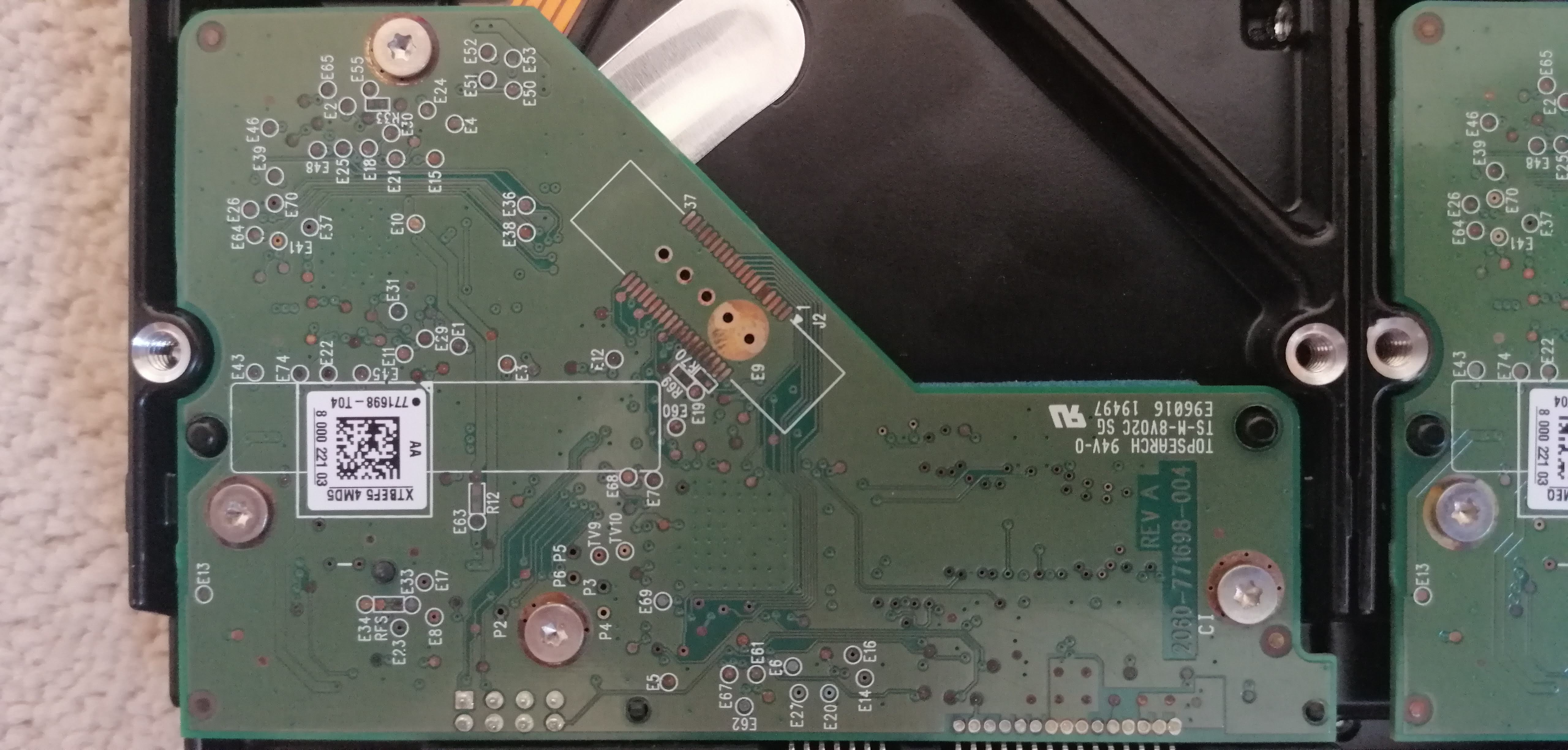

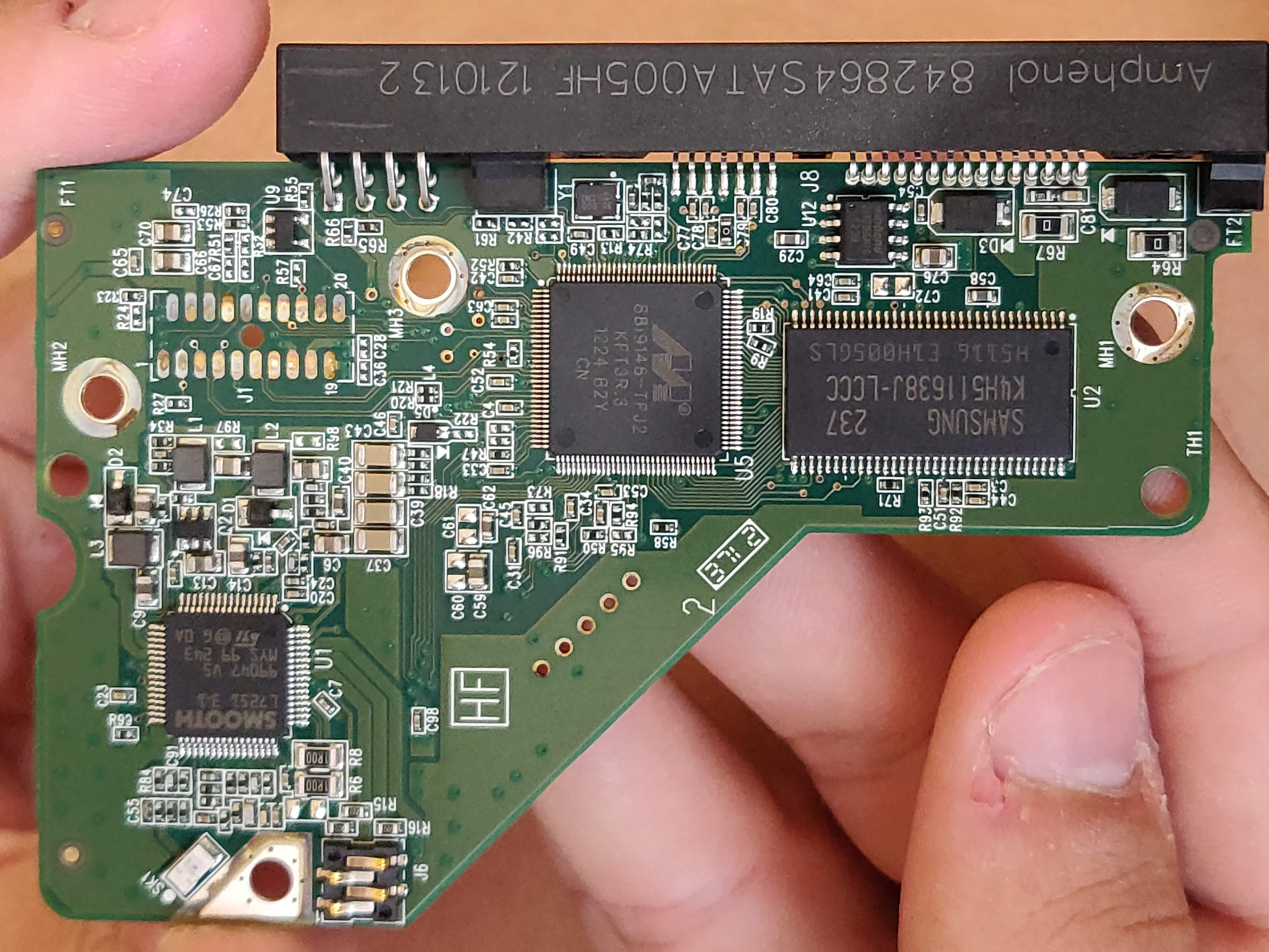

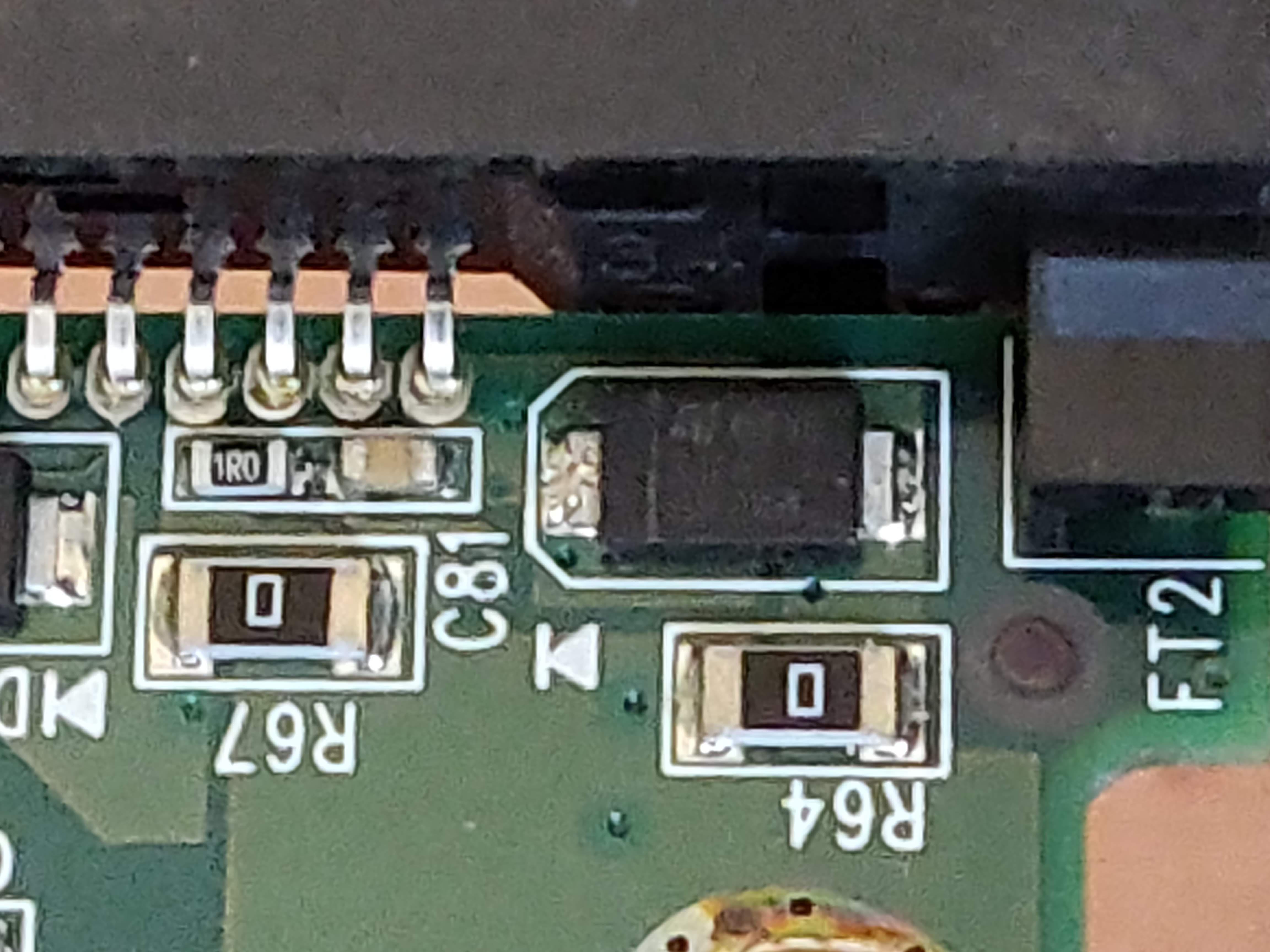

Here are the images of the other side of the HDD PCB:
Disk 1 TVS:
Disk 1 Whole Board:
Disk 2 TVS:
Disk 2 Whole Board:
To me, it looks like the TVS on Disk 1 has blown up! :shock:

TVS looks rather toastie, external rom which is good and smooth at least looks ok. Meter the diode confirm it's gone and remove. BEFORE applying power again check the diode pads for resistance to ground and check there's continuity on the 0ohm resistors.
Apply power to the PCB only that way the drive is safe if nothing go bang you can think about putting it back on the drive and powering up. If things start to click or scratch power off immediately, it's no longer a DIY job. If there's still no spin there are voltages to check and the external rom makes a board swap easier.

It looks like a straightforward diode snip to me. R64 apparently survived, so it should cost $0 at this point. Clicking might be something else, though.
No need to frighten the OP.
