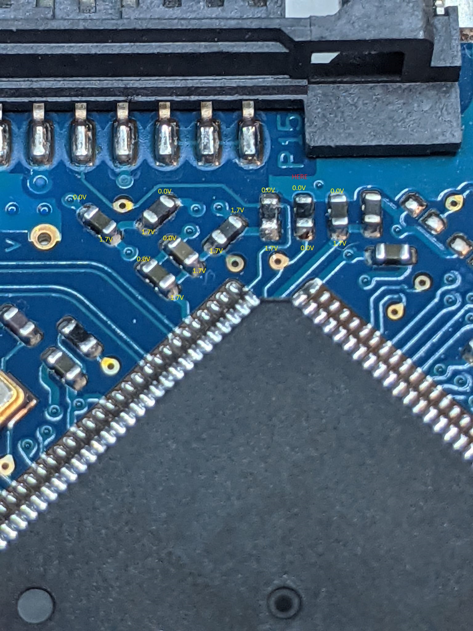

I got one of those lovely SSHD drive. It was in a laptop and customer connected the wrong power supply, PC burned... HDD no longer spin. I get a BSY only on PC3K, no sign of life, no motor, no head noise and no terminal, so let's hope it's only a diode or resistor.
Is the schematic availaible somewhere ?
One of the component (cap ?) has 0V on both side. If I measure with diode mode, I get 0 on top and 0.8 bottom
Suri
So funny...
I have a working one here, the diode is to the left of your picture, 1.7v is the same with a quick check although I'd need to recheck all the places you have measured. PCB on it's own draws a steady 0.26A. Is that a burn mark, hole or artefact on the chip?

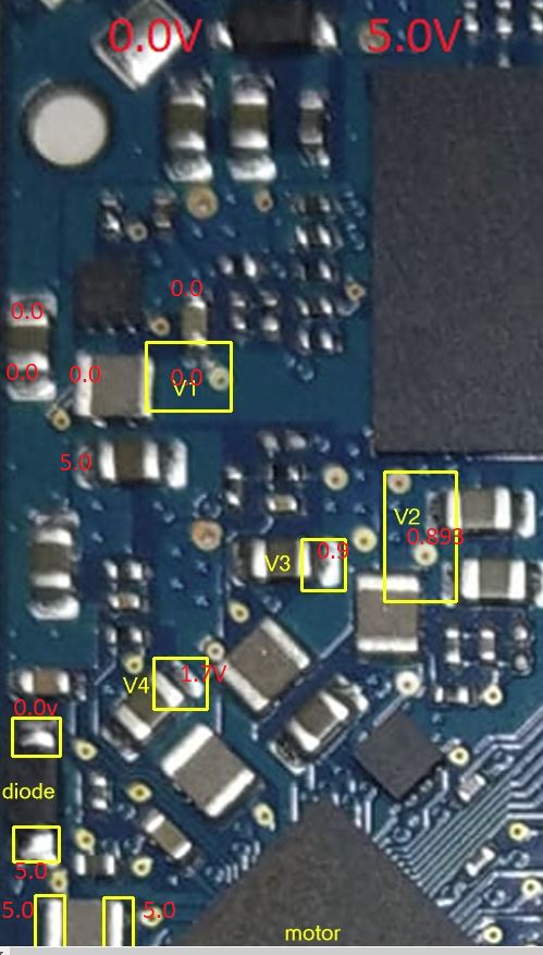

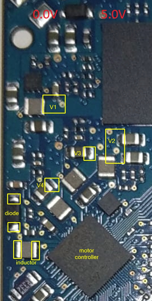

I would measure the following test points:
 Post subject: Re: ST500LX012 - Ultra Mobile SSHD - Short on PCB
PostPosted: September 22nd, 2021, 2:36
Posts: 191
Location: Switzerland
Thank you. Area near V1 is all 0.0V

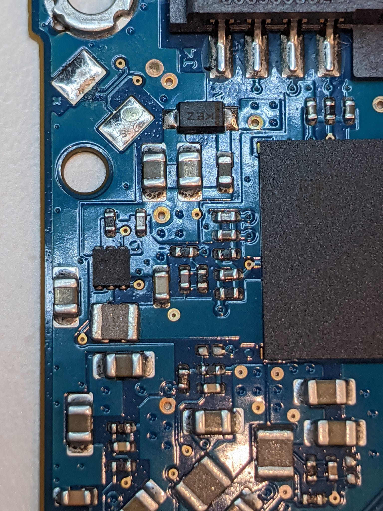

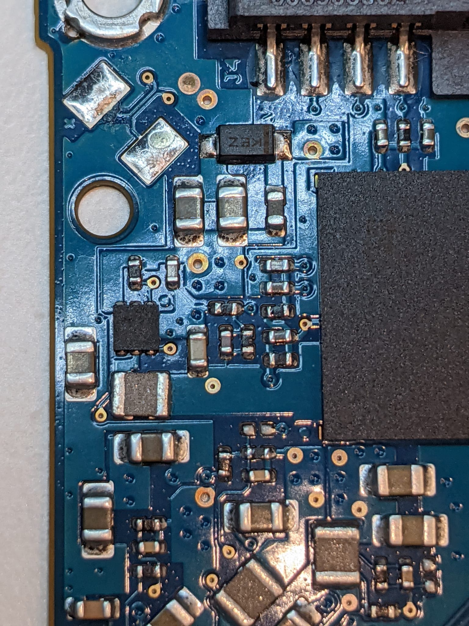

Posts: 17230
Can you provide a better photo of the area around V1, including the DC-DC converter chip? Can you tell us the markings on the chip?

The Marking on DC-DC is
7188
418A

Posts: 17230
Check the enable pin (pin #1). If it is low, then the IC is not being switched on.
LX7188, Microsemi, 1.4MHz, 1A Synchronous Buck Converter, 2.5V - 5.5Vin, marking 7188, UDFN 2x2-6L:

Posts: 17230
Lardman wrote:
My PCB (100726606 REVA) is different around that area I have 10v floating about there on the diodes.
V2 and V3 appear to be Vcore supplies (0.9V).
V4 (1.8V) is Vio.
I expect that V1 would be the 3.3V supply for the NAND.
The upper diode (KEZ) is a 5V TVS diode (SMBJ5.0A), so the voltage at that point should not exceed this value.
http://www.smdmark.com/en-US/search/code?id=ke
I don't understand the function of the diode nearest the motor controller. It is usually involved with the negative supply for the preamp, or a boost supply for the VCM circuit. In more recent designs there are two diodes for the micro/milli-actuator supply, at least in WD's case.
The MCU normally tells the motor controller to switch the preamp supply on or off. It may also control the NAND supply as a power saving measure. Therefore it could be that the MCU is dead, or the ROM may be corrupt. A ROM dump would be needed to rule this out.

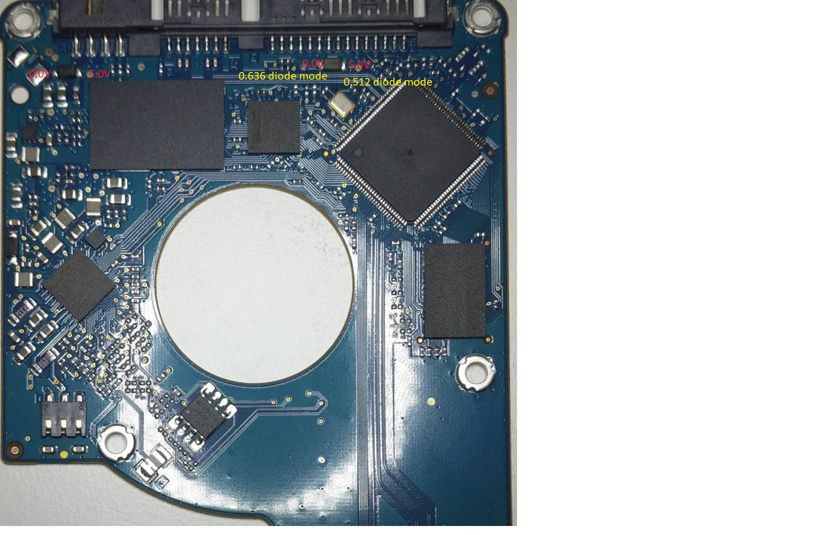

Is this model supported by MRT and PC3000?
I notice that there is a NAND-less version of the same family, namely ST500LT032:
https://firmware.hddsurgery.com/index.php?manufacturer=Seagate&family=Angsana_5400
Does the SSHD PCB share the same MCU and motor controller (88i1067-RAH2 and 100723016)?
https://m.media-amazon.com/images/I/8186uqkbYyL._SL1500_.jpg
If so, try uploading a ROM from an ST500LT032 dump, after patching the adaptives. I can patch them, if necessary. Hopefully there are no NAND related modules in the SA. In any case, if the drive spins up, then this will narrow down the fault to the NAND.
