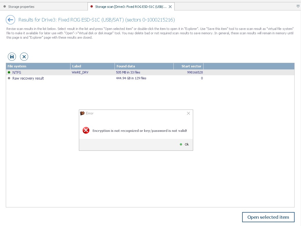

I have got a case of 512GB M.2 SSD from Thinkpad laptop. After windows updates suddenly Bitlocker has started to appear and asking for key.
Customer has not enabled it earlier ( by default it was enabled ). In fact customer was not aware of what is Bitlocker.
manage-Bde shows numeric key +TPM protectors.
I will give it a try using UFS explorer.
Thanks again.

I tried UFS explorer but it failed to decrypt the volume. What should I do now ?

Is there any way to read key from TPM directly ? I have asked customer to give his microsoft account details as well.
It seems protectors are not weak or "clear key" metadata is not present.
I am also sending it to one of my friend who is having updated DE.
