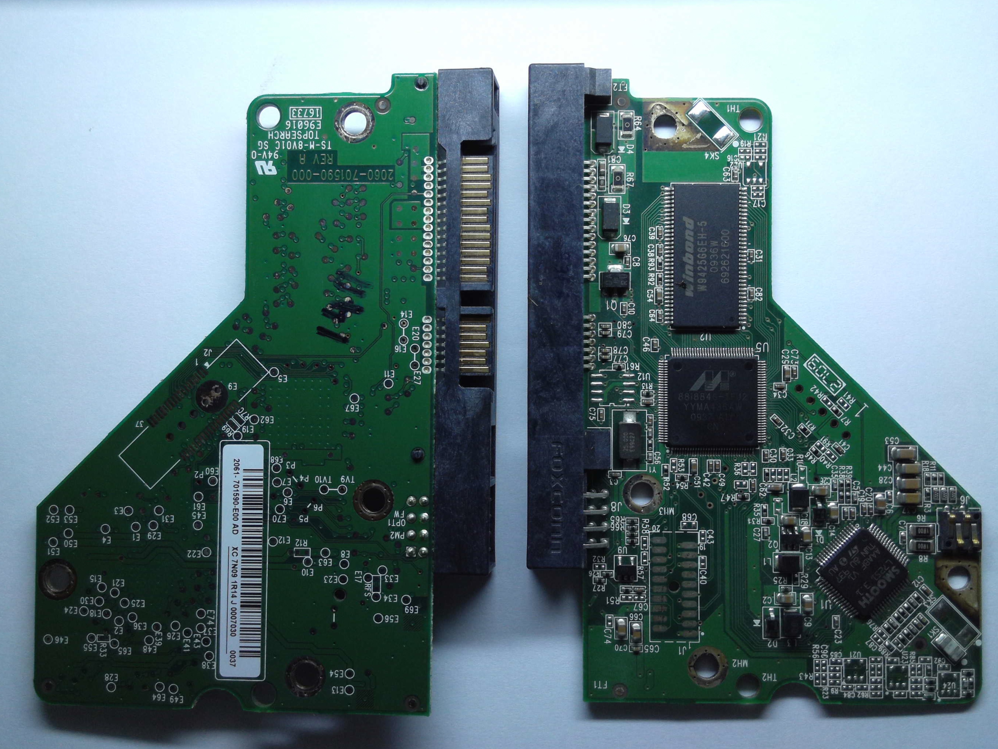

Have 500GB WD With 2060-701590-000 Rev. A
HDD no spin and bsy
Had Read ROM using WDMarvel. I don't have Donor PCB.
I tried with 2060-771590 hdd spin So no Motor issue
here attached PCB Picture from Net (My camera Image is not good, PCB has no Burned Sign)
Someone guide check Points to repair PCB
 Post subject: Re: 2060-701590-000 Rev. A - No Spinup
PostPosted: October 22nd, 2021, 3:14
Posts: 1323
Continuity at R67, R64 , D3, D4.
Voltages at L1,L2,L3
PostPosted: October 22nd, 2021, 3:44
Posts: 347
Location: india
Continuity at R67, R64 , D3, D4. - OK
Voltages at 1.16v L1 1.22v , 2.53v L2 2.55v , 0.0v L3 0.0v
PostPosted: October 22nd, 2021, 6:06
Posts: 1323
Same from a known working 2060-701590. Any errors on the modules?
PostPosted: October 22nd, 2021, 9:45
Posts: 347
Location: india
Got PCB from Local market for Rs. 200 (have to search Many Places)
After Rom Transfer HDD works fine.
Thx for your support

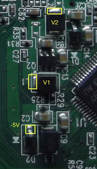

PostPosted: October 23rd, 2021, 15:32
Posts: 17341
These are the voltage test points.
