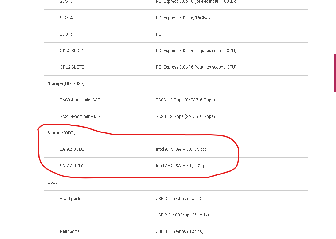

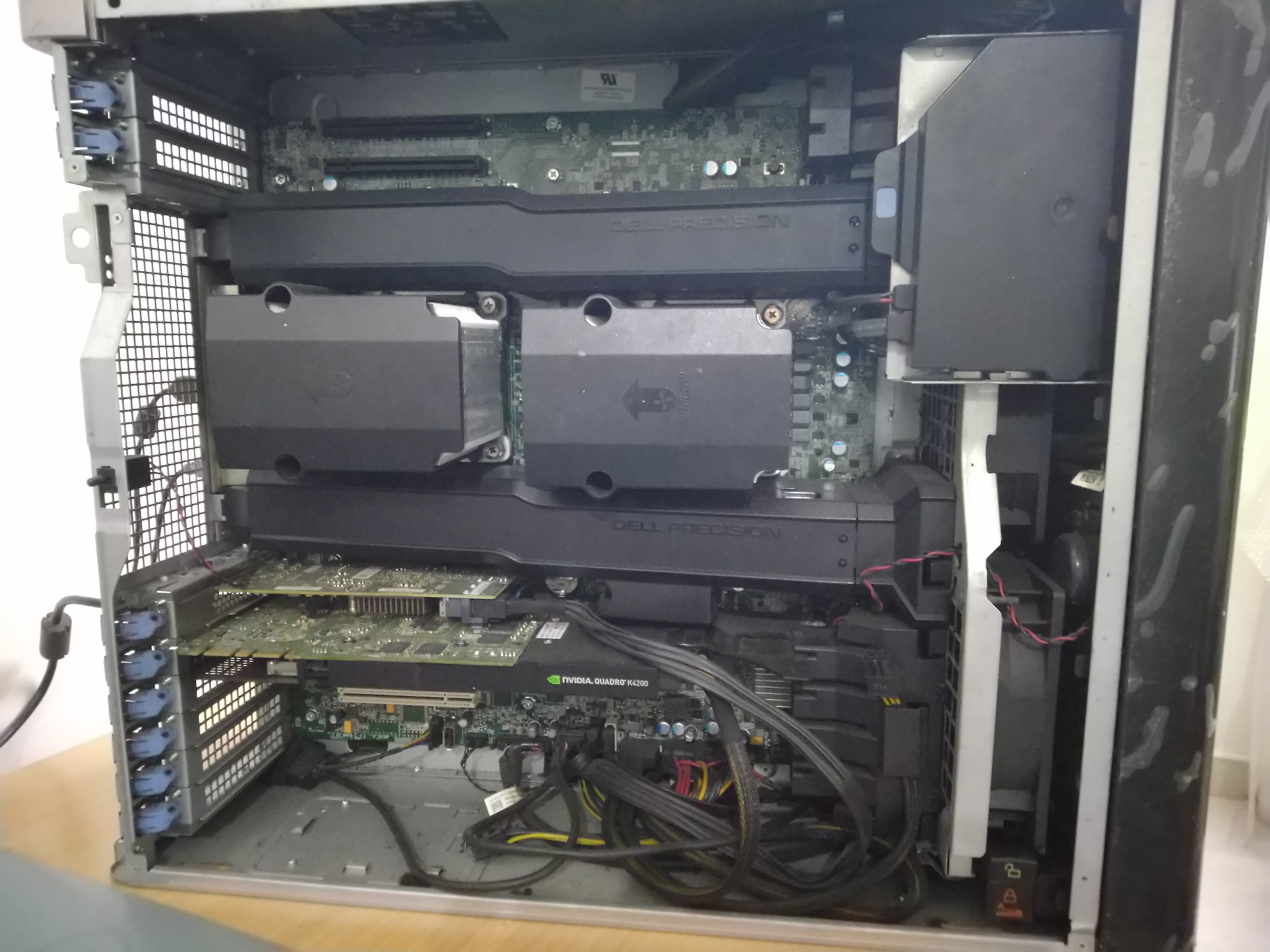

Dear friends
I have got this device It has SAS drives in Raid 5 configuration. I have go success with recovery part and Data is verified and approved as well.
Now I am facing problem how to copy this data due to its size ( 10 TB with 3.9 million files)
Can someone pls. give some Idea how I can I copy data ? Attached is snap of the tower. It is having mini 4 port SAS controller. But no additional SATA power /ports etc. Is there any option to add pci express based SATA card as tower has pci /pci express slots besides 2 gigabit ethernet ports. Manual lists 2 SATA ports but I could not locate them.
Another concern is I am booting workstation using winpe with limited drivers. So drivers should not be the problem.
Any suggestion who has already done recovery of such models.

 Post subject: Re: Dell Precision Poweredge 7910 Raid recovery query
PostPosted: October 22nd, 2021, 3:10
Posts: 1312
Looks like something is plugged into the sata - white and black vertical ports on the bottom of the motherboard - follow the cables.
Either connect the destination via USB3, disconnect something not in use DVD? or just slap an extra sata adapter in and use a few power splitters.

Yes this workstation has SATA dvd writer which is caddy type .Its power supply is different and not standard .
