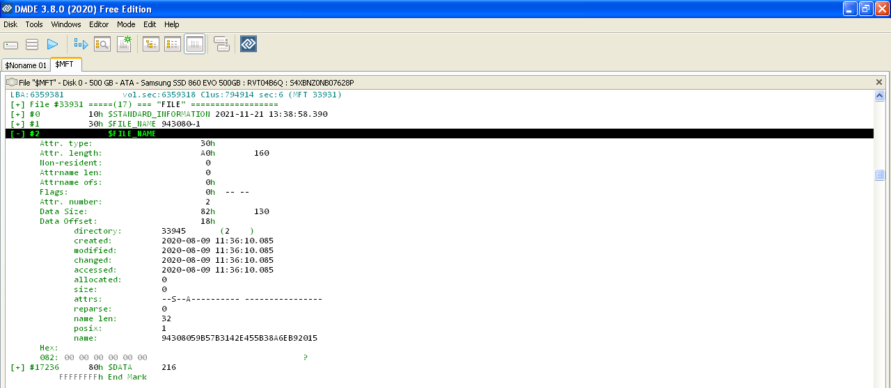

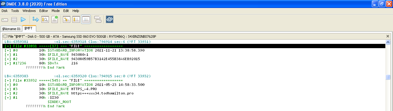

It is my first time using DMDE, I followed your instructions, and I made few Screenshots. Editor > File Record > hex: 848b > OK:
Under $FILE_NAME I see a long number: 943080... - is that the real name of the file?
Can I see the file extension? Example: Car.jpg or Notes.txt .
Can I see the file size? 5 KB or 3 MB?
Can I see the file location? Example: C:\Program Files\Windows Media Player\wmplayer.exe
I am sorry for all these questions, I am a novice at using DMDE and I don't know what it can/can't do.

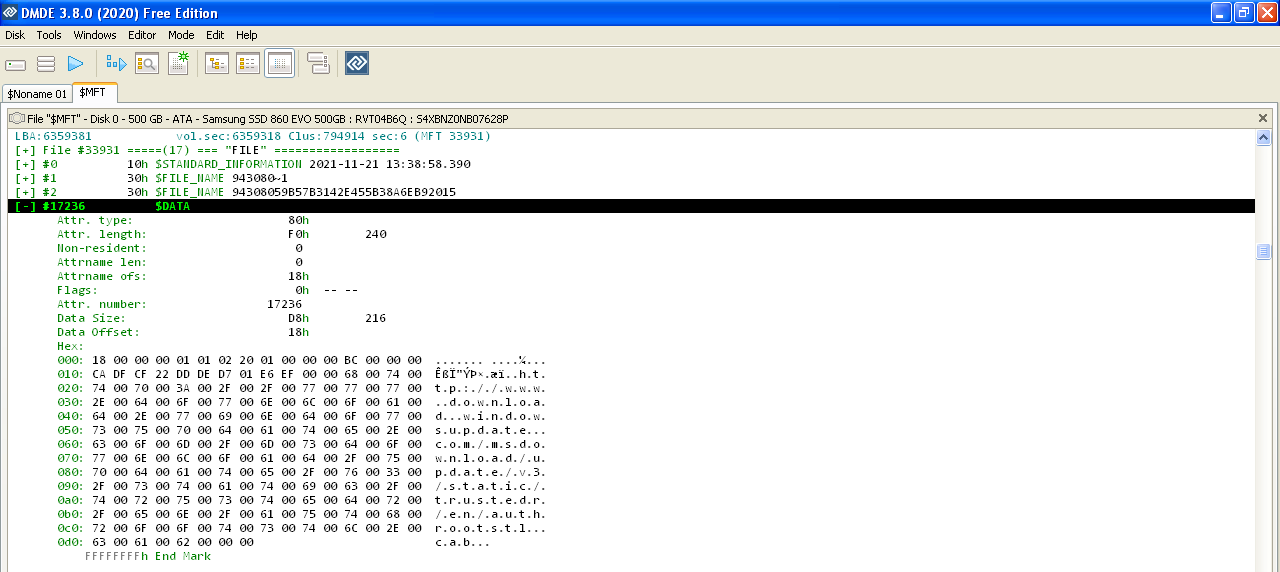

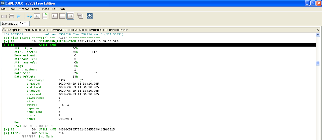

#1 is the 8.3 (short) file name. That's what DOS would see (if it could understand NTFS). The name of the file is condensed to 8 characters, and the extension is condensed to 3 characters.
#2 is the full name of the file.
The file's extension is always displayed. If no extension is displayed, it's because the file has no extension.
The file size is reported as "Data Size" under the $DATA attribute.
In your example for MFT #33931, the file name is "94308059b57b3142e455b38a6eb92015", no extension.
The file size is 216 bytes.
Since the file is very small, the whole content of the file fits within the spare space inside the MFT record. Larger files store their content in clusters elsewhere on the drive.
The $MFT is the master file table, an NTFS metafile which stores the information about each file.
To see the full path of the file, you need to walk up the directory tree. I'll try to provide an example in my next post.

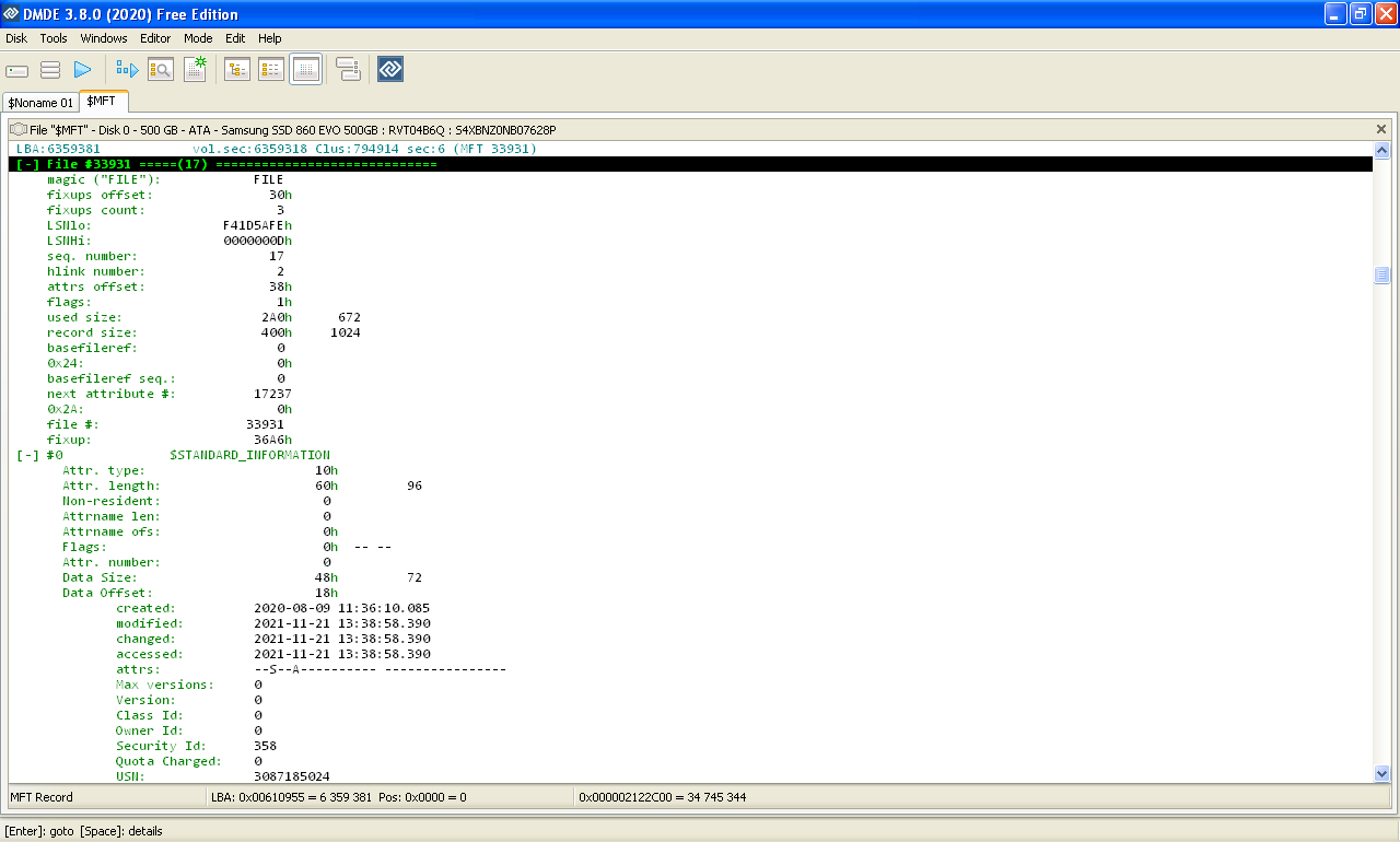

If you expand the $FILE_NAME attribute, you will see a directory parameter under "Data Offset". That is the file number (33945 decimal) of the preceding folder/directory.
As before, select Editor -> File Record, type the file number (33945) into the decimal box, and then OK. You will now see the MFT record for the preceding folder. Repeat this procedure to walk up the tree until you arrive at the root.
