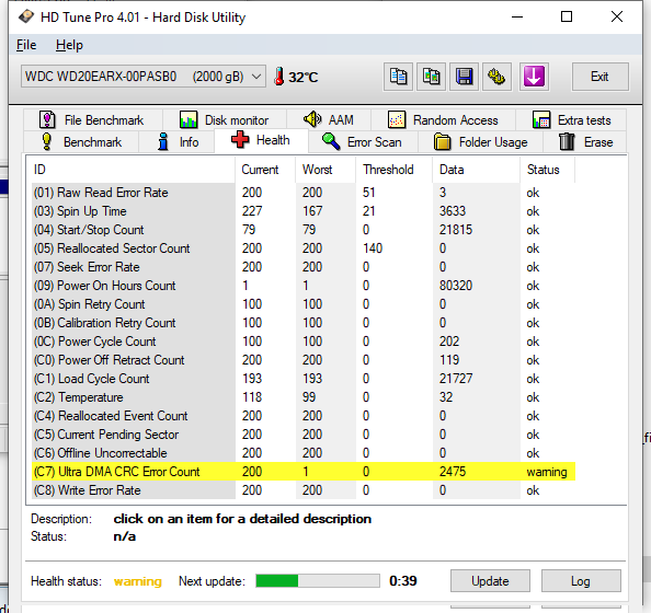

How about HDTunePro?
The UDMA errors, as I understand them, are a result of intermittent data connections. The data has changed to 7012 since 3 days ago.
The sector size is being shown as 4096 bytes. That should be the BLOCK size, shouldn't it? Everything else I have shows 512 bytes.
How do I get it back to 512?

 Post subject: Re: all sectors on drive are errored
PostPosted: October 28th, 2021, 15:24
Posts: 17341
That drive is an Advanced Format model. It has a logical sector size of 512 bytes and a physical sector size of 4096 bytes.
There should be an OPT1 jumper which may limit the SATA transfer rate to 1.5Gbps (if this feature is configured in the firmware). Otherwise there was a WD supplied tool (wdsspeed.exe) which could do this.
