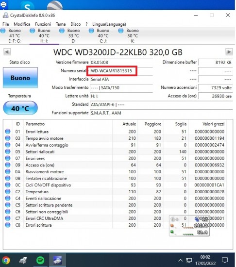

HI all
All works after u12 swap.
no bad sounds/other. :mrgreen: :mrgreen: 8) :druunk: :agree:
All data/files are present.
thank you all

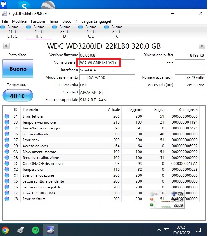

hdd status :!:
 Post subject: Re: Simply change pcb between two WD3200JD-22klb0?
PostPosted: May 17th, 2022, 3:41
Posts: 1323
Please you were able to sort it. It's a good idea now to plan a good backup policy so you won't need to worry about recovery the next time.
