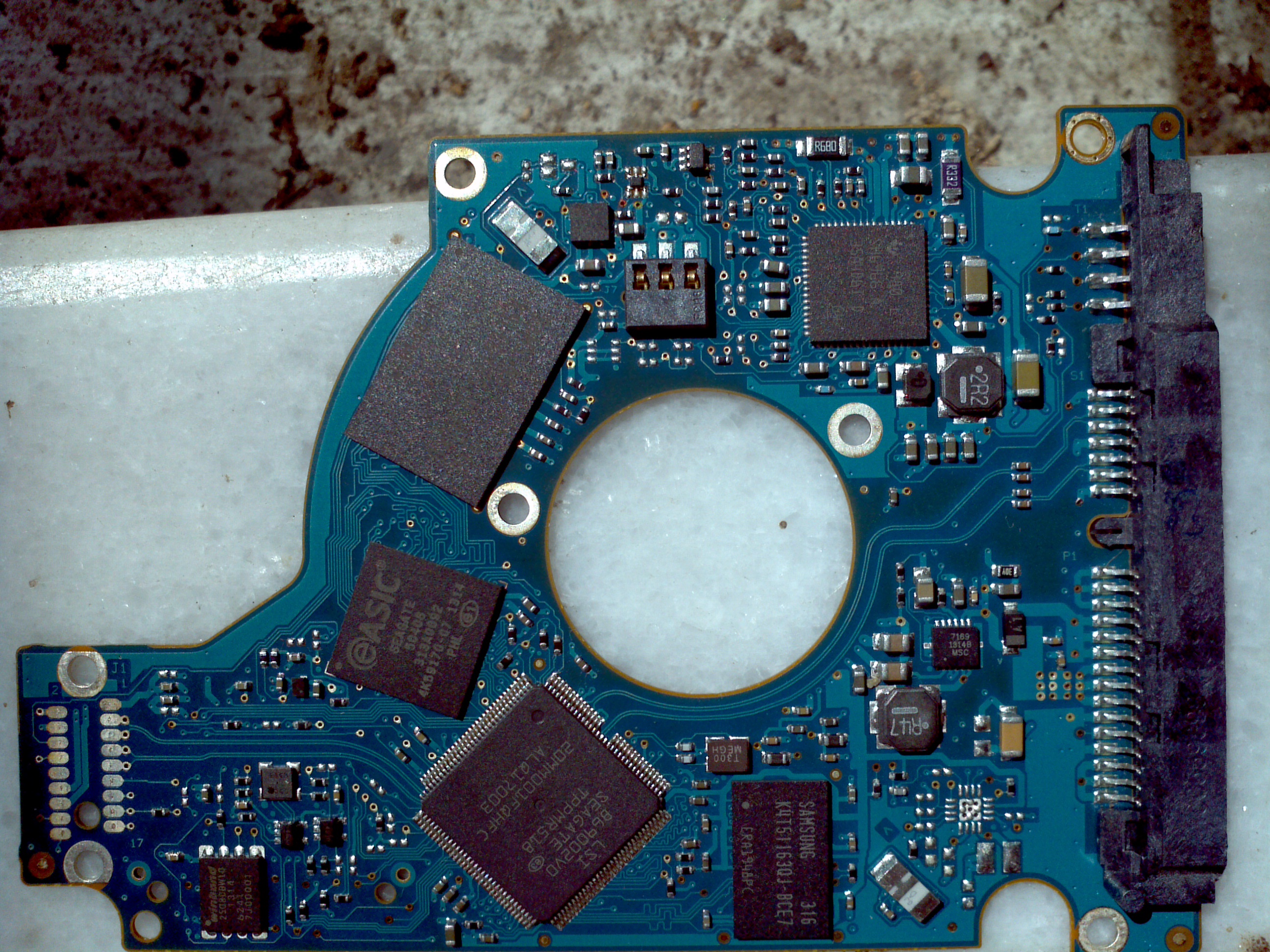

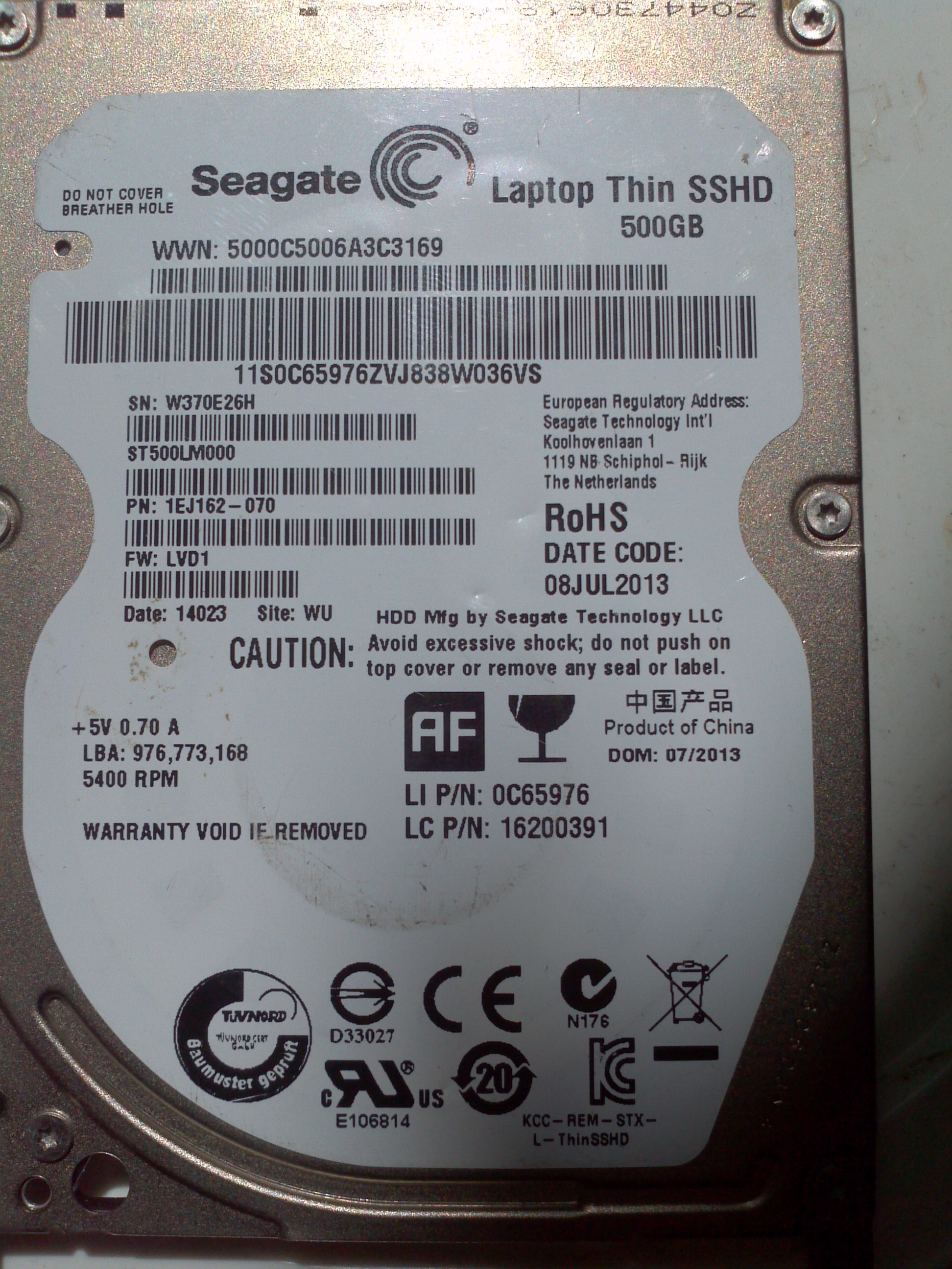

Hdd is dead. No action.. no spin ..no sound.
this is pcb fault. but which part is ?
there is no visible fault.

I can only recognise one diode. Which one(s) did you find?
I would also test the regulators. I can see at least 3, possibly 4 or 5.
Sorry. there is only one diode.
i have measured diode 2 monhts before...Which is regulator?

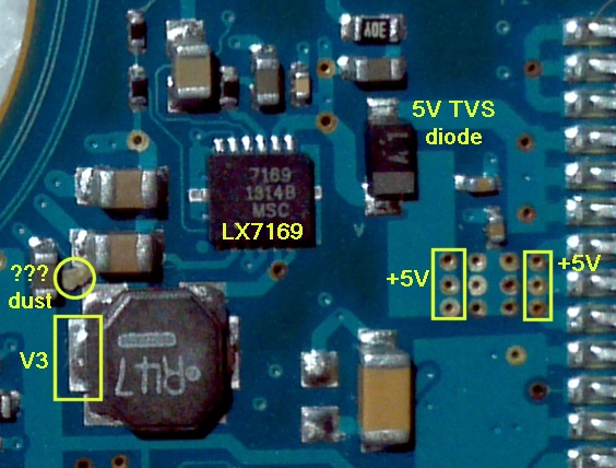

Just for the reference of others who may be troubleshooting an actual PCB fault, here is my guess as to the voltage test points:

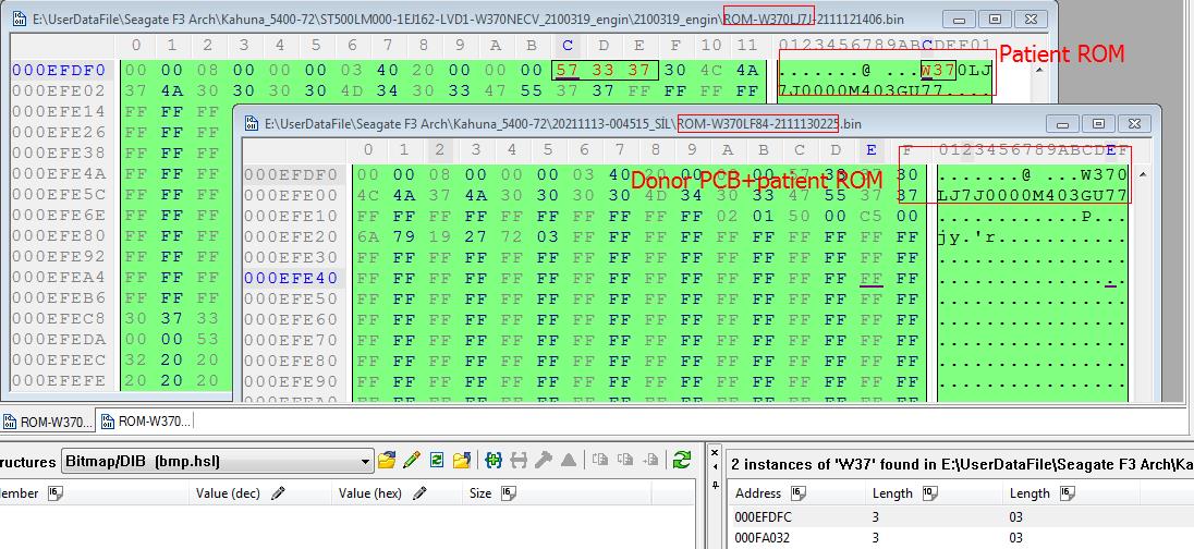

Posts: 489
Location: Usa
I have tried with 3th donor that a working drive.
F3 T>/O
F3 O>I
ALF Parametric Tables Preserved
HighPowerMode Status 0001 Req 0002
Flash was erased and ALF Tables have successfully been initialized
F3 O>
And writed patient Rom.
same . patients SN. and drive cannot initialize
transfered ROM chip phisically
Same.
Could it be head isue?
No unusual sound .
logs attached
Donor >>model:ST500LM000-1EJ162 firmware version:LVD1 serial number:W370LF84
Patient model:ST500LM000-1EJ162 firmware version:LVD1 serial number:W370LJ7J
roms.rar [1.22 MiB]
Downloaded 834 times
Report.rar [2.68 KiB]
Downloaded 790 times

oops.
Donor drive working with patient ROM now. Full access
Sexy Womans from your town
 Post subject: Re: ST500LM000 PCB Dead
PostPosted: November 12th, 2021, 19:52
Posts: 17314
Does that mean that all the donor's adaptives (CAP, RAP, SAP) are backed up in NAND? Does it also mean that a bad ROM can simply be substituted by any donor ROM?
Now that the donor drive is working with the patient's ROM, is there any way to force the adaptives in the donor's NAND to be refreshed from the patient's ROM? If you use PC3K/MRT to rewrite the ROM adaptives, will the drive's firmware transparently update the NAND as well?
PostPosted: November 12th, 2021, 21:38
Posts: 489
Location: Usa
:mrgreen: :mrgreen: Tried same version 3 another different Rom.
All of them working. Accessing to drive and data. lol.
Strange discovery. :mrgreen: :mrgreen:
But I cannot accessed customers data yet. :x :x
I am using MRT. ROM remainig same after try modify adaptives. can anyone make it manually for me .
